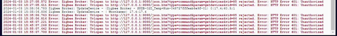

Even though the Zigbee additions seem to work correctly, I get the following error messages in my Domoticz Log:
(See attachment)

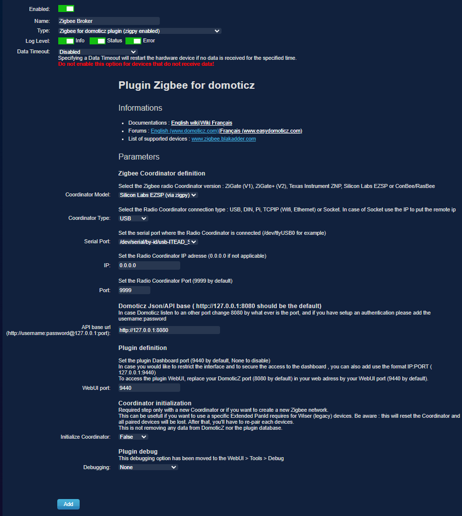

The "Zigbee Broker" is my Zigbee4Domoticz Hardware. (See image attached image for configuration).
The 86 and 85 device ids seem to refer to the device ids of the Temperature sensor of the SNZB-02D, and the Temperature + Hum sensor.
As can be seen, these errors re-occur every 5 minutes. As the error suggests it is probably an authorization issue, but I don't really know what is unauthorized and/or which credentials are missing. Does anyone has an idea what is wrong? Thanks in advance!

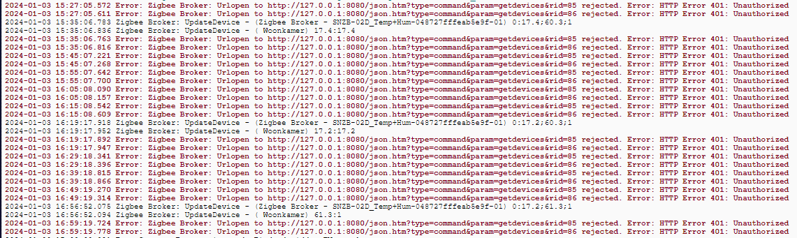

It also seems that the intervals in which the temperature and humidity update are pretty weird. Maybe that has something to do with it? (See image for lager error log)

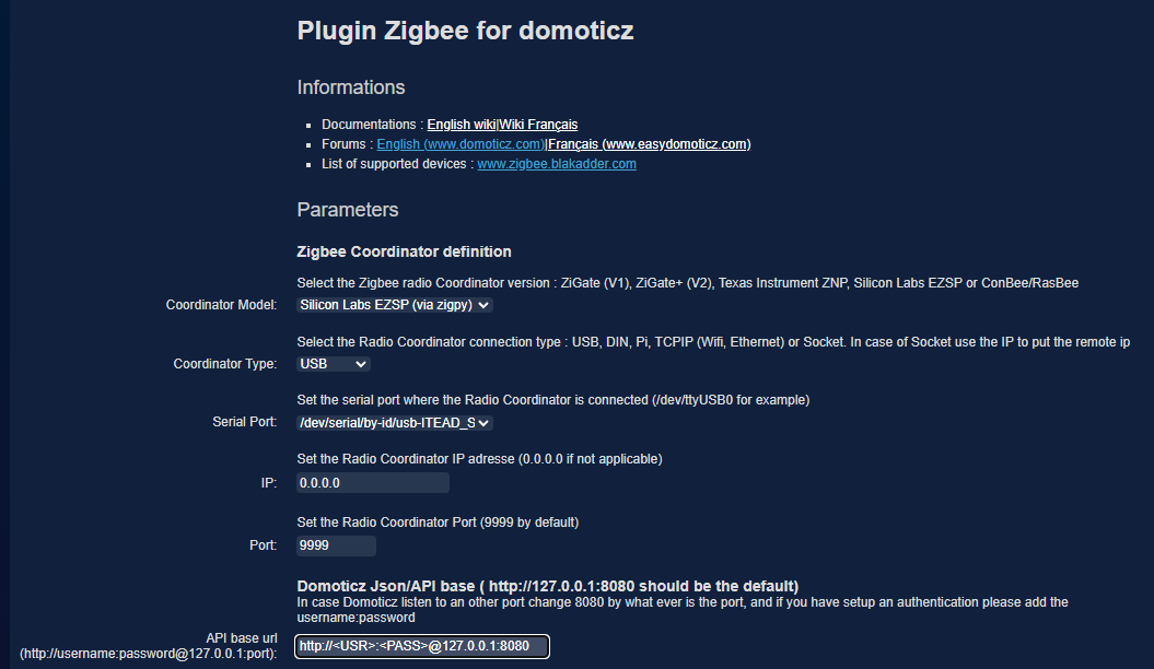

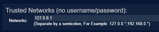

My first try to fix it was to add the localhost ip to the "Settings > Security > Trusted Networks" setting, since I thought maybe my domoticz install doesn't allow API calls from this ip. (See attachments).
This however did not fix the whole issue, and the errors still persisted. After this, I changed the configuration of my Zigbee2Domoticz hardware entity to specifically include the domoticz username and password. I first tested it using the curl command to make sure that the url was in the right form, and that the response was what I expected. After this I changed the configuration accordingly (see attachments, and note <USR> and <PASS> need to be changed to the username and password of your domoticz user).
After this the authentication errors are no more!
