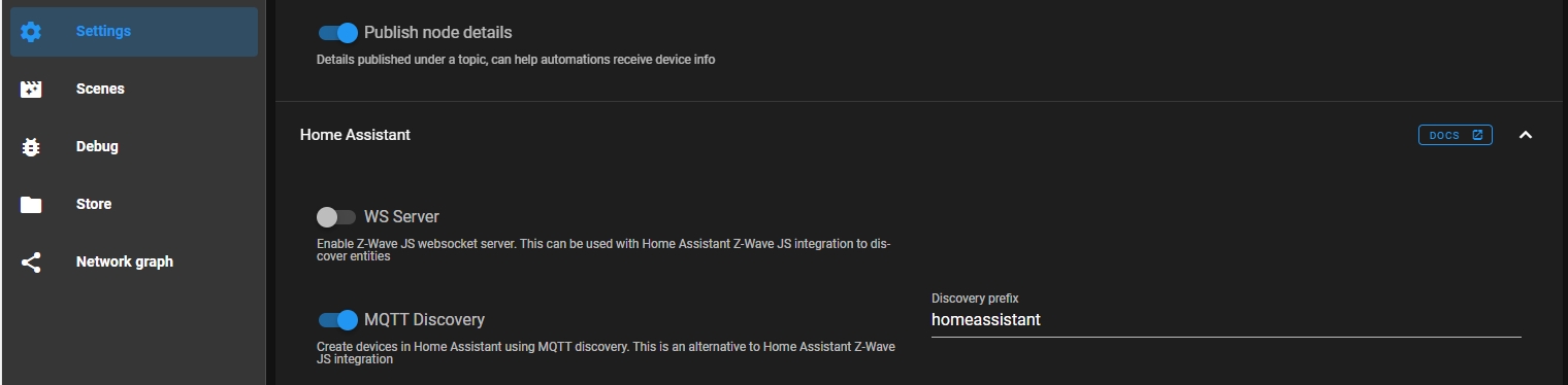

Re: Get ZWave devices visible in Domoticz (Zwave JS UI / MQTT)
I think In Z-Wave JS UI within settings in Section Home Assistant you find MQTT Discovery. Here is a default setting Discovery setting: homeassistanttlfriend1 wrote: Wednesday 12 June 2024 9:29Can you please explain this in more detail? I am not sure what you mean and I have this issue.solarboy wrote: Thursday 04 January 2024 17:07 You need to make sure that you have the Auto Discovery prefix the same in Domoticz ( in "MQTT Auto Discovery Client Gateway with LAN interface" settings under "Auto discovery prefix") and also in Zwave-JS-UI under Settings>Home Assistant.Discovery prefix. People generally put "homeassistant" as this discovery topic.
My devices are all visible in the z-wave js ui but not on the Domoticz ui
This is the same as in Domoticz within Hardware the default setting for Auto Discovery Prefix: homeassistant
I have the same settings. And in Z-Wave JS UI I see my devices, but they do not show in Devices within Domoticz. As if Domoticz does not communicate with the mosquitto broker. I can not find what I have done wrong, as everything seems to work, but not together.
Any suggestions are welcome.

solarboy
- Posts: 369
- Joined: Thursday 01 November 2018 19:47
- Domoticz version: 2026.4
- Location: Portugal
"Remote Address" needs to be the same as the IP of mosquito, and if either domoticz or zwavejsui are in dockers there are more things to confirm. If nothing is in a docker and mosquitto is on the same device you can put "localhost" there.

donverweij
- Posts: 8
- Joined: Tuesday 06 February 2024 18:00
- Domoticz version: 2024.4
Thanks for all your suggestions. I checked the suggestions.solarboy wrote: Thursday 21 November 2024 22:55 "Remote Address" needs to be the same as the IP of mosquito, and if either domoticz or zwavejsui are in dockers there are more things to confirm. If nothing is in a docker and mosquitto is on the same device you can put "localhost" there.
I have Docker Engine and Compose running om my Raspberry Pi 4B.
I gave my Pi a fixed ip address within my network: eg 192.168.10.112
I installed Domoticz 2024.7 in Docker. Domoticz runs without a problem on this fixed ip address 192.168.10.112:8080.
I then installed the mosquitto broker in Docker. Mosquitto has the same ip address 192.168.10.112:1883.
I then installed ZWave-JS-UI client in Docker. ZWave-JS-IU is running on the same fixed ip address 192.168.10.112:8091. ZWave-JS-IU is connected with the mosquitto broker on ip adress 192.168.10.112:1883.
I also installed MQTT-explorer in Docker. MQTT-explorer is running 192.168.10.112:4000. Through MQTT-explorer I can connect with the mosquitto broker on 192.168.10.112:1883.
In the ZWave-JS-IU I see the Devices I included.
In MQTT-explorer I can connect to the mosquitto broker with the right user name and password. These are the same I provided in Domoticz for Hardware MQTT Auto Discovery Client Gateway with LAN. So no authorization issue I would say.
In Domoticz I reinstalled MQTT Auto Discovery Client Gateway with LAN. With Remote Address: 192.168.10.112 and Port: 1883
Still no devices to be shown in Domoticz.

Thanks,solarboy wrote: Saturday 23 November 2024 20:14 If you already have your devices in zwaveJSUI then your USB device must be correctly set.
When you connect with MQTT explorer, can you see you devices populated there ? If not make sure the mosquitto docker container has port 1883 (and 9001) mapped with the lineIf so then it must be the connection between Domoticz and mosquitto. Double check your Discovery topic is the same in ZwaveJSUI and in Domoticz. I don't run Domoticz in a docker but you need to make sure it has access to port 1883, probably by altering the docker-compose.yml file for Domoticz and addingCode: Select all
ports: - 1883:1883 - 9001:9001Code: Select all
ports: - "1883:1883"
I have the following mosquitto docker-compose.yaml in which both ports 1883 and 9001 are registered

solarboy
- Posts: 369
When you connect to mosquitto with Mqtt explorer, can you see your devices there ?
No they do not. I'm am connected to the mosquitto broker, but I do not see any devices.solarboy wrote: Sunday 24 November 2024 11:58 When you connect to mosquitto with Mqtt explorer, can you see your devices there ?

solarboy
- Posts: 369
So I would check that you have the correct port, name and username for mosquitto in zwavejsUI and that you have made those ports available to both docker containers. I use "host.docker.internal" as the host url in zwavejsUI and the prefix "zwave" (not the discovery topic) so all my devices appear under the subheading "zwave" when I view mosquitto with MQTT Explorer. I don't use any authorisation so I have "auth" turned off. Perhaps you could try running your mosquitto without requiring authentication until you resolve the problem.
