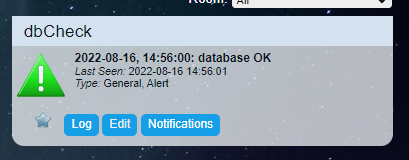

Re: Domoticz database check script
Question
My idx 'dbCheck' is not updating!
Data = "Hello World"
However:
My IDX dbCheck:
An idea ?
However:
active = true, -- set to false if you don't want an Alert device set.
device = "dbCheck", -- Name of your alert device (only needed when you set active = true )
failText = "Problem in database",
OKText = "database OK", Code: Select all
Log file:
2022-08-16 14:47:00.652 Status: dzVents: Info: DB check: ------ Start external script: DBcheck.lua:, trigger: "at 14:47"
2022-08-16 14:47:00.752 Status: dzVents: Debug: DB check: Command select count(id) from deviceStatus; result ==>> OK
2022-08-16 14:47:00.858 Status: dzVents: Debug: DB check: Command .schema result ==>> OK
2022-08-16 14:47:01.258 Status: dzVents: Debug: DB check: Command pragma integrity_check; result ==>> OK
2022-08-16 14:47:01.358 Status: dzVents: Debug: DB check: Command pragma foreign_key_check; result ==>> OK
2022-08-16 14:47:01.391 Status: dzVents: Debug: DB check: Processing device-adapter for dbCheck: Text device
2022-08-16 14:47:01.392 Error: dzVents: Error: (3.1.8) DB check: Method updateAlertSensor is not available for device "dbCheck" (deviceType=General, deviceSubType=Text). If you believe this is not correct, please report.
2022-08-16 14:47:01.392 Status: dzVents: Info: DB check: ------ Finished DBcheck.luaRaspberryPi - RFLink - Zwave - WH2600
I found the reason : You created device "dbCheckResult" as a type text device and it should be a type alert devicewaaren wrote: Wednesday 27 January 2021 11:47You created device "dbCheckResult" as a type text device and it should be a type alert devicebertbigb wrote: Wednesday 27 January 2021 11:45 I have installed this script but it reports the following error.Code: Select all
2021-01-27 11:10:01.487 Error: dzVents: Error: (3.0.2) DB check: Method updateAlertSensor is not available for device "dbCheckResult" (deviceType=General, deviceSubType=Text). If you believe this is not correct, please report.
