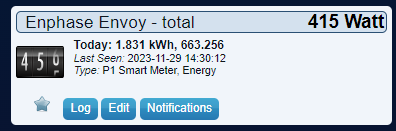

This is with the Enphase Plugin from H4nsie Enphase Envoy Plugin:

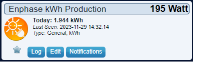

This is with the Default Domoticz Enphase hardware:

So I understand there is no easy fix because the external plugin uses subtype "P1" and the internal hardware uses "General kWh", so the "Replace" function can't be used.
