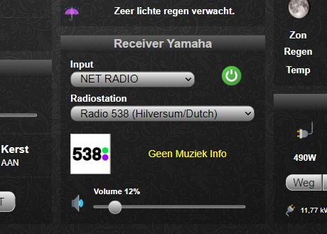

One question. Is it also possible, for example, to greyed out the underlying col-data of a block? See picture below:
Thank for your great effort.

Everything is possiblemichelscholte wrote: ↑Saturday 30 December 2023 19:22 Thanks a lot. I tried it and it works great. I have some work to do.
However, I don't understand your question.
'Zender' is a selector switch I guess. Can you post the block definition?
You want to have it greyed out? It look greyed out already... (The selection box with 'Selecteer' inside)

"Zender" is a selector switch indeed. I want to greyed out it (opacity: 0.4) if the "Input" switch is not TV (in the screendump, for example "Netflix" is selected).
I don't want to greyed out (opacity: 0.4) the block itself, but only col-data.
What you see is exactly what I want but I have to reconfigure it, to reduce the afterGetDevices function.

Several ways ...
I would adapt the deviceHook function:
and in custom.css:
function deviceHook(device) {
if (device.idx == 2628 || device.idx == 2630) setTVStatus(device);
//start of change
if (device.idx == 2630)
if (device.Level == 0) //check your device idx and device level for TV
Domoticz.setBlock('tv_woonkamer_selectie_zender', {addClass: ''}); //normal input selection
else Domoticz.setBlock('tv_woonkamer_selectie_zender', {addClass: 'datagrayedout'}); //input selection should be grayed
//end of change
.datagrayedout .col-data {
opacity: 0.4;
