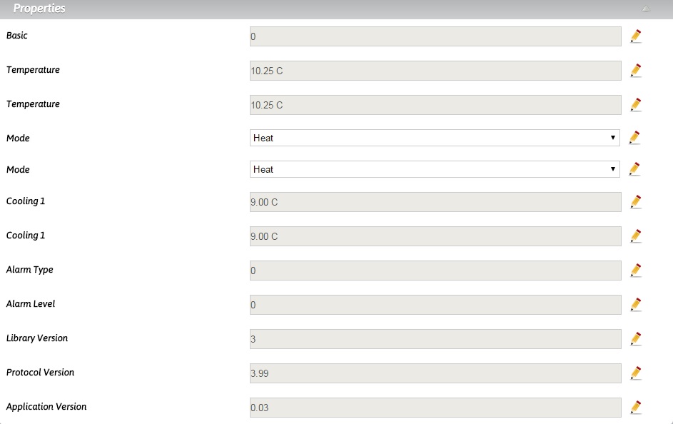

(In OpenRemote I created a slider and can change the temperature setting SP). And here I can not yet.
How can I control the thermostat from the application Domoticz?
On the thermostat, technical information is available only in Russian.

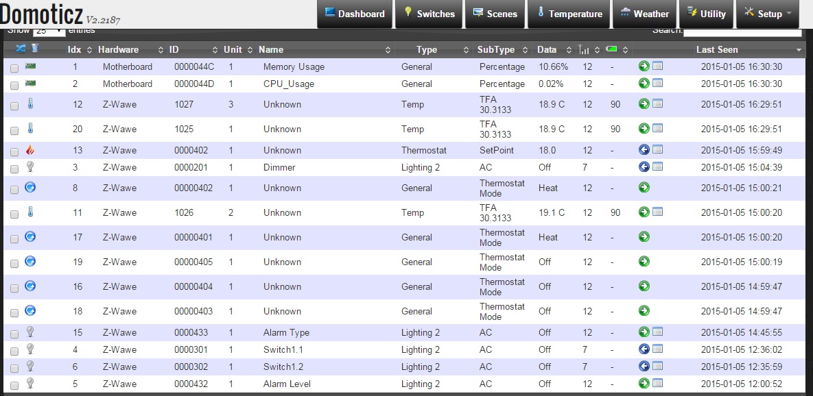

In Devices: (screen)

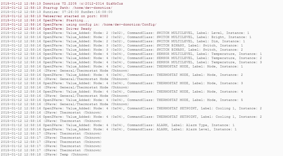

In Log:
2015-01-05 14:59:44 Domoticz V2.2187 (c)2012-2014 GizMoCuz
2015-01-05 14:59:44 Startup Path: /home/dev-domoticz/
2015-01-05 14:59:44 Sunrise: 07:29:00 SunSet:15:59:00
2015-01-05 14:59:44 Webserver started on port: 8080
2015-01-05 14:59:46 OpenZWave: Starting...
2015-01-05 14:59:46 OpenZWave: using config in: /home/dev-domoticz/Config/
2015-01-05 14:59:47 OpenZWave: Driver Ready
2015-01-05 14:59:47 OpenZWave: Value_Added: Node: 2 (0x02), CommandClass: SWITCH MULTILEVEL, Label: Level, Instance: 1
2015-01-05 14:59:47 OpenZWave: Value_Added: Node: 2 (0x02), CommandClass: SWITCH MULTILEVEL, Label: Bright, Instance: 1
2015-01-05 14:59:47 OpenZWave: Value_Added: Node: 2 (0x02), CommandClass: SWITCH MULTILEVEL, Label: Dim, Instance: 1
2015-01-05 14:59:47 OpenZWave: Value_Added: Node: 3 (0x03), CommandClass: SWITCH BINARY, Label: Switch, Instance: 1
2015-01-05 14:59:47 OpenZWave: Value_Added: Node: 3 (0x03), CommandClass: SWITCH BINARY, Label: Switch, Instance: 2
2015-01-05 14:59:47 OpenZWave: Value_Added: Node: 4 (0x04), CommandClass: SENSOR MULTILEVEL, Label: Temperature, Instance: 1
2015-01-05 14:59:47 OpenZWave: Value_Added: Node: 4 (0x04), CommandClass: SENSOR MULTILEVEL, Label: Temperature, Instance: 2
2015-01-05 14:59:47 OpenZWave: Value_Added: Node: 4 (0x04), CommandClass: SENSOR MULTILEVEL, Label: Temperature, Instance: 3
2015-01-05 14:59:47 OpenZWave: Value_Added: Node: 4 (0x04), CommandClass: THERMOSTAT MODE, Label: Mode, Instance: 1
2015-01-05 14:59:47 (Z-Wawe) General/Thermostat Mode (Unknown)
2015-01-05 14:59:47 OpenZWave: Value_Added: Node: 4 (0x04), CommandClass: THERMOSTAT MODE, Label: Mode, Instance: 2
2015-01-05 14:59:47 OpenZWave: Value_Added: Node: 4 (0x04), CommandClass: THERMOSTAT MODE, Label: Mode, Instance: 3
2015-01-05 14:59:47 OpenZWave: Value_Added: Node: 4 (0x04), CommandClass: THERMOSTAT MODE, Label: Mode, Instance: 4
2015-01-05 14:59:47 OpenZWave: Value_Added: Node: 4 (0x04), CommandClass: THERMOSTAT SETPOINT, Label: Cooling 1, Instance: 2
2015-01-05 14:59:47 (Z-Wawe) Thermostat (Unknown)
2015-01-05 14:59:47 OpenZWave: Value_Added: Node: 4 (0x04), CommandClass: ALARM, Label: Alarm Type, Instance: 1
2015-01-05 14:59:47 OpenZWave: Value_Added: Node: 4 (0x04), CommandClass: ALARM, Label: Alarm Level, Instance: 1

This thermostat is a complex unit with different "devices" inside.
In Domoticz (as far as I know) it is not integrated, so handling could be only using different devices - by type.
Setpoint can be modified changing the value or using the timer.
I haven't found an XML for the device - can you see any parameters if you select the node at hardware?
(most parameters seems to work by default - have checked documentation)
Is the device working / responding if you change the setpoint?

micha_pr wrote:This thermostat is a complex unit with different "devices" inside.
Thank you for your answer, I'm sorry for my english.
Yes.
In app OpenRemote (in the screenshot above), I can the slider change temperature on / off thermostat, see the value of the set temperature (12 degrees in the screenshot above). But I can not see the real value of the temperature (thermostat with temperature sensor).
Last edited by tehnoinstyle on Friday 09 January 2015 11:19, edited 1 time in total.

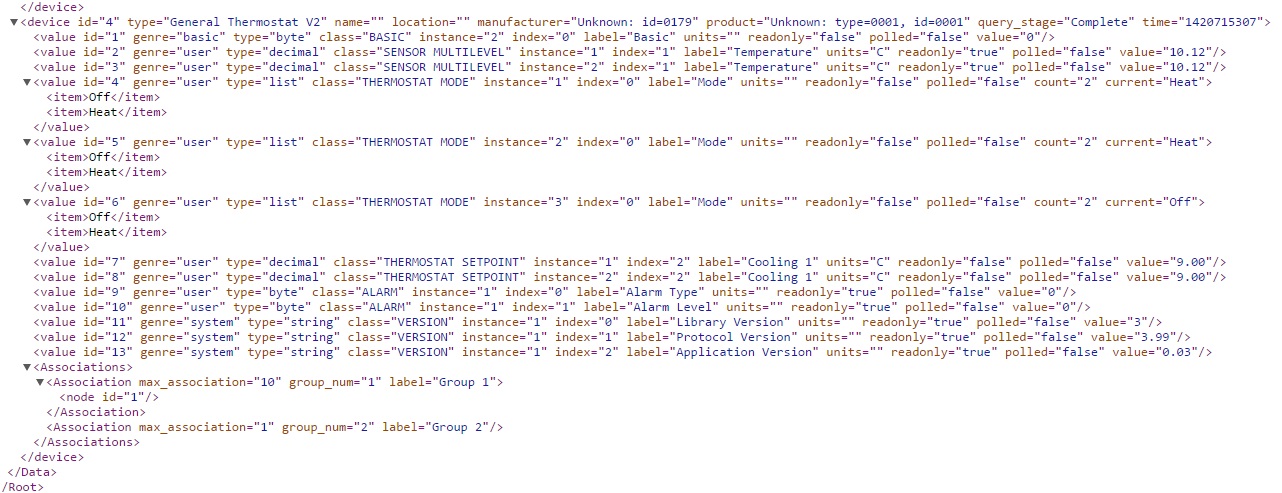

micha_pr wrote: I haven't found an XML for the device - can you see any parameters if you select the node at hardware?

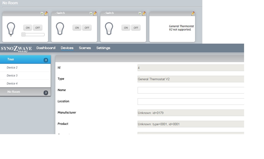

In app SynoZWave similar to Domoticz, but also do not understand:
(the temperature of 9 degrees - my temperature change, 10,25 degrees - real temp, from thermostat temp sensor)

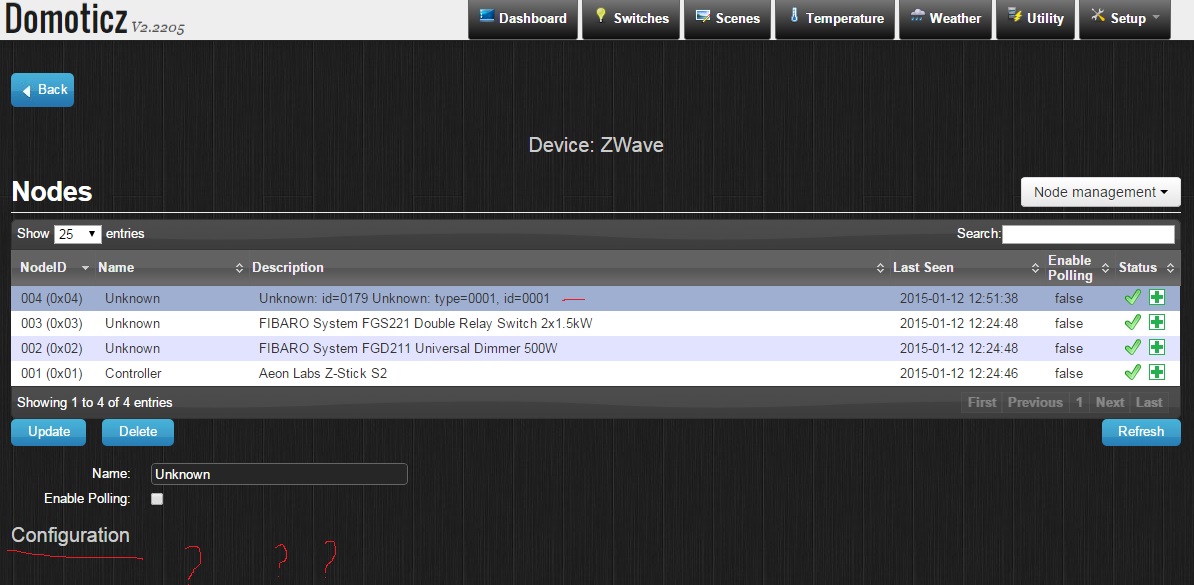

And Domoticz not see in the settings of any properties of the thermostat (as opposed to Dimmer Switch and Fibaro).

tehnoinstyle wrote:And Domoticz not see in the settings of any properties of the thermostat (as opposed to Dimmer Switch and Fibaro).
This is because of missing XML.
I think it must be created by someone (best to have this device for testing...) Is it available only in UA?

micha_pr wrote: This is because of missing XML.
Yes, they are here and produced. I bought at the above site.
Write that 100% compatible with controllers: Fibaro, Vera, etc.

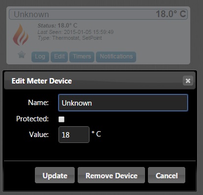

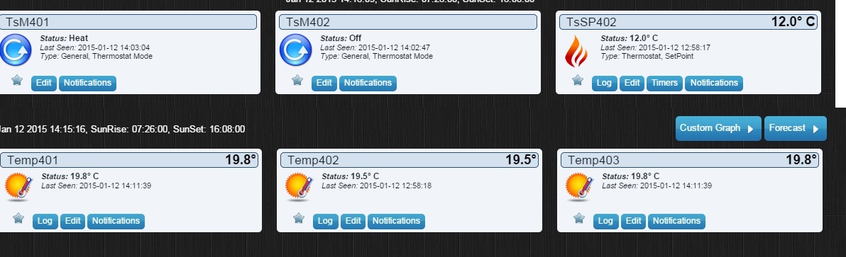

micha_pr wrote:I mean - is it working in Domoticz? If you change Setpoint - something happen?
No. The thermostat does not react (tried, screenshot at the beginning of the topic).
micha_pr wrote:Other devices from Thermostat you should add from devices tab (like temperature etc.)
Tried. Adds temperature (idx20). Appears temperature sensor with the current temperature value, from thermostat temp sensor.
But them several in the table. I do not understand what i need to add ?.
Can I implement this:
1. thermostat Heat / Off (in SynoZW, settings, Mode - if i select Off, the thermostat is turned off, if Heat - on).
2. The temperature setting of the thermostat (and see this value, how in OpenRemote)
3. The value of the current temperature from the temperature sensor thermostat. (It works).

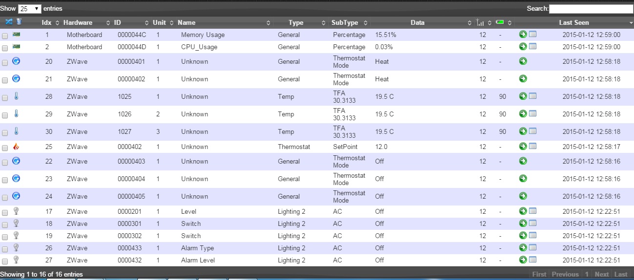

I Added device thermostat, but remained not added by. I do not know what to do: add, or not?. What to do, please tell me.

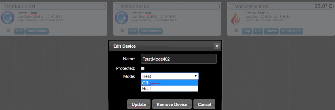

I can turn on or off the thermostat using Off / Heat:
How to use it, and how to set the temperature on / off?

Hello.
Happy New Year.
Please tell me, in the latest versions Domoticz an opportunity to fully control the thermostat? Set point in temperature, on / off thermostat, thermostat control relay status (when the heating element on / off)?
There is a XML file for thermostat -> node4 (created in the Open Remote application):
