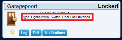

All,
I hope this information can also help others.
Because I had issues with adding DZGA to Google Home with this error: "can't reach the project ([test] Domoticz Google Assistant)" I have contacted Google and asked to investigate this issue, and so they did.
One of the main reasons for this error is because Google expects specific "traits" for each device type.
Device types and traits which can be handled by Google can be found here:
https://developers.home.google.com/clou ... ud/guides/
In my case I use Door Contacts (Inverted) in Domoticz which are stated as device type "Light".
Google expects for device type light the trait "OnOff" but Domoticz reports back "Unlocked" or "Locked" and this creates a mismatch.
When adding the service in Google Home "[test] projectname" Google makes a devicesync and checks if device types and traits are correct.
Unfortunatly you don't get back the mismatches to troubleshoot and Google Home gives the error: "can't reach the project ([test] Domoticz Google Assistant)".
Google support gives me this link https://developers.home.google.com/tool ... ator?hl=en which can be used to validate the devicetypes and traits.
This issue is also mentioned by @meal in this post: "by meal » Friday 26 January 2024 1:51".
Could this be an enhancement in Domoticz? Change devicetype from "light/switch" to "Lock"

Hi Kedi,
I did that, but in Domoticz this device has Device Type "Light/Switch" and Subtype "Switch" with data"Locked" (at this moment).
meal

Dewgew has updated DZGA.
DoorLockInverted wasn't modeled in DZGA-Flask and is now added.
Though in Domoticz:
Doorlock type Domoticz.png (11.06 KiB) Viewed 3185 times
Google knows 2 types:
Door https://developers.home.google.com/clou ... uides/door
Lock https://developers.home.google.com/clou ... uides/lock
In Domoticz it is of type "Light/Switch", teached based on auto MQTT for Shelly device since I use a Shelly1 to report state and open/close garagedoor.
So there is the mismatch.
