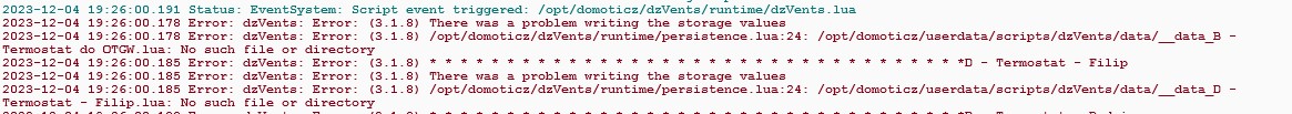

waltervl wrote: Thursday 09 March 2023 15:34 Are you using docker? As that also needs sometimes special considerations on folders.
I'm getting the same error and I'm using docker version (installed the way from here: https://github.com/domoticz/domoticz-docker)
In docker there where no /opt/domoticz/dzVents/rest_of_the_files_and_folder / where also there should be the missing persistance.lua.
I created those by hand, as well as the missing /opt/domoticz/userdata/scripts/dzVents/data/__nameofthescript.lua but the error still pops up.
How to fix this ?
I suppose there are missing paths in the docker-compose.yml file to get the dzVents storage function to work, yes ?
Mine looks like this:
