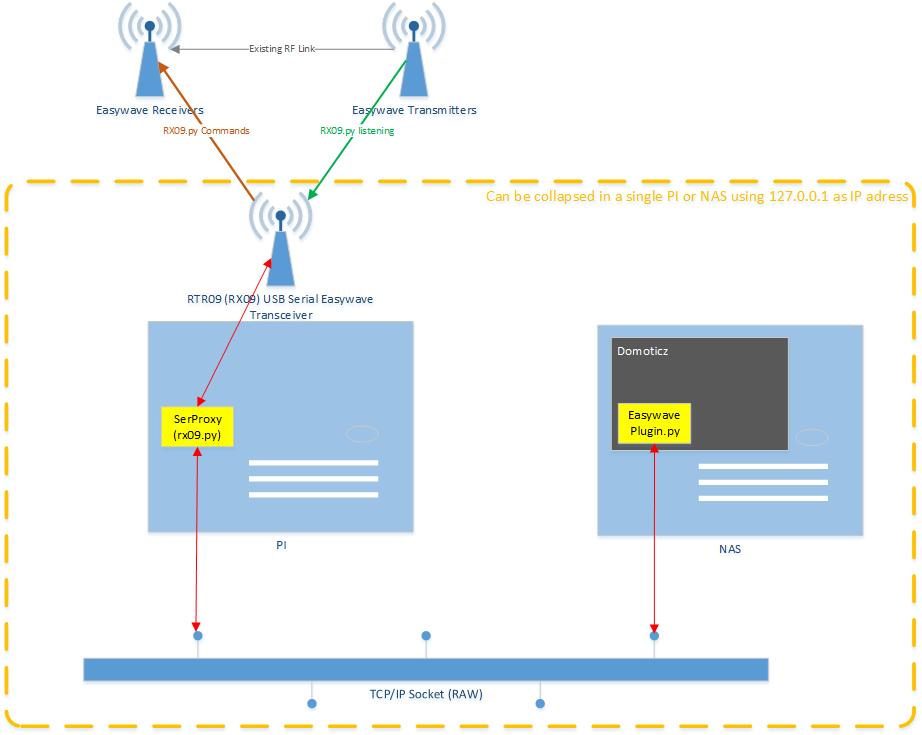

This drawing summarizes the interaction between Easywave Devices (Recievers & Transmitters) the RX09.py and the Domoticz plugin
regards
