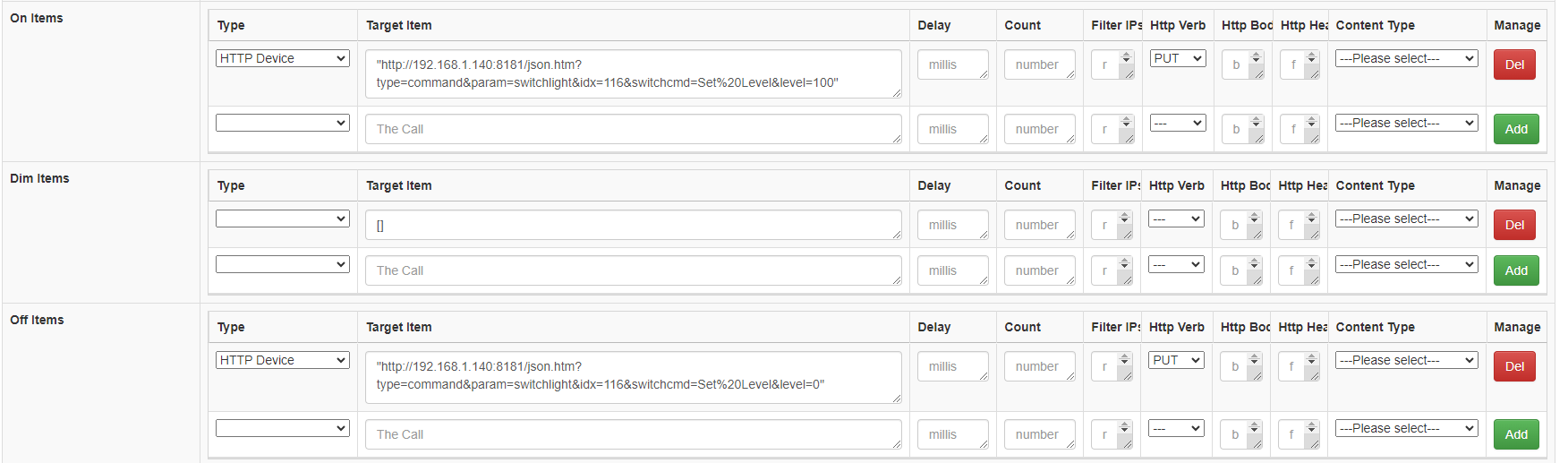

I've also been fighting this beast since i upgraded to the latest version of Domoticz 2024.7 and had to completely redo my system of Zwave devices to move to the new Z-Wave JS UI and MQTT broker configuration. Boy, was that fun.......NOT !!!
Anyhow, i'm mostly back up and running and my last hurdle was to get HA-Bridge up and running under the new configuration. Through much trial and error, i was able to get it to mostly work. The auto discover of Domoticz devices is broken, as noted by someone else. The old JSON calls need to be fixed in HA-Bridge, but i don't know how to do that.
So, instead, i manually added the few lights that i wanted into HA-Bridge. See my screen capture below. I can't seem to get the dimming function to work, but at least i can now tell Alexa to turn my lights on or off again. YAY !!!!!
Also, you'll need to set the "Unique ID to use 9 Octets (Renumber after saving this setting)" to true under the Bridge Control tab. Otherwise, i couldn't get Alexa to discover my lights.
Good luck !!!
