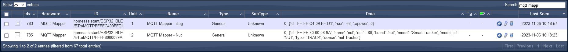

I'm trying to add an iTag tracker and Nut tracker, here is what I see in my used devices list.
Even though they say used I can't find them anywhere else.

It looks like these are not supported in Domoticz, subtype unknown sounds like a configuration error somewhere.
What do you expect these devices to show in Domoticz? A text device? An On/Off switch?
