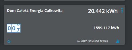

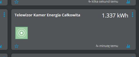

Daro1003
- Posts: 203
- Joined: Monday 14 November 2022 12:46
- Domoticz version: 2023.1
- Location: Poland
Re: Bar charts of energy consumption
Thank you.
I followed the instructions for the effect in the attached photo.
Looks like it worked. Is this how it's supposed to look in Domoticz?+
Thank you all for your help and for taking me seriously even though I am not a specialist and do not know programming.
I will insert charts from domoticz and Dashticz.
P.S What does the number zero in the right corner mean in my case? Below is the indication of total consumption.
In Dashticz, two separate bars are displayed for one block from Domoticz. This can be confusing.
Is it possible to somehow change the description of these blocks into two different descriptions?

Daro1003
- Posts: 203
- Location: Poland
Friend @joba1, can you split this block in domoticz into two separate ones? Because in dashticz two blocks are shown but their name and order cannot be changed, only both blocks are under the same name because in domoticz there is one block. This block shows the total energy and the energy of yesterday. In the previous version there were two separate blocks in domoticz energy yesterday and total energy.
Please update the plugin.

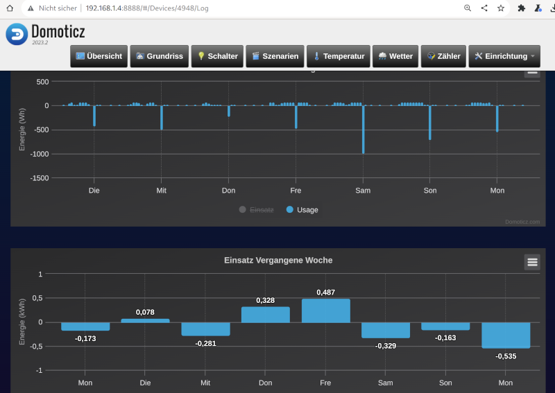

- joba1
- Posts: 19
- Joined: Saturday 03 March 2018 16:39
- Domoticz version: V2024.7
- Location: DE
Tasmoticz only creates domoticz devices. How it is displayed is up to domoticz. If you know a device type / subtype that works better, I can use that.
I have not yet merged the pull request with the changed energy meter type because I see strange reports. Not sure what to do about it:
I see positive and negative energy consumption bars in the 7 days hourly diagram (one big negative each day at 0:00, then all positive).
The daily total in the weekly/monthly/year overviews then sometimes is negative and sometimes positive. I do not produce power (and the used energy meter would report it positive anyways). So negative values are definitively wrong. Tasmota does not report them.
Any ideas where these come from - or how to get rid of them? The charts are nice, but only if correct...
- joba1
- Posts: 19
- Location: DE
Nevermind. This is the daily total value from tasmota. This and the yesterday total don't work as energy counter, since domoticz expects an ever increasing value, not one that counts from zero every day.
- Posts: 6683
- Domoticz version: 2025.1
Then tasmoticz should create an incremental counter device and send only the delta.joba1 wrote: Monday 15 January 2024 13:24 Nevermind. This is the daily total value from tasmota. This and the yesterday total don't work as energy counter, since domoticz expects an ever increasing value, not one that counts from zero every day.
- joba1
- Posts: 19
- Location: DE
I just undid the change for energy today and yesterday, back to "normal" custom counters in the pr.
The energy total looks very good - all values as expected, including calculated daily values.
Maybe someone else wants to test the PR before I commit (probably in a few days...)?
See waltervl's post from oct 17th for a howto...
