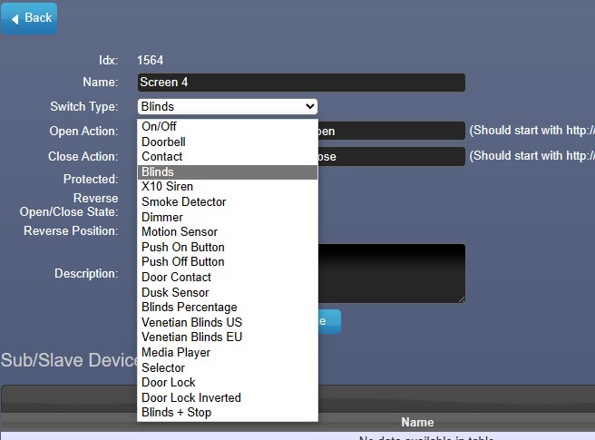

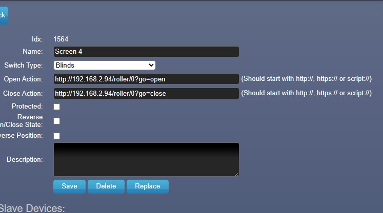

Simple solution:
Go hardware
Dummy - Create virtual sensors
Choose Switch
Once installed choose type blinds.
No need for dzvents (if I understand your question right)
After creating these switches automation is easy with dzVents.
