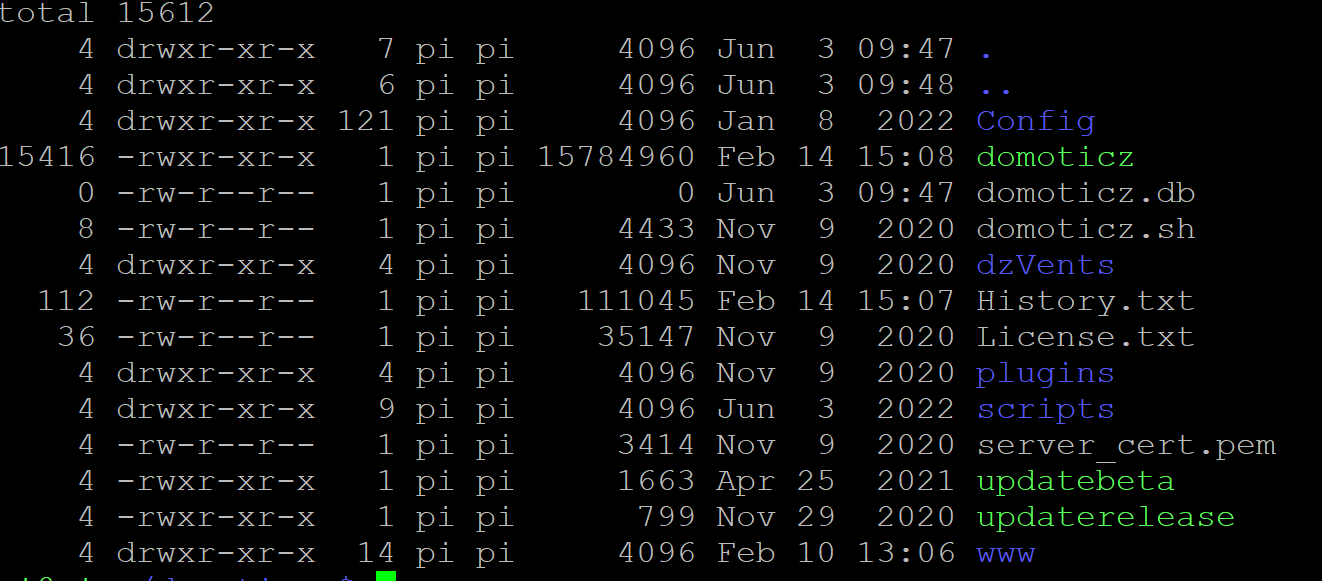

Do an ‘ls -las’ and check if the domoticz and domoticz.sh have the ‘x’ (eXecute) bit set. Without it, these file will not get executed.
jacobsentertainment
Posts: 223
Joined: Thursday 01 October 2020 1:47
Domoticz version: 2021-1
Location: Not @ home
Re: New installation not working
Post by jacobsentertainment »
kiddigital wrote: Saturday 03 June 2023 19:28 Do an ‘ls -las’ and check if the domoticz and domoticz.sh have the ‘x’ (eXecute) bit set. Without it, these file will not get executed.
Well this is a little above my pay grade ;)
kiddigital
Posts: 454
Post by kiddigital »
Looks fine.. domoticz is green (has rwx in front)
Must be something else.

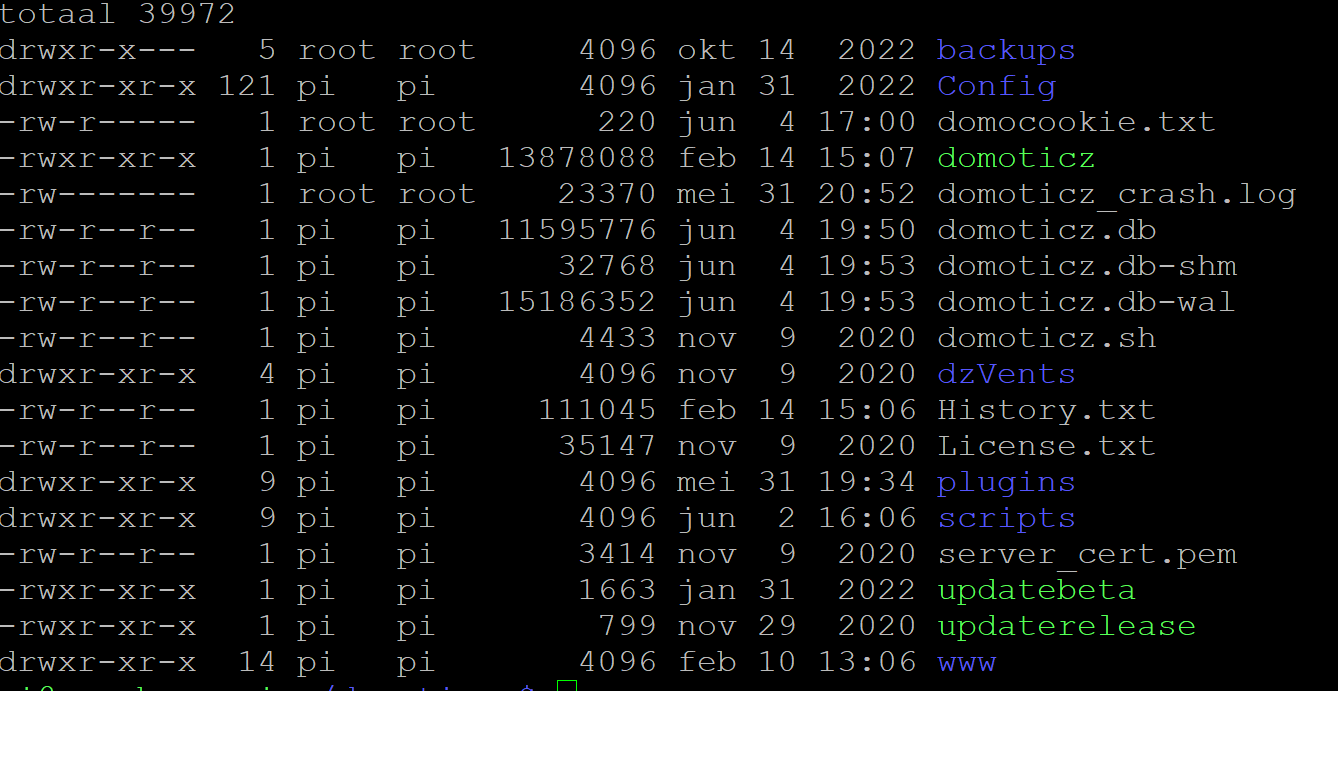

On my other pi I have domoticz (older installation) running and compared the permissions.
