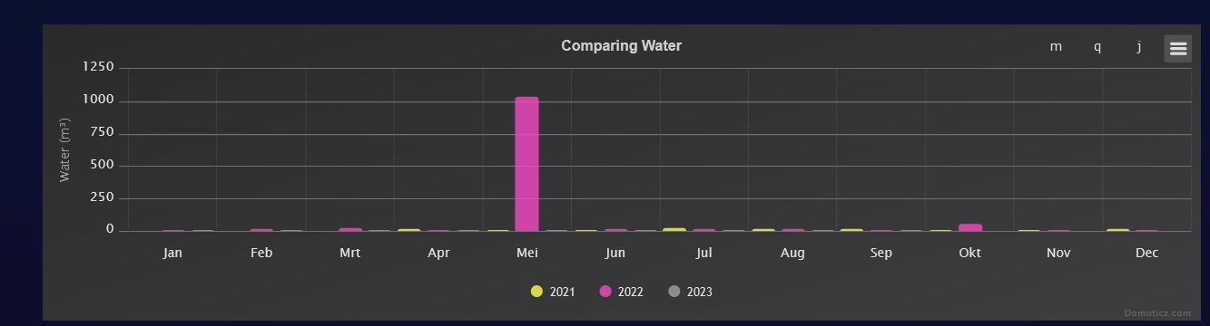

I already saw an incorrect registration in my "water meter" in May 2022. Could this also cause the or a crash?

Note the size of the database before and after. Garbage will be disposed of and it will shrink.
For adjusting or deleting this exceptional value it won't help.
Adjusting can be done by exporting your Meter_Calendar data to csv, manipulate and import again or by changing data using DB browser (SQLite)
