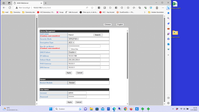

OK, I installed Fiddler and it gives me a long list of info, will have to look into that.
Meanwhile, I made a screenshot of the one and only screen that the inverter has for me. Not sure if that will help, though...
- Omnik screen.png (126.33 KiB) Viewed 2392 times

Re: Python Plugin: Omnik Inverter local webinterface
Looks like the standard interface indeed. Please look for a .js extension just click through the items one at a time.manjh wrote: Wednesday 06 September 2023 11:35 OK, I installed Fiddler and it gives me a long list of info, will have to look into that.
Wat helpss
Press the red cross in fiddler.
Open your browser and click straight on the overview of your inverter W / kwH.
The thing you are looking for will then be somewhere near the top. Saves you some time.
Or else send me the captured file and I can help you. (do not send login credentials)

I never found such a page on the local interface. Screenshot I sent is the only one, it can be used for technical setup only. And I donot see any links to other pages!sincze wrote: Wednesday 06 September 2023 11:42 Open your browser and click straight on the overview of your inverter W / kwH.
I also tried logging in directly to the AP of the inverter, no luck.
Found this manual:
https://geaskb.nl/wp-content/uploads/20 ... 2kW_TL.pdf

Sounds great, looking forward to testing. Thank you!sincze wrote: Wednesday 06 September 2023 18:41 I kniw that one. I use the php version of that script.
I can have a look to convert it into a Domiticz plugin.
It works only with inverters that have specific serial numbers.
Hans

manjh wrote: Wednesday 06 September 2023 14:33 looks more like the Solarman online interface...
Also interesting is the version number. Mine says it is Ver:4.01.9.d1!
- Most inverters have a JS file, try accessing http://<your omnik ip address>/js/status.js in your browser. (Not working for you)
- Some inverters use a JSON status file to output the values. Check if your inverter outputs JSON data by navigating to: http://<your omnik ip address>/status.json?CMD=inv_query.
- A few inverters don't have JS or JSON but output the values directly in a HTML files. Check if your inverter supports the following URL: http://<your omnik ip address>/status.html. Note that this will work for almost all inverters, but you need to check the HTML source for a <script> tag that contains the relevant webData.

All three come back with "404 - file not found" ...sincze wrote: Monday 11 September 2023 21:08manjh wrote: Wednesday 06 September 2023 14:33 looks more like the Solarman online interface...
Did any of these work for you?
In the mean time I have removed all traces of installed Omnik related plugins and programs, and started fresh with the python program that has worked for me before, but stopped working suddenly early august.
After installing, Inverter-Data-Logger works OK and gives me the values. So there must be a way to pull info, somehow...
Hans

Tnx. for testing.manjh wrote: Tuesday 12 September 2023 7:57All three come back with "404 - file not found" ...sincze wrote: Monday 11 September 2023 21:08manjh wrote: Wednesday 06 September 2023 14:33 looks more like the Solarman online interface...
After installing, Inverter-Data-Logger works OK and gives me the values. So there must be a way to pull info, somehow...![]()
Yes I still think it should work with the magic packet method.
I found this one: https://github.com/klaasnicolaas/python-omnikinverter
Also noticed this one: https://github.com/sincze/solarman-mqtt
