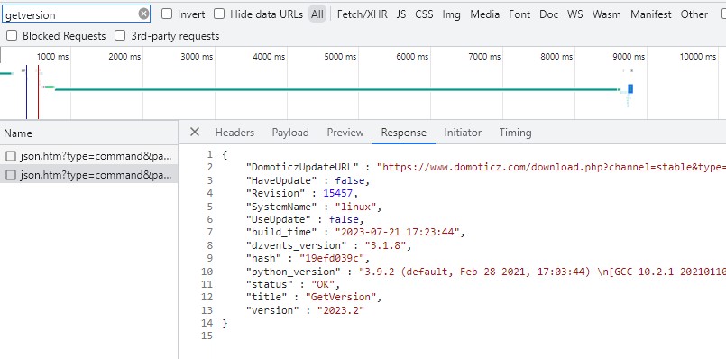

1) Check Dashticz
How did you update Dashticz? Via git pull?
What is the output of the following command:
git status
2) Domoticz authentication
In domoticz->setup->settings->security:
* enable 'AllowPlainBasicHttp'
* Add your subnet to Local networks (no username/password)
3) Check network log
Open DevTools (press F12) and refresh Dashticz.
In the DevTools->Network you see a filter box in the upper left. Fill in 'getversion'
Now you should see two network request. Click on the second one.
It should look like this:

Devtool getversion:
"DomoticzUpdateURL" : "https://www.domoticz.com/download.php?c ... ine=armv7l",
"HaveUpdate" : false,
"Revision" : 15453,
"SystemName" : "linux",
"UseUpdate" : true,
"build_time" : "2023-07-21 17:23:44",
"dzvents_version" : "3.1.8",
"hash" : "19efd039c",
"python_version" : "3.7.3 (default, Oct 31 2022, 14:04:00) \n[GCC 8.3.0]",
"status" : "OK",
"title" : "GetVersion",
"version" : "2023.2"
Also the Rtype problem in the logs is gone, so everyting is solved. :D
