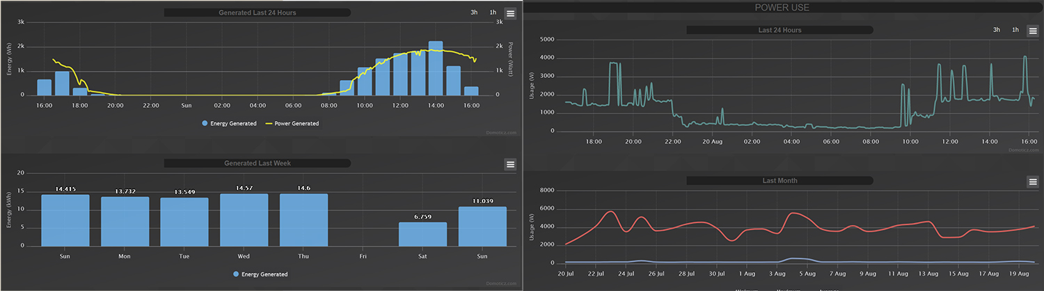

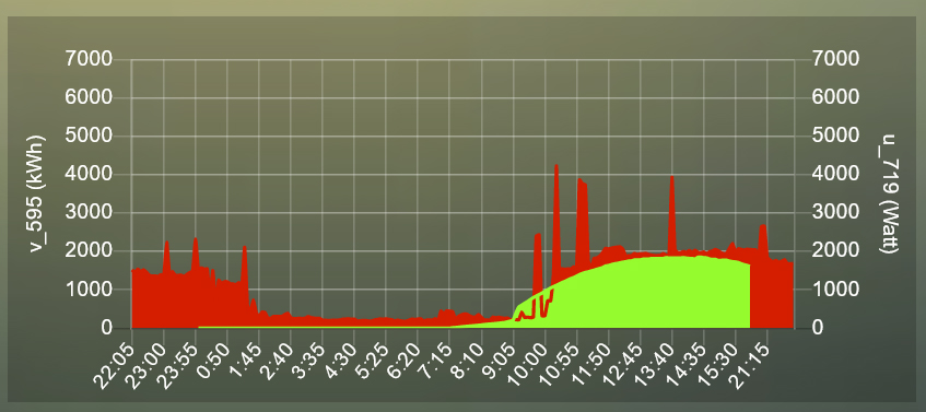

So the 2 graphs:
Old Dashticz gave me this result... And since I upgraded the same data gives me this... My Block is:
blocks['powergraph'] = {
devices: [595,719],
title: 'x',
custom:{
graph: ['line','line'],
lineFill: true,
height: '150px',
legend: false,
ylabels: ['W'],
range: 'today',
filter: '24 hours',
datasetColors: ['forestgreen','red'],
lineTension: 0.1,
maxTicksLimit: 9,
decimals: 0,
}(originally "range" was set to 'daily' and not 'today')
I'm not sure what changed but in the new image you can see the peaks seem to be greyed out.
The data in Domoticz looks like this:
Solar (KWh), Power Use (W)

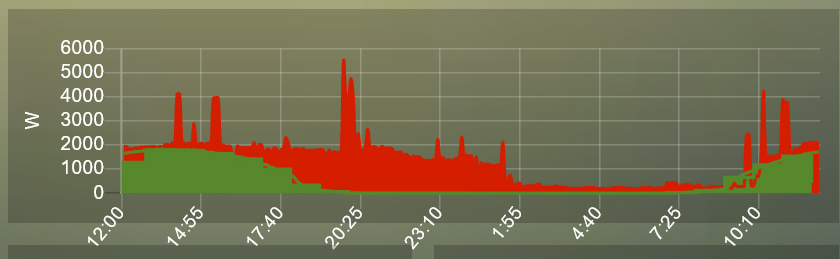

Once again, thanks for your help.
My intention is to end up with something like my original graph which gives a clear visual warning of lots of imported power while also showing the amount of solar generated. At a glance it gives me and the rest of the family plenty of data to make decisions regarding power use and/or problems in the home.
I tried "blockTypes" and also "graphTypes" but to no avail. I also tried transparency but applying it only to the "eu_595" dataset also applied the style to the "v_595" dataset. I have almost got it going by colouring the unwanted "eu_595" data set the same red as "v-595" with my final Block definition being...
Giving this result..
Which is close enough to what I wanted. You can still see the blocking of the KWh dataset rather than the smooth curve of the W dataset but it's close enough. Thanks for your pointer,s you definitely helped my find a solution. Now onwards to getting my calender working again....

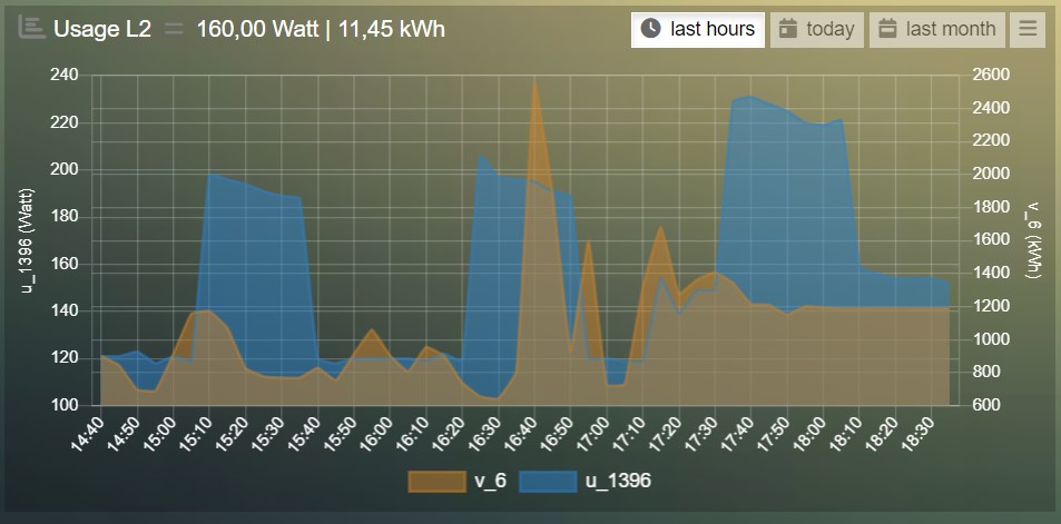

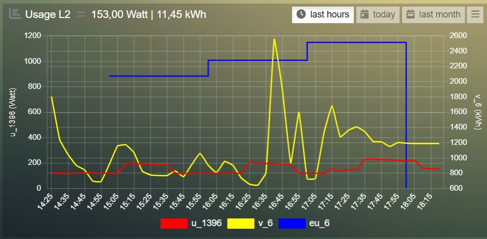

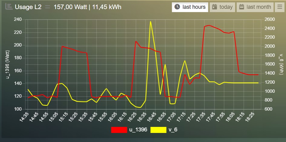

Start with a basic graph combining a 'usage electric' and a 'general - kWh' device:
This gives:
As you can see, device 1396 provides dataset 'u', device 6 provides datasets 'v' and 'eu'.
Now remove the 'eu' dataset by defining graphTypes parameter (case sensitive):
This gives:
Now we can start coloring the chart area.
I think this is what you would like to have. Enjoy
blocks['gr'] = {
devices: [1396, 6],
type: 'graph',
legend: true,
graphTypes: ['v','u']
blocks['gr'] = {
devices: [1396, 6],
type: 'graph',
legend: true,
graphTypes: ['v','u'],
datasetColors: ['rgba(44,130,201,0.5)', 'rgba(201,130,44,0.5)'],
lineFill: [true, true],
drawOrderLast: ['v_6','u_1396']

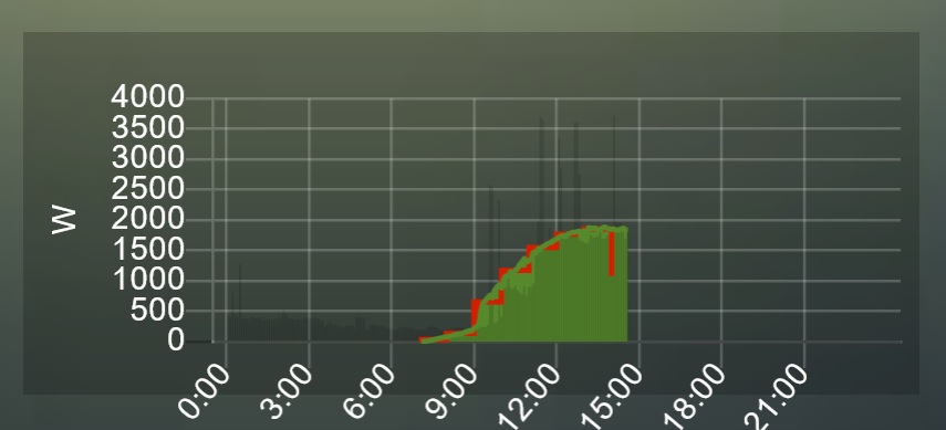

Amazing !
I adapted your block definition to the colours and transparency I wanted and added a "scales" definition so they both share the same scale which I set at my maximum utility supply of 7000W. Now it's exactly how I wanted it and I couldn't have done it without your help.
Pretty happy now
devices: [595, 719],
type: 'graph',
legend: false,
datasetColors: ['rgba(0,255,0,1)', 'rgba(255,0,0,1)'],
options: {scales:
{yAxes:
[{ticks: {min: 0,max: 7000}}, {ticks: {min: 0,max: 7000}}]
range: 'day',
drawOrderDay: ['v_595','u_719']
