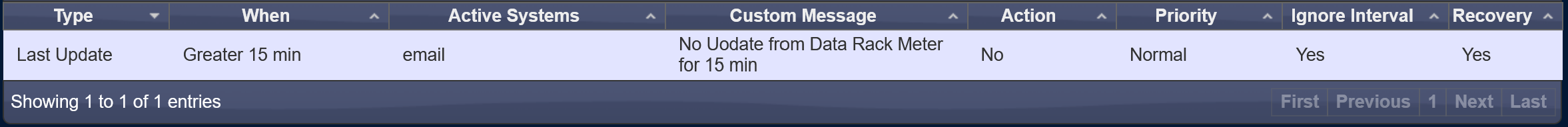

Hi Walter, regarding the device specific notifications which allows one to receive quite quickly alerts when a critical sensor goes offline by ignoring the main interval settings in Domoticz and after defined value when it last was seen. Why this solves one issue another one occurs which is that Domoticz now keeps sending an email once per minute where it would be great if it just sent one (1) inital email based on the rules defined in the device notification and after that it could utilise for example the system defined interval. Is there any workaround or tweak to avoid getting the inbox flooded?waltervl wrote: Saturday 26 August 2023 14:42In Domoticz you can set a notification on sensors (not switches!) when a certain time has been passed without update.

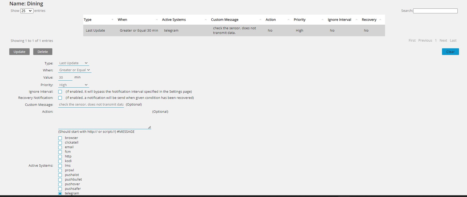

Ok, interesting, so either a bug or error 40 on my side; here is the settings for the device notification, either I overlooked something very obvisious or it's something else in the main Domoticz settings:waltervl wrote: Sunday 27 August 2023 22:29I don't have that issue when using this function. I only get one notification when the last update is above a certain level.

I see I have the "Ignore Interval" set to No. So perhaps that is the issue.kimhav wrote: Monday 28 August 2023 9:08Ok, interesting, so either a bug or error 40 on my side; here is the settings for the device notification, either I overlooked something very obvisious or it's something else in the main Domoticz settings:waltervl wrote: Sunday 27 August 2023 22:29I don't have that issue when using this function. I only get one notification when the last update is above a certain level.

Ok, I'll try chainging the "Ignore Interval" to No and let's see how it works out.waltervl wrote: Monday 28 August 2023 10:22I see I have the "Ignore Interval" set to No. So perhaps that is the issue.
- Posts: 6677
- Domoticz version: 2025.1
Re: offline device
I did not these this for such a short offline tracking so I don't know. I use 2800 minutes. You can check the global setting in menu setup - settings, tab notifications
