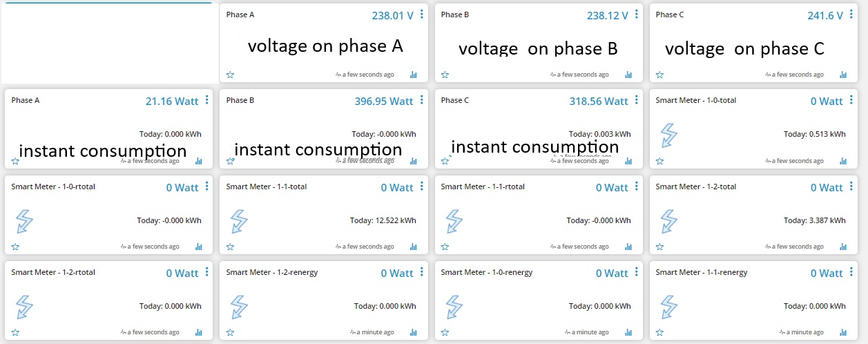

need big big help
i use Shelly MQTT plugin to monitor shelly 3 EM.
so far I think everything is ok. He created a few idxs for me and I understood some of them. I wrote on each IDX what I think it represents. I don't know how to make an IDX that shows my daily consumption and a monthly IDX, in a time interval. Can someone get me out of the fog?
shelly 3 EM.jpg (140.44 KiB) Viewed 4178 times

ssk17051980 wrote: Tuesday 29 August 2023 20:23 Hello,
need big big help
As this has nothing to do with the plugin you better start a new topic for this question or find an existing one like this : viewtopic.php?p=206152#p206152

Post by ssk17051980 »
I don't know the meaning of all the idx.

ssk17051980 wrote: Tuesday 29 August 2023 21:43 I don't know the meaning of all the idx.
If you read Shelly Docs you will have some clue what total, total energy and total returned mean:
https://shelly-api-docs.shelly.cloud/ge ... y-3em-mqtt
Better ask that question in the other topic for scripting....
But IDX is the ID of the domoticz device. First column in menu Setup - Devices
waltervl wrote: Wednesday 30 August 2023 13:21
i know what is the idx.
the problem is that i do not know my monthly consumption or at a certain time of the month
