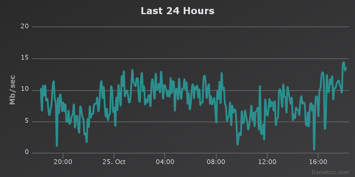

I have set up this script and it works really well.
The only problem is after having run it every 5 minutes for a week, I have discovered that each speed measurement appears to download 30MBytes, so my limited allowance disappeared very rapidly.
Is 30MB per test about right?
Is there a way of using less than 30MB per test?
Obviously testing every 5 minutes is probably too often and I could test less often, so use up less of my allowance, but 30MB still seemed too big, so I was wondering if anybody knew how much data speedtest is supposed to transmit?

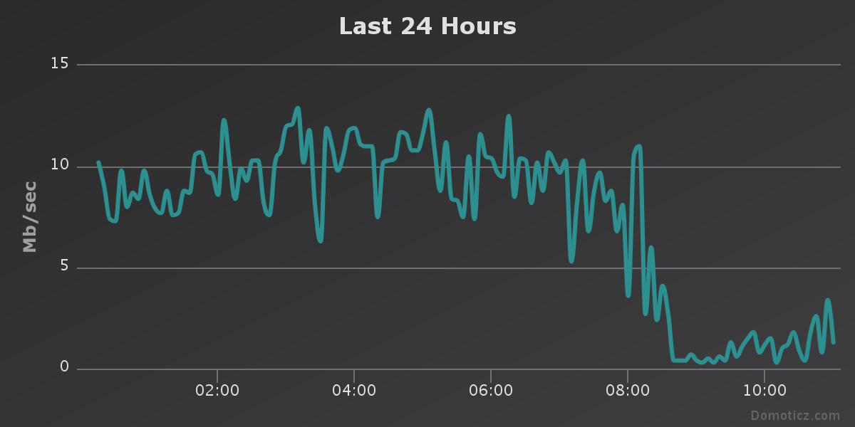

Absolutely right, but equally surprising to me in that I didn't reallise how little of my actual bandwith I noramlly use and how little I have to use to exceed my quotas - at 10Mbps 30MB is about 20seconds, so my quota is fully gone in 7 days rather than 31 at less than 8% usage.emme wrote:I don't really think that speedtest is intend to be run every 5 minutes
I run it 4 times a day: at 3.00am / 9.00am / 3.00pm / 9.00pm
Speedtest uses all available bandwidth by design... running so often results in poor network performances...
I had assumed that speedtest wasn't really downloading or uploading very much, hence 30MB was a bit of a shock, as you say it has to measure full speed so in hindsight not so surprising
I was trying spot why my internet while general fast enough, sometimes shows stuttering which kills streaming and doesn't help with VOIP. So monitoring changes in speed to see if I could spot any trends.
I was combining speedtesting wtih pulling off recieved and transmit statistics from my router to see if I can see correlations apart from the obvious.
