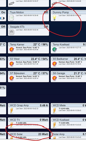

The whole idea is to show if a pump is running, based on the power it uses (there are others devices connected to the Smartplug) but when the power > 4 Watts the the pump is running 10% and 50Watts when running 100%

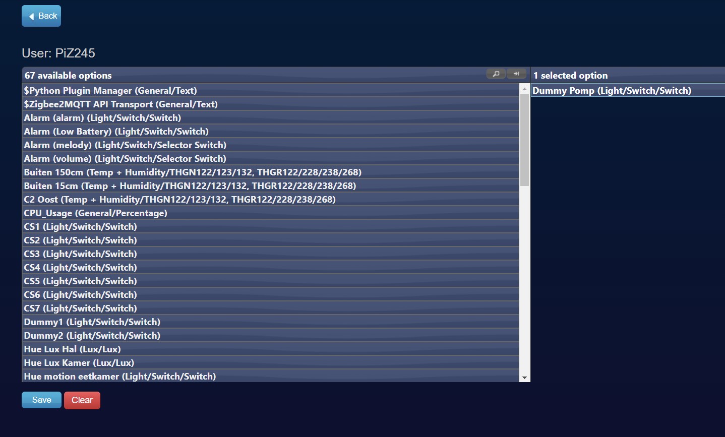

. When i make a blockly script on the Pi where Zigbee2MQTT runs and use a dummy switch, then the switch goes on >4-50W and off <4W. I also see the dummy when go to the user and select device i want to share
