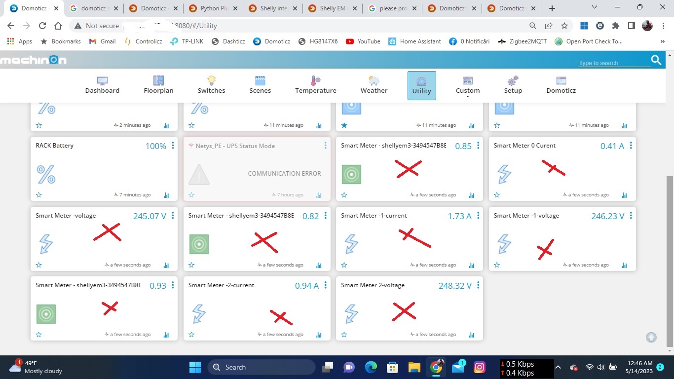

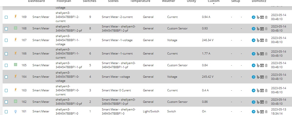

plugin create the device, but i do not see the total energy
thx

ssk17051980 wrote: Saturday 13 May 2023 23:49 plugin create the device, but i do not see the total energy
If you do not see the total energy, maybe it is a good idea to enable Power reading in plugin settings:
https://github.com/enesbcs/Shelly_MQTT/ ... working%3F

lwolf wrote: Sunday 21 May 2023 17:05
for the moment i see the energy.
the bad part is that there are 3 phases, and I have to find a formula that will show me the total.
