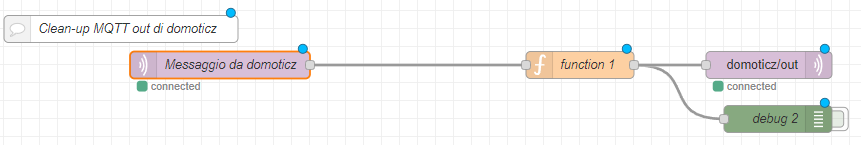

My point actually was also about the lengty messages: Domoticz sent not only the status (idx, nvalue, svalue1) but also a lot of other information, like description, that could cause harm to the "poor" sonoff basic (which I have a lot). A couple of messages, or only one, can force the device to detach from MQTT and became irresponsive for a while.
Yes I could avoid to put descriptions on the property pages of devices, but I'd rather use the quickiest solution to use a MQTT Nodered flow to filter everything out.
Function script:
if ( msg.payload && "idx" in msg.payload)
// if ( msg.payload.idx==46)
msgnew={};
msgnew.payload={ "idx":msg.payload.idx}
if ( msg.payload && "nvalue" in msg.payload) msgnew.payload.nvalue=msg.payload.nvalue
if ( msg.payload && "svalue" in msg.payload) msgnew.payload.svalue=msg.payload.svalue
if ( msg.payload && "svalue1" in msg.payload) msgnew.payload.svalue1=msg.payload.svalue1
if ( msg.payload && "svalue2" in msg.payload) msgnew.payload.svalue2=msg.payload.svalue2
return msgnew
// else
// return null;
return null;
Alex
