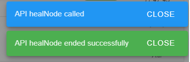

Healing a node simply puts this on my screen instantly. Same goes for re-interviewing. I initiate the request and instantly it states it is finished.

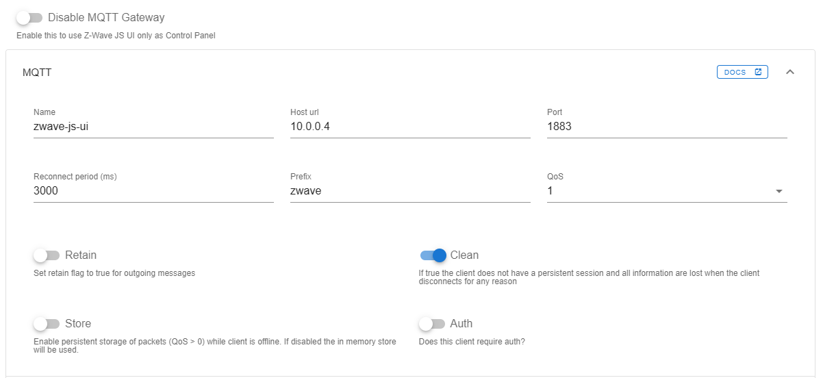

MikeyMan
- Posts: 237
- Joined: Wednesday 17 October 2018 12:11
Re: Easiest way to migrate Openzwave to ZWave-JS-UI
@sincze; that's the same firmware i'm on. Unfortunatly do have some issues with devices becoming unresponsive.
Only way to fix it is to manually remove the mqtt messages with mqtt explorer.
I have the retain option set to yes, according to the manual.

MikeyMan
- Posts: 237
Still have recurring nodes that become inaccessible. Manually deleting the retained messages and restarting domoticz does help. Strange thing is that I have turned off the retaine option in zwavejs.

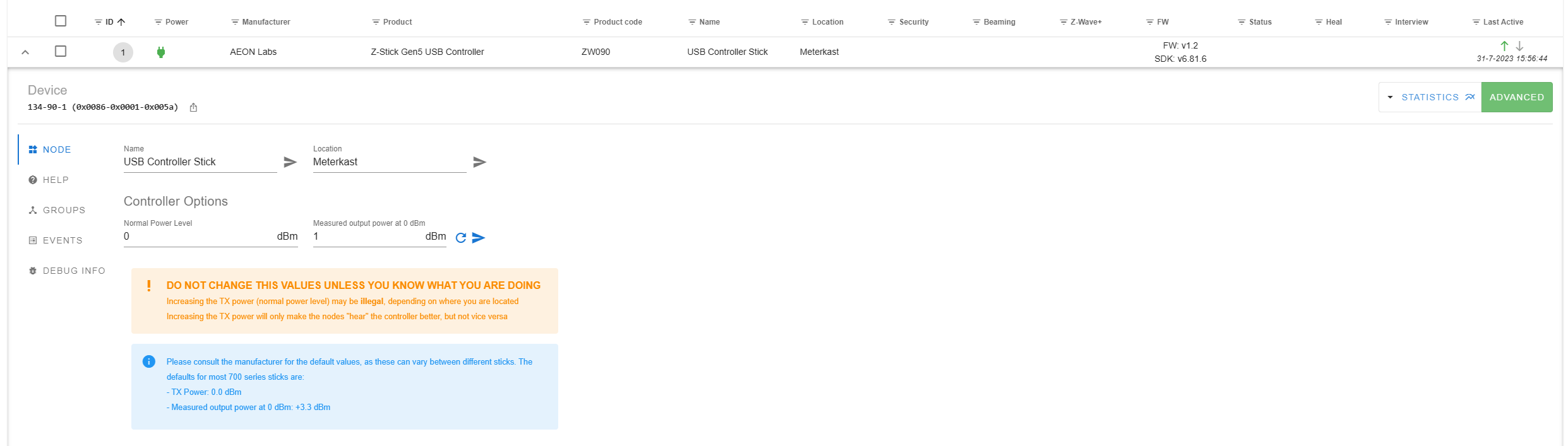

MikeyMan
- Posts: 237
I've got these settings now: And this stick: No clue what discord is tbh. Is that the ZwaveJS developer? Might be down to domoticz.sincze wrote: Monday 31 July 2023 14:28If you want I can share you my settings.MikeyMan wrote: Monday 31 July 2023 14:22 Still have recurring nodes that become inaccessible. Manually deleting the retained messages and restarting domoticz does help. Strange thing is that I have turned off the retaine option in zwavejs.
What stick are you using ? Did you join the DISCORD channel where we discuss these issues with the developer directly??
When the issue occurs, the node is controllable through the zwavejs frontend.
