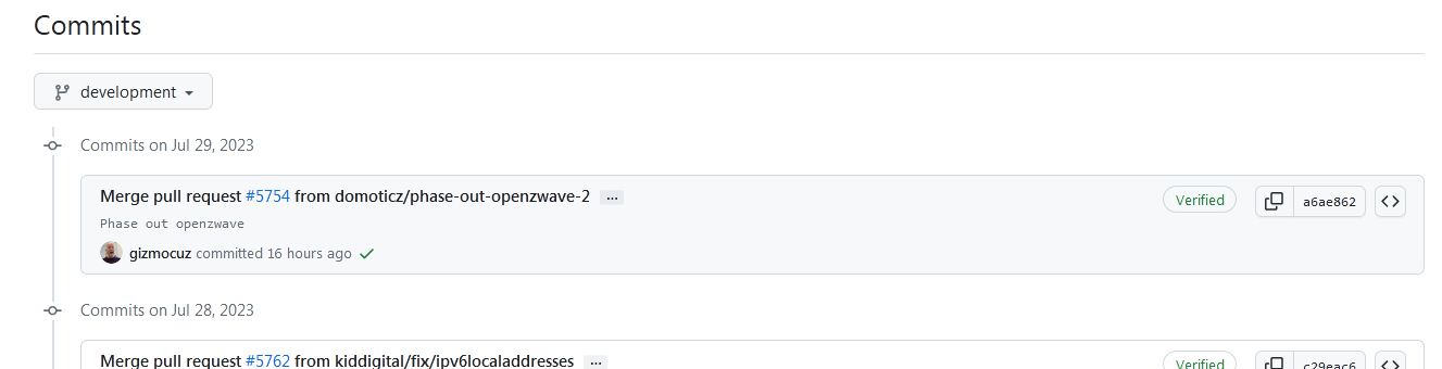

I saw this on Github........"Merge pull request #5754 from domoticz/phase-out-openzwave-2 "
Is this the end of OpenZwave in Domoticz, if yes.... what is the latest Beta version which still runs OpenZwave?
The commit page (https://www.domoticz.com/wiki/Domoticz_ ... _-_Commits) on wiki does not seem to be updated with details anymore, and I do not fully understand how Github works, to see more details of this commit.
