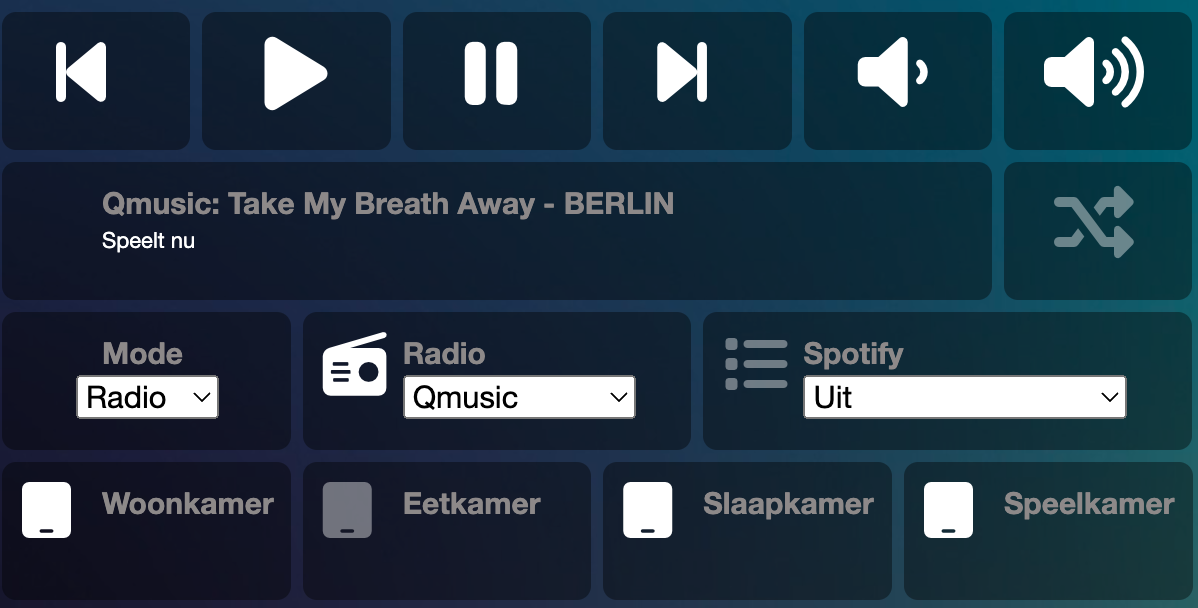

Hi all, I'm a long time Domoticz user and recently started with Dashticz. I like it a lot so I'm working on my first dashboard with help of layouts/ideas of many of you here :D
nfuse wrote: Tuesday 11 July 2023 0:34 to keep this topic alive my latest dashboard it need some tuning but i'am really happy with it everything in one page has still my preference.
Great dashboard nfuse! May I ask you how you got this nice Sonos implementation in that frame? I looked at your provided code but unfortunately could not find any traces of the actual implementation. I am running the sonos-http-api by Jishi on my RPi and the way I now managed to implement some functionality is by creating a Domoticz switch for pretty much all functions (Pause/Play, Vol+/-, add/remove speaker to master), which is constantly being updates via a python script running as cronjob. All these switches are then put on the Dashticz dashboard. See attached image
You implementation is much cleaner in my view and - if you don't mind of course - I would love to learn how you got it implemented that way!
nfuse
Posts: 35
Joined: Thursday 26 March 2020 11:37
Post by nfuse »
babbel wrote: Wednesday 19 July 2023 10:23 Hi all, I'm a long time Domoticz user and recently started with Dashticz. I like it a lot so I'm working on my first dashboard with help of layouts/ideas of many of you here :D
well i did a feature request a few years back but i dont think not much people use sonos 8-) so i build my own flask app and request it as a iframe.
i am happy to share the code so you can adapt it to your own needs.
Here are the steps. ow and you need a working sonos api you can find it here https://github.com/chrisns/docker-node-sonos-http-api and here https://github.com/jishi/node-sonos-http-api i allready had that implemented for speech commands doorbel over sonos etc
create the next files following this directory structure: ( i run it in docker but you can start it from the command line to test and tune first)
to run in docker
copy to flask directory
execute from that directory
docker build -t flask-app .
docker run -p 5001:5000 flask-app (5001 port of own choice)
rename in portainer and set to always on unless stopped.
/flaskapp/
/flaskapp/sonos-flask.py
/flaskapp/Dockerfile
/flaskapp/requirements.txt
/flaskapp/static/
/flaskapp/static/css
/flaskapp/static/css/styles.css
/flaskapp/static/img/
/flaskapp/static/img/default_album_art.png
/flaskapp/static/img/next.png
/flaskapp/static/img/pause.png
/flaskapp/static/img/play.png
/flaskapp/static/img/playpause.png
/flaskapp/static/img/previous.png
/flaskapp/static/img/stop.png
/flaskapp/templates/
/flaskapp/templates/index.html
/flaskapp/templates/favicon.ico
sonos-flask.py (start on command line with "python sonos-flask.py")
from flask import Flask, render_template, request
import requests
import json
import logging
app = Flask(__name__, static_folder='static')
app.logger.setLevel(logging.DEBUG)
rooms = ['keuken', 'woonkamer', 'veranda']  # List of rooms
@app.route('/')
def home():
    states = {}
    for room in rooms:
        response = requests.get(f'http://192.168.2.11:5005/{room}/state') # url from sonos api https://github.com/chrisns/docker-node-sonos-http-api
        if response.status_code == 200:
            state = json.loads(response.text)
            states[room] = state
        else:
            print(f"Couldn't fetch state for room: {room}")
    return render_template('index.html', states=states)  # Assuming you have a template called index.html
@app.route('/<zone>/<action>', methods=['POST'])
def handle_button(zone, action):
    print(f'Button clicked - Zone: {zone}, Action: {action}')
    url = f'http://192.168.2.11:5005/{zone}/{action}' # url from sonos api https://github.com/chrisns/docker-node-sonos-http-api
    response = requests.post(url)
    if response.ok:
        return "Button action performed"
    else:
        return "Error: Button action failed", 500
if __name__ == '__main__':
    app.run(host='0.0.0.0', port=5000, debug=True)
Dockerfile
# Use the official Python base image with the desired version
FROM python:3.8-slim
# Set the working directory inside the container
WORKDIR /app
# Copy the requirements file and install the dependencies
COPY requirements.txt .
RUN pip install --no-cache-dir -r requirements.txt
# Copy the rest of the application code
COPY . .
# Expose the port your Flask app is listening on
EXPOSE 5000
# Define the command to run your Flask app when the container starts
CMD ["python", "sonos-flask.py"]
requirements.txt
flask
requests
styles.css

            handleButtonClick(url);
						// Toggle visibility of pause and play buttons
			pauseButton.style.display = "inline";
			playButton.style.display = "none";
			// Adjust the positioning of the music controls container
			musicControls.style.left = "50%";
        pauseButton.addEventListener("click", function() {
            var selectedValue = zoneSelect.value; // Get the selected value
            var url = "http://192.168.2.11:5005/" + selectedValue + "/pause";
			pauseButton.style.display = "none";
			playButton.style.display = "inline";
        previousButton.addEventListener("click", function() {
            var url = "http://192.168.2.11:5005/" + selectedValue + "/previous";
        nextButton.addEventListener("click", function() {
            var url = "http://192.168.2.11:5005/" + selectedValue + "/next";
        // favorite selector
        var favoriteSelect = document.getElementById("favorite-select");
        // Add change event listener to the favorite-select
        favoriteSelect.addEventListener("change", function() {
            var selectedValue = favoriteSelect.value; // Get the selected value
            var zoneValue = zoneSelect.value; // Get the selected zone
            var url = base_url + zoneValue + "/" + selectedValue;
        // Function to update the volume slider value
        function updateVolumeSlider(volume) {
            var volumeSlider = document.getElementById("volume-slider");
            volumeSlider.value = volume;
            var currentValue = document.getElementById("currentValue");
            currentValue.textContent = "vol: " + volume;
        // Function to handle the volume slider change event
        function handleVolumeChange() {
            var volume = volumeSlider.value;
            var url = "http://192.168.2.11:5005/" + selectedValue + "/volume/" + volume;
        // Add change event listener to the volume slider
        volumeSlider.addEventListener("change", handleVolumeChange);
			var base_url = 'http://192.168.2.11:5005/';
			var selectedZone = localStorage.getItem('selectedZone') || document.getElementById('zone-select').value;
			var oldState = null;
			if (localStorage.getItem('selectedZone')) {
				zoneSelect.value = localStorage.getItem('selectedZone');
				var selectedOption = document.getElementById("zone-select");
				var currentZone = selectedOption.options[selectedOption.selectedIndex].text;
				document.getElementById("current-zone").textContent = "Sonos " + currentZone + " - Now Playing";
        async function getState(zone) {
            var url = base_url + zone + '/state';
            let response = await fetch(url);
            if (!response.ok) {
                throw new Error('HTTP error ' + response.status);
            let data = await response.json();
            return data;
        function formatTime(seconds) {
            var minutes = Math.floor(seconds / 60);
            var remainingSeconds = seconds % 60;
            return minutes.toString().padStart(2, '0') + ':' + remainingSeconds.toString().padStart(2, '0');
		function updateAlbumArt(albumArtUri) {
			var albumArtImg = document.getElementById("album-art");
			if (albumArtUri) {
				albumArtImg.src = albumArtUri;
          } else {
            albumArtImg.src = "/static/img/default_album_art.png";
        async function updateState() {
            var newState = await getState(selectedZone);
            if (oldState === null || JSON.stringify(newState) !== JSON.stringify(oldState)) {
                // The state has changed, update the webpage
                document.getElementById('current-song').textContent = newState['currentTrack']['title'];
                document.getElementById('current-artist').textContent = newState['currentTrack']['artist'];
				// Update the album art
				updateAlbumArt(newState['currentTrack']['absoluteAlbumArtUri']);
                var elapsedTime = newState['elapsedTime'];
                var trackDuration = newState['currentTrack']['duration'];
                var remainingTime = trackDuration - elapsedTime;
                document.getElementById('time-remaining').textContent = formatTime(remainingTime);
                oldState = newState;
                // Update volume slider value
                updateVolumeSlider(newState['volume']);
                // Update the current zone dynamically based on the selected option
        document.getElementById("zone-select").addEventListener("change", function() {
            selectedZone = selectedOption.value; // Update the selected zone
            oldState = null; // Reset old state to force update on zone change
            localStorage.setItem('selectedZone', selectedZone); // Save the selected zone to local storage
            updateState(); // Update the state immediately after zone change
        // Initial state update
        updateState();
        // Regular state updates every 1 second
        setInterval(updateState, 1000);
    </script>
</body>
</html>
known bugs i have to fix:
- play button needs to presses before it pauses and change the png to pause when changed zones
- green slider point a little to big
- layout improvements
good luck
i updated this post with a zip file of the plugin for your convenience https://processware.datadrop.nl/index.p ... plugin.zip

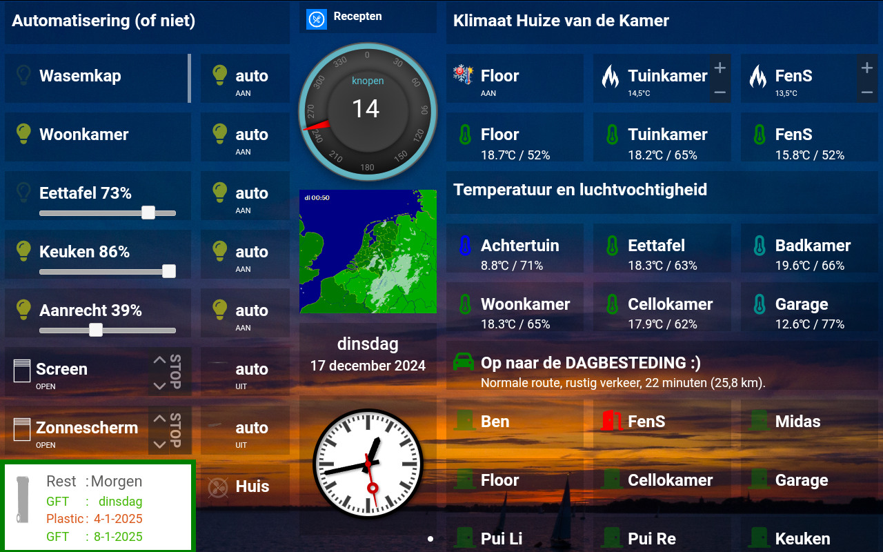

Yesss, we are hooked on dashticz. last week i thought, i want the route information for my daughter, when me or my wife is bringing her to the day activity center. But i didnt want the map from maps in the screen, because there is no space :) so finally andt thanks to CHATgpt i got it!! is has basicly 2 functions:
normal of different route
time of travel. (green car normal time, orange busy on the way, red delay , pink extreme delay
its very basic and very handy in our situation. so just sharing. :)

Sure!! i can help you in the right directon for the route. For the energy things follow Walters attention :)
First make a text dummy device (IDX 5098 in my situation)
than python script, i run it with crontab, if the route_data.json file doesnt exist, it will be greated.
import json
import requests
import subprocess
# Instellingen voor het script
NORMAL_DISTANCE = 77.4  # Normale routeafstand in kilometers
DOMOTICZ_IP = "192.168.1.55"  # Vervang dit door jouw Domoticz IP-adres
DOMOTICZ_IDX = 5098  # IDX van jouw Domoticz device
# Google Maps API: Vul je eigen API-sleutel hieronder in
API_KEY = "YOUR_API_KEY"  # <-- Vervang dit door je eigen API-sleutel!
# Voer de curl-opdracht uit om de routegegevens op te halen
curl_command = (
    "curl -s 'https://maps.googleapis.com/maps/api/directions/json?"
    "origin=Stationsplein+1,+Amsterdam&destination=Stationsplein+1,+Rotterdam"
    f"&key={API_KEY}&language=nl&departure_time=now' -o route_data.json"
subprocess.run(curl_command, shell=True)
# Laad de JSON-gegevens uit het bestand
try:
    with open("route_data.json", "r") as f:
        data = json.load(f)
except FileNotFoundError:
    print("Fout: route_data.json niet gevonden. Controleer de API-aanroep.")
    exit()
# Controleer of er een route beschikbaar is
if "routes" in data and len(data["routes"]) > 0:
    # Haal de eerste route op
    route = data["routes"][0]
    leg = route["legs"][0]
    # Haal routegegevens op
    distance_text = leg["distance"]["text"]
    distance = float(distance_text.replace(",", ".").split()[0])
    duration_traffic_text = leg["duration_in_traffic"]["text"]
    duration_traffic = int(duration_traffic_text.split()[0])
    # Controleer of het een afwijkende route is
    if abs(distance - NORMAL_DISTANCE) > 0.05:  # Drempel 50 meter
        route_type = "AFWIJKENDE ROUTE!!"
    else:
        route_type = "Normale route"
    # Verkeersstatus op basis van reistijd
    if duration_traffic < 26:
        traffic_status = "rustig verkeer"
    elif 26 <= duration_traffic < 30:
        traffic_status = "drukte op de weg"
    elif 30 <= duration_traffic < 40:
        traffic_status = "Vertraging!"
    else:
        traffic_status = "Extreme vertraging!!"
    # Bericht opstellen
    message = (
        f"{route_type}, {traffic_status}, {duration_traffic} minuten "
        f"({distance_text})."
    # Update Domoticz met de route-informatie
    url = (
        f"http://{DOMOTICZ_IP}:8080/json.htm?"
        f"type=command&param=udevice&idx={DOMOTICZ_IDX}&svalue={message}"
    try:
        response = requests.get(url)
            print("Succesvol bijgewerkt in Domoticz.")
        else:
            print(f"Fout bij het bijwerken van Domoticz: {response.status_code}")
    except Exception as e:
        print(f"Fout bij het bijwerken van Domoticz: {e}")
    # Herlaad het device in Domoticz
    reload_url = f"http://{DOMOTICZ_IP}:8080/json.htm?type=command&param=refreshdevice&idx={DOMOTICZ_IDX}"
    try:
        response = requests.get(reload_url)
            print("Device succesvol herladen in Domoticz.")
        else:
            print(f"Fout bij het herladen van het device in Domoticz: {response.status_code}")
        print(f"Fout bij het herladen van het device in Domoticz: {e}")
else:
    print("Geen routes gevonden in de JSON-gegevens. Controleer je API-aanroep.")
then my CONFIG.js
blocks['routeAR'] = {
  type: 'text',             // Geeft tekstuele gegevens weer
  title: 'Van Amsterdam naar Rotterdam :)',   // Titel van het block
  refresh: 60,              // Update elke 60 seconden
  idx: 5098,                // De IDX van Domoticz waar je routegegevens staan
  icon: 'fas fa-car',       // Pictogram (optioneel, afhankelijk van Dashticz-versie)
  width:12,
then my custom.css
/* Kleuren voor de icoontjes afhankelijk van de reistijd */
.warninggreen {
  color: green !important;
.warningorangefloor {
  color: #ff6d00 !important;
.warningred {
  color: red !important;
.warningrozefloor {
  color: #f7088a !important;
.warninggrey {
  color: grey !important;
them my custom.js
$(document).ready(function() {
    setInterval(function() {
        var routeData = alldevices['5098']?.Data || '';
        if (!routeData || routeData === "") {
            console.log('Geen data beschikbaar, icoon blijft ongewijzigd.');
            return; // Stop de verdere uitvoering
        console.log('Routegegevens: ' + routeData);
        // Zoek naar de reistijd in minuten
        var match = routeData.match(/(\d+)\s*minuten/);
        var duration_in_traffic = match ? parseInt(match[1]) : null;
        var iconColorClass = 'warninggrey'; // Fallback naar grijs
        if (duration_in_traffic !== null) {
            if (duration_in_traffic < 26) {
                iconColorClass = 'warninggreen'; // Snel
            } else if (duration_in_traffic < 30) {
                iconColorClass = 'warningorangefloor'; // Lichte vertraging
            } else if (duration_in_traffic < 40) {
                iconColorClass = 'warningred'; // Matige vertraging
            } else {
                iconColorClass = 'warningrozefloor'; // Zware vertraging
        // Selecteer het icoon en pas de kleurklasse toe
        var $icon = $('.block_routeAT em:first');
        if ($icon.length === 0) {
            console.error('Icoon niet gevonden in DOM.');
            return;
        // Verwijder oude kleurklassen en voeg de nieuwe kleurklasse toe
        $icon.removeClass('warninggreen warningorangefloor warningred warningrozefloor warninggrey')
             .addClass(iconColorClass);
    }, 3000); // Iets kortere interval (3 seconden)
somehow my greyfallback doenst work, and after the refresh of de data of the idx the icon starts white. i dont know how and why, but we used to live with that.
