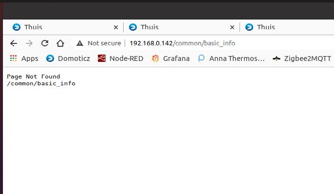

What I see in the code it will setup a connection to the website
		szURL << "http://" << m_Username << ":" << m_Password << "@" << m_szIPAddress << ":" << m_usIPPort;
	szURL << "/common/basic_info";
So translated: http://UserName:Password@DaikinIP:Port/common/basic_info
If Username, password is left empty it will connect to: http://DaikinIP:Port/common/basic_info
So to test you could manualy put this URL with your DaikinIP and Port and if needed Username and Password in a browser and it will gave some text back.
If succeeded please respond so I can update the wiki wit further instructions.

I get the following text if I leave out the /common/basic_info part:

Yes, but the common/basic_info part is far more important!!
So please tell what you get. There should be some info about your air-conditioning unit.
Alain
Posts: 171
Joined: Sunday 26 April 2020 5:27
Domoticz version: 2022.1
Re: Daikin Hardware
Post by Alain »
waltervl wrote: Wednesday 02 June 2021 19:37 Yes, but the common/basic_info part is far more important!!
I don't get any info from the air conditioner. I just get a Page not found error.
Hue | Zigbee2Mqtt | MQTT | P1 | Xiaomi | RFXCom | Modbus | TP-Link | Node-Red | Grafana |
Posts: 6683
Domoticz version: 2025.1
Re: Daikin Hardware
Alain wrote: Thursday 03 June 2021 7:22
Then you have the wrong IP address or your Daikin is not compatible with this Domoticz hardware gateway.
Do you have to fill in an account when using the Daikin App?

I've been looking around on internet (github etc.) and see someone disclaiming that their script/library won't work with airco's that use the Daikin Residential Controller app. I think that's where my problem is. My units use that app and have a manufacture date of april/2021. I hope someone can get this to work on newer units soon.
@waltervl Yes, I have to fill in an account in the app.

What if you try: http://UserName:Password@DaikinIP:Port/common/basic_info
Alain
Posts: 171
Re: Daikin Hardware
Post by Alain »
waltervl wrote: Thursday 03 June 2021 9:09
Alain wrote: Thursday 03 June 2021 9:06
Same error
