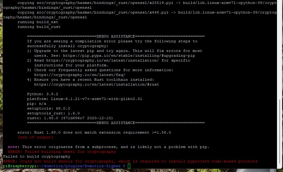

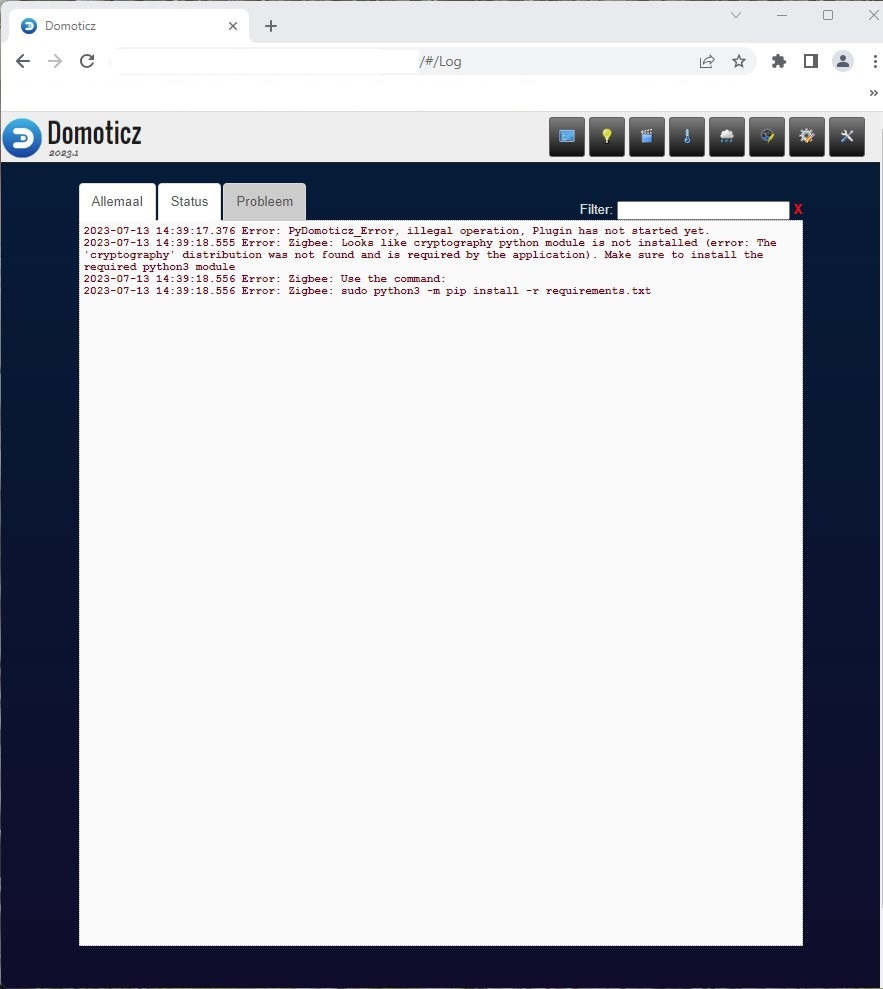

After an update from Buster to bullseye the Zigbee plugin fails to load. I tried to run the requirments_txt in sudo and without sudo, tried to load the moduls manualy. Also tried to update Rust I can't make this plugin working. i am running Domoricz 20231. What can go wrong?
Update: if i run requirements_txt without sudo, Cryptography is installed without a problem. But it is not installed in the right place (i think). After a restart of Domotics the same error is still there. If i install Cryptography with sudo, it fails with the error. I have the latest pip and Rust. The meassage is that i have an outdated rustc? Could that the problem?

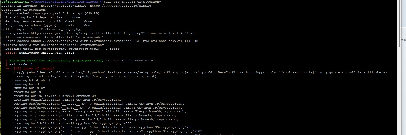

I've tried both options, no succes.
1 file seems to be a beta. Is that a problem?
