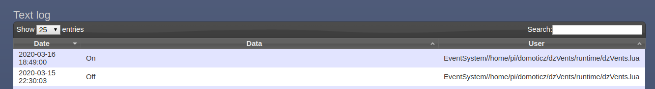

If you click on the Log button of a switch you see the following table:
How can I read the User in dzVents? I only need to know the last user who changed the state of the switch.
In this case the User is = EventSystem/home/pi/domoticz/dzVents/runtime/dzVents.lua

This feature is not completely implemented in domoticz yet. It is something that needs to picked up but might take some time.wizzard72 wrote: Monday 16 March 2020 22:34 If you click on the Log button of a switch you see the following table:
