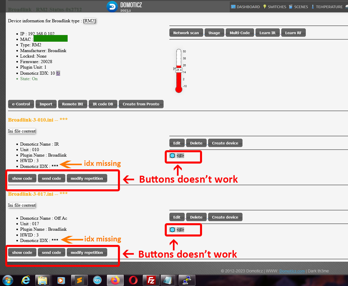

Thank you. I tried but with python 3.11.3 doesn't work. I'm back to 3.9 and installing the plugin works perfectly.
Now i have another problem with plugin dashboard, sometihing is wrong, it looks a little different than it was normally: Buttons not working, can't send a command and idx from ini file missing.
I attached an print screen.
Please help me!

Hummm... mainly browser javascript support. Not any clue on what is working or not on Pi ...pfloryann wrote: Friday 12 May 2023 20:38 Thank you. I tried but with python 3.11.3 doesn't work. I'm back to 3.9 and installing the plugin works perfectly.
Please help me!
Thank you for your support!

Domoticz server is on Raspberry pi, but i access Domoticz from Pc, screenshot is from PC is not in Raspberry browser.
I have 2 raspberry pi...one with Buster Os, python 3.7 and broadlink plugin 1.6.1 - no problem.
Second server with Bullseye Os, python 3.9 and broadlink 1.6.4 - here i have that problem.

Ok, thanks, clear now.pfloryann wrote: Saturday 13 May 2023 0:18 Domoticz server is on Raspberry pi, but i access Domoticz from Pc, screenshot is from PC is not in Raspberry browser.
Nothing had changed on how the plugin work, Javascript is there since the first release ...!!
If you put your browser in devlopper tool, do yo see any error ?
and could be nice to see one of your ini file ...

So, i cheked in the browser console and i found the problem...in folder domoticz/www/js(on raspberry pi path: /home/pi/domoticz/www/js) missing jquery-3.4.1.min.js which the plugin needs. I put it manually and interface of the plugin is good and works. I'm back tomorow with the necessary steps to install this plugin on raspberry pi.
Please check these aspects and if you could add this jquery to the installation kit, I think it would be good.
Thank you!
Thank you!

Great, thanks for the info... the jquery should be provided by Domoticz installation, so maybe something new with Domoticz now. will double check, but I don't want to touch the www folder.pfloryann wrote: Saturday 13 May 2023 0:59 So, i cheked in the browser console and i found the problem...in folder domoticz/www/js(on raspberry pi path: /home/pi/domoticz/www/js) missing jquery-3.4.1.min.js which the plugin needs. I put it manually and interface of the plugin is good and works. I'm back tomorow with the necessary steps to install this plugin on raspberry pi.
Thank you!

2023-06-07 18:06:47.154 Error: Broadlink Camera: (Broadlink) failed to load 'plugin.py', Python Path used was 'C:\Program Files (x86)\Domoticz\plugins\Broadlink\;C:\Program Files (x86)\Python310-32\python310.zip;C:\Program Files (x86)\Python310-32\Lib\;C:\Program Files (x86)\Python310-32\DLLs\;C:\Program Files (x86)\Domoticz;C:\Program Files (x86)\Python310-32;C:\Program Files (x86)\Python310-32\lib\site-packages'.
this is problematic.....
Did you follow all steps to install python on windows ? specially, you need to allow python for all users etc ... (admin right)
And do you have installed the plugin on cmd with admin rights ?

yes, i did all this, also i tried without success every possible solution on this thread, sometimes one rm pro is working, sometimes the other, totally random. Is it possible to retrieve somewhere the old version of this plugin? i used it for years and it always worked perfectly with every version of domoticz!zak45 wrote: Wednesday 07 June 2023 23:52 2023-06-07 18:06:47.154 Error: Broadlink Camera: (Broadlink) failed to load 'plugin.py', Python Path used was 'C:\Program Files (x86)\Domoticz\plugins\Broadlink\;C:\Program Files (x86)\Python310-32\python310.zip;C:\Program Files (x86)\Python310-32\Lib\;C:\Program Files (x86)\Python310-32\DLLs\;C:\Program Files (x86)\Domoticz;C:\Program Files (x86)\Python310-32;C:\Program Files (x86)\Python310-32\lib\site-packages'.

Have you double checked that you use different Listener Port ?

Do not have 2 devices, but tried to declare a false second one and I got the same error as you :
ImportError: PyO3 modules may only be initialized once per interpreter process
Something in the Python framework that do not allow now to have the same plugin twice .... !!!!!!
