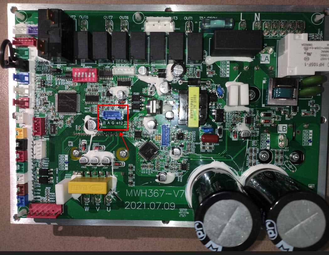

I have contacting Fairland customer support I got the information that this heatpump has a Modbus connector on the controller print. Attached is a picture of the PCB highlighting this. It is marked with B A G 12. (B and A are the signal wires, G is the ground wire, and +12V is the 12V power). On my own PCB the layout was slightly different but B G +12 was readable). Normally only A and B are used. G and +12V can be used to supply power to your Modbus controller. Customer support gave me also an Excel document with all the Modbus registers/coils information.

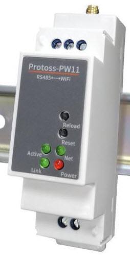

In my pool box I installed a Protoss PW11-H Wifi Modbus controller which is connected to my home network. The wires A B from the PCB are connected to the 5 en 7 terminals. G and +12V are not used as the WIFI controller has it's own power already. The protoss has initially its own Wifi Access Point which you connect to. Then you can configure this Protoss (baudrate, wifi network, disabled Access point, password and which Protocol to use).

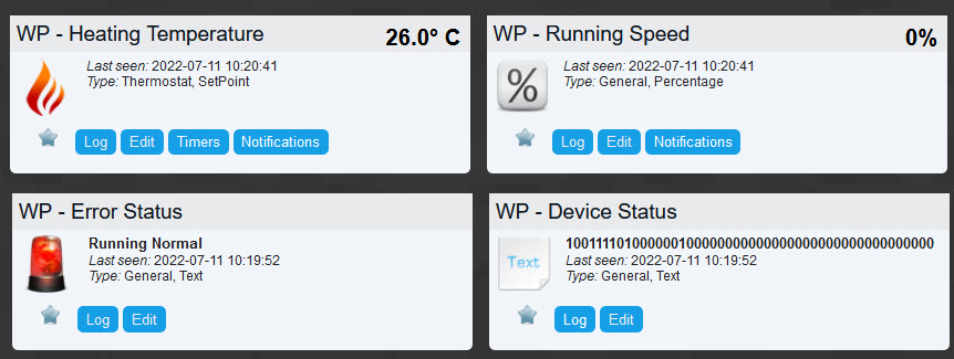

This plugin uses the pymodbus commands to read/write information from the heatpump. I can also set eg the running mode (smart/silent/turbo), temperature. From the documentation there is also a SuperSilent mode which I could not set from the standard App but via Modbus this works. In the mode is runs a max 20%. I can now see the inlet/outlet water temp, ambiant temp and the running speed. For the temperature I had to do some maths to get the correct temp. eg Modbus returns 112 which is 26C.
After this I continued to get the error status of the heatpump. Eg if the circulation pomp stops the heatpump stop as well because of the missing waterflow. Via Modbus I read these errors as well and domoticz will send out a notification with this error message. There is other device status available, which I do not exactly know where it is used file. At the moment I only log changes to a file.

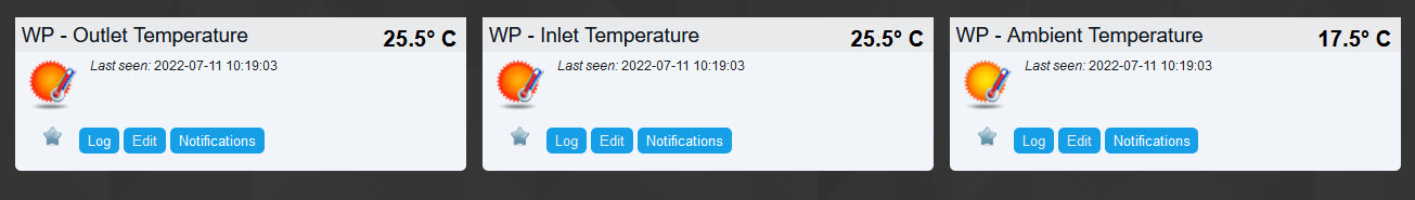

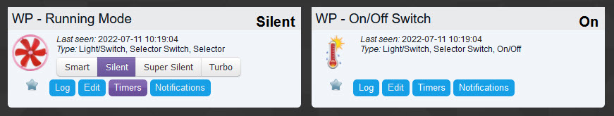

Switches:
Temperatures: Utilities

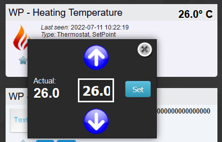

Setting the temperature:

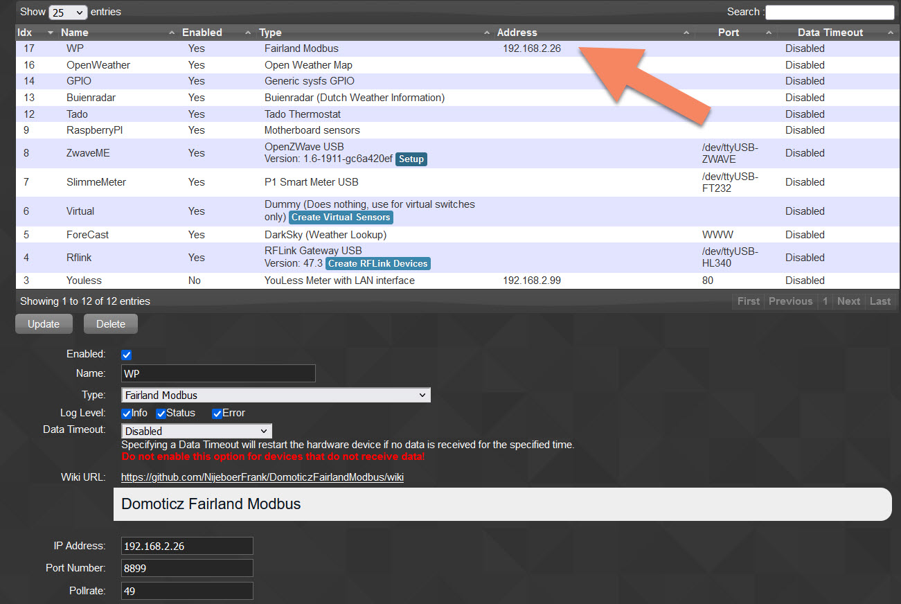

Hardware

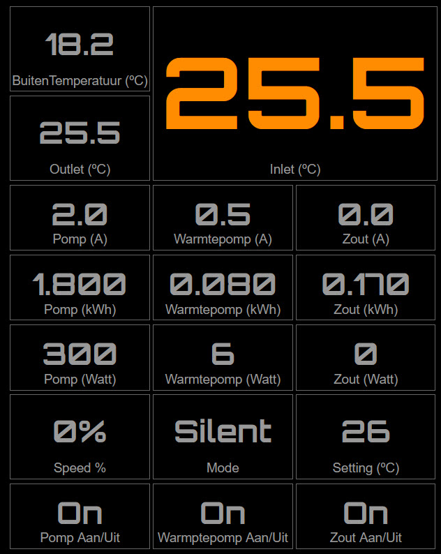

Also a specific Pool Control page showing Pool info. Some cell are clickable to get details or switch on/off.
I had already Zwave Wallplug connectors (Neo Coolcam). These are logging the powerconsumption and can be use the switch on/off eg the circulation pump and the salt electrolysis. In Domoticz I am using the power consumption to check if everything runs. In the past I had issues that eg after lightning the ground fault was activated and the salt electrolysis was not running anymore. With these wallplug I an able to detect this.

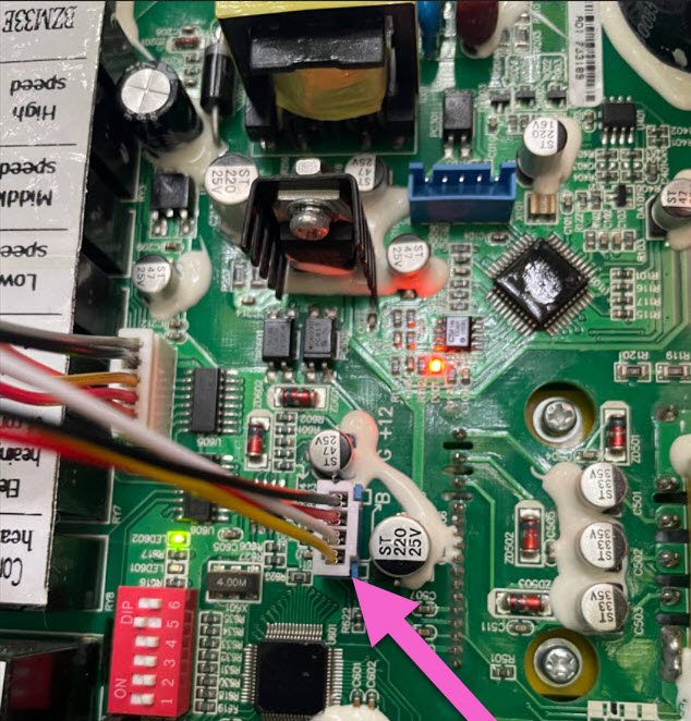

I have heat pump unit IPHCR26, so I am not exactly sure whether there is the same RS485 connector. Could you share with me in PM the contact person in Fairland please? I tried available email addresses, but so far no reply from them.
Re: SwimmingPool heatpump
Hi, I also have IPHCR26 with this connector. Are you sure with wirings? Do you know name/type of this connector to get male side?roboj121 wrote: Monday 17 April 2023 10:44 I am also solving the connection of the IPHCR100T heat pump using the modbus protocol - in terms of hardware, this model is already connected to the connector in the rear part (on the photo) - I would need a description of the registers. Could someone please send it to me (although also from another Fairland model) ?
