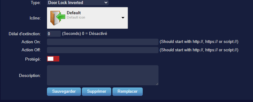

i think it's the problem, domoticz send only
never lockaction = 1
Posts: 6683
Domoticz version: 2025.1
Re: Nuki Smart Lock MQTT
I think that type of Domoticz device can only send an Open command, not a Close (or inverted if you invert the device). What of you change it to a normal ON/OFF switch?
