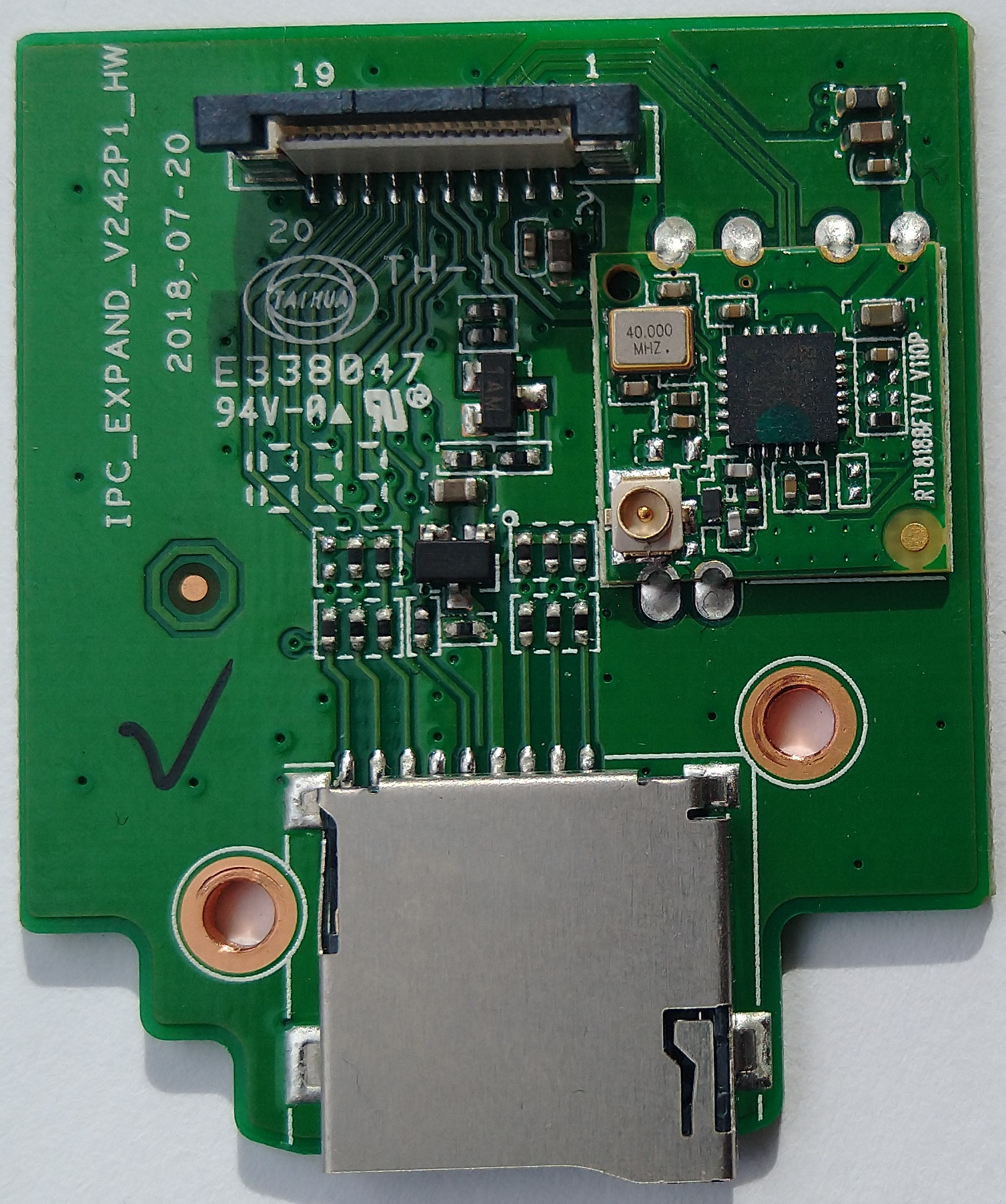

Found another camera at a flea market and got this information:
SoC HiSilicon 3518EV200
WiFi Realtek 8188FTV
Etherenet Realtek RTL8201F
Flash KH25L12835F
CryptoIC FT24C02A
SD-card reader

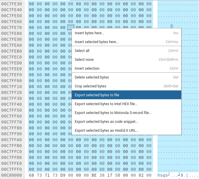

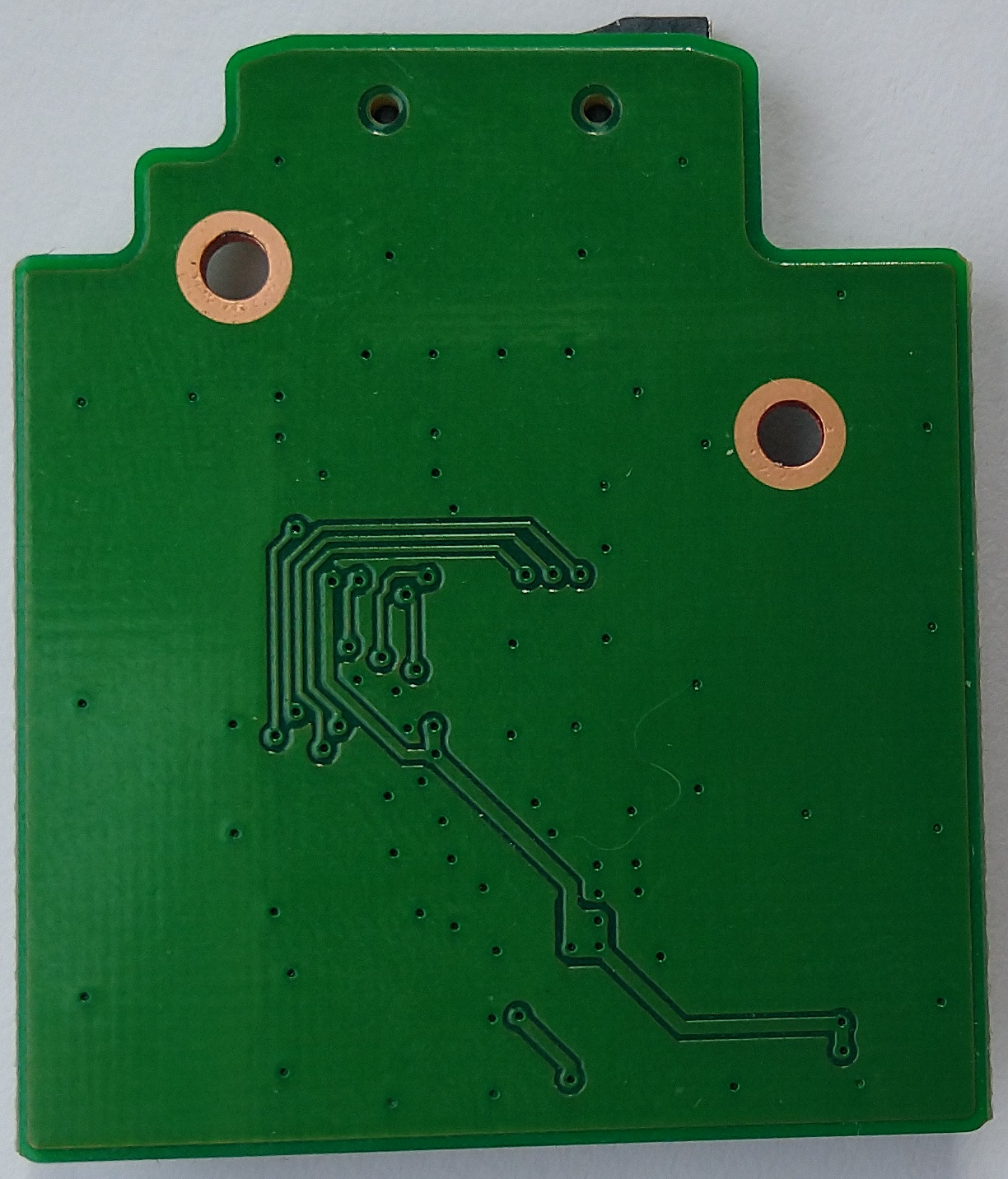

Some pictures:
UART and boot log:

Now we can use https://hexed.it/ to extract rootfs partion from 0x000000380000 till 0x000000c80000 to rootfs.bin
and extract filesystem with
binwalk -e rootfs.bin

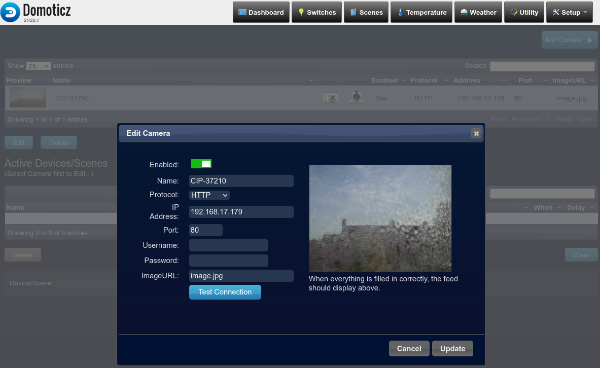

And then the big question: How were you able to connect the camera to Domoticz?
metsys
Joined: Friday 22 July 2022 11:18
Domoticz version: 2022.1
Re: Smartwares CIP-39218AT Ethernet + WiFi fisheye
Post by metsys »
waltervl wrote: Tuesday 18 October 2022 22:53 And then the big question: How were you able to connect the camera to Domoticz?
"Stream video" also works good
I apologize for the picture - my window is fogged up
