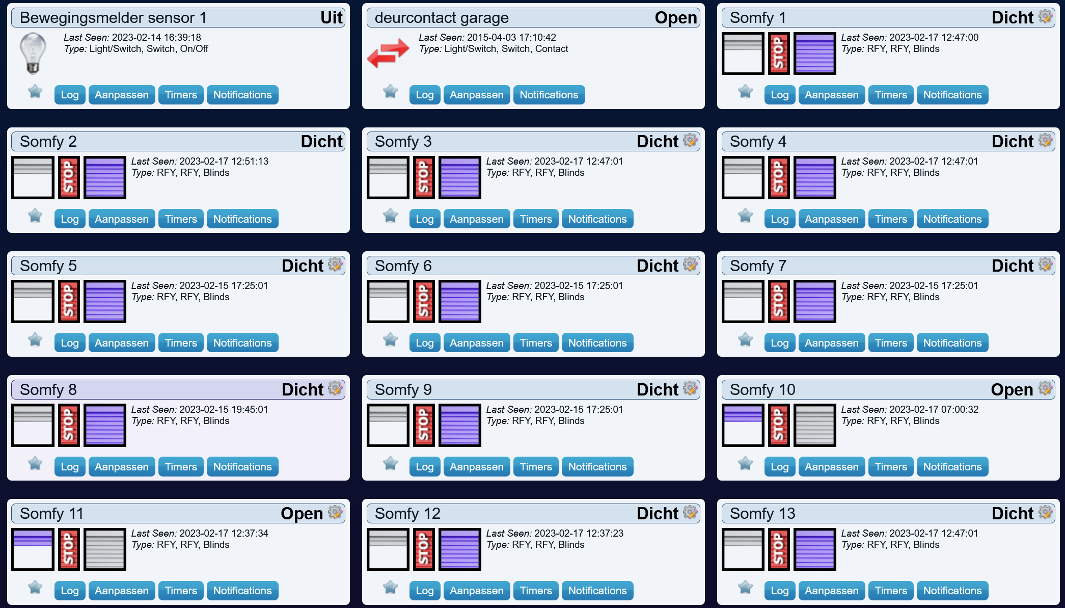

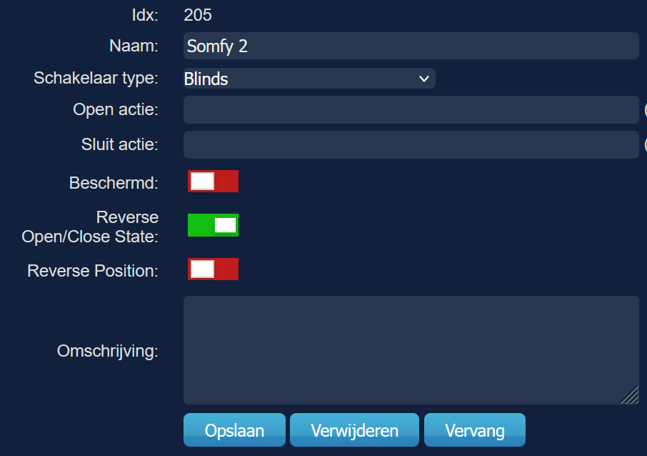

The reverse state of the blinds is not implemented completly or correctly (Solved by workaround)
Version : 2023.1, updated from 2022.1
Platform : Raspian Buster
Hardware : Raspberry Pi 3B+, RFXcomm Somfy RTS blinds
After I performed an update of Domoticz from 2022.1 it became clear that current stable was 2023.1.
It was a surprise to see that after over 6 years the action of the blinds has been reversed so i changed it as instructed for al 13 of my blinds and that worked again on the timers.
Only the state of the blinds showing no longer was correct. When it was sent to open the state showed it was closed en when the blinds were closed is showed as opened. Also clicking on "open" results in the blind closing and viceversa

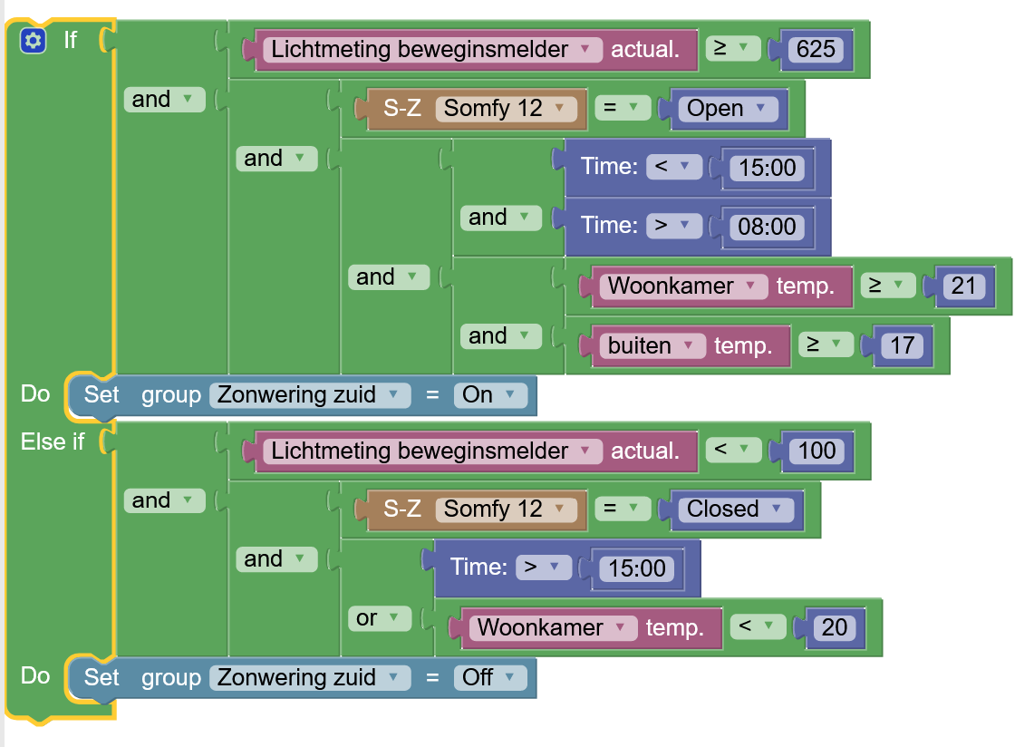

And not only that, I also get the wrong state in the blockly scripts so when a schript that checks outside and inside temperature together with the amount of light and the state of the blind(s) it gets the information the blind is closed while in fact it is open.
Result is that the blinds won't close and the sun is shining in and heating up the room. For now that's good and wanted but over the warmer months ahead that's not what it is programmed for.

Did you try to switch reverse STATE instead of reverse POSITION?
That should fix open/close switch inverting.

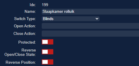

If i change the STATE, it changes to a Closed icon while the blind is open. Lookslike a POSITION change...
If i change the POSITION, nothing changes.
If i close the blind, it shows an OPEN command in the logs and vice versa but the Open/Close position is correct. I would think that you only need to change the STATE and not the POSITION as the position is correct but that seems incorrect.
In my case the commands in the log are reversed. This also !@#$ up the scripts for open window protection.
Something is off...

As the logic has been changed you also need to change your scripts.
