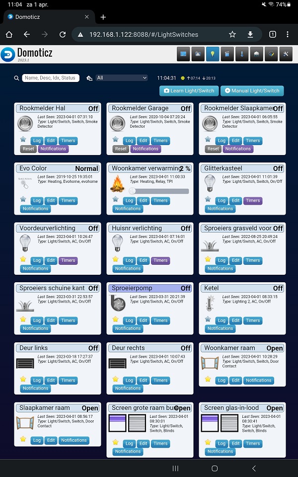

If i open Chrome (fully updated to latest (Android) versions) and load the Domoticz internal site, everything is oke as it loads the mobile site. Due to some long device names, it doesnt look that good, see picture named 'notnice' attached.

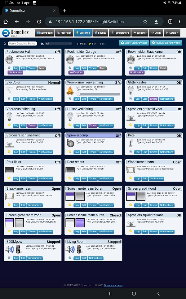

Easy solution is to set Chrome to Desktop Mode via the Chrome settings as it will load the Desktop website which looks alot better, see picture named 'nice' attached.
The problem with the Desktop Mode website on the tablet is that is does not respond when trying to turn on a device. There is no switch command in the Domoticz log and the light icon isnt turning on (using the light device as example). Switching back to Mobile mode makes it works directly.

- Mobile site
- notnice.jpg (222.19 KiB) Viewed 2771 times
- Desktop site - preferred
- nice.jpg (226.33 KiB) Viewed 2771 times

After trying alot of other things, i found out that clicking 1cm left of the icon does switch the device. It still isnt 100% of the time, but alot better than first.
Could there be a misalignment of the hit/clickboxes on Desktop Mode because on mobile and laptop, i click on the icon instead of next to it
