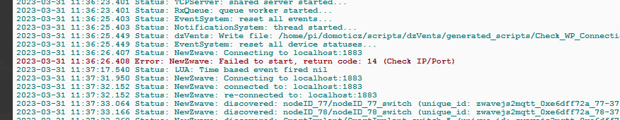

I have installed mosquitto and zwave-js-ui both in a separate docker container. This is running fine. I only have an issue after a reboot or cold startup I have an error in domoticz that is cannot connect to the MQTT auto discovery broker.
So it manage to get connected after some delay. But any idea how to solve this ? If I do a restart of only domoticz this error does not appear. I suspect some service is not ready yet?
I tried to start domoticz as last service, as maybe the docker containers did not finish yet but no luck.
In the hardware setup I have tried localhost or 127.0.0.1

I'm running zwave-js-ui in docker, however Mosquitto as a service. This combination works very well, also after restart of Raspi.
Here is an excellent Tutorial to install Mosquitto on Raspi as service, which worked well for me:
https://randomnerdtutorials.com/how-to- ... pberry-pi/
