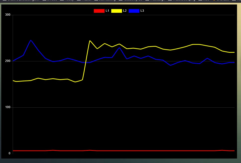

Re: Show P1 meter as hartbeat line?
Hi Lokonli,
it is working perfectly.
Two more question, (for me as a newbie not quite clear
) I have what I call three energy-groups (drie fasen), which are L1, L2 and L3.
Can these be combined, to one line?
And it is possible to change the font size for the y-axis and title?
Already found this answer for the font size: viewtopic.php?t=37799
Regards, and thanks for the help.
Peter
Peter
