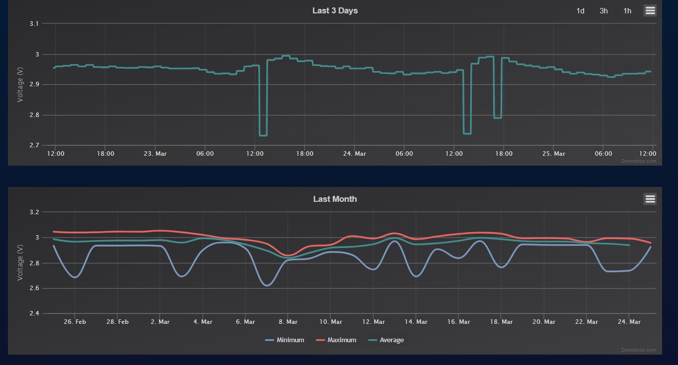

Could it be that your sensor is a Xiaomi GZCGQ01LM light intensity sensor?
I have 3 of them, and all of them have the same behaviour. Almost every day the battery level drops to 0, causing Domoticz to report a low battery level.
The battery level of these devices in zigbee2mqtt is not reliable as it jumps up and down. I just ignore it.

Sorry I missed your reply from a while back, yes indeed mine are the Xiaomi GZCGQ01LM light intensity sensors, I have 2 off them and they both perform the same, what would be good would be if you could set Domoticz so that the battery had to be below a set point at least 3 times in a certain period before getting an alert. None of my other Xiaomi devices have this problem, in fact my door and window sensors seem to go forever on one battery!
