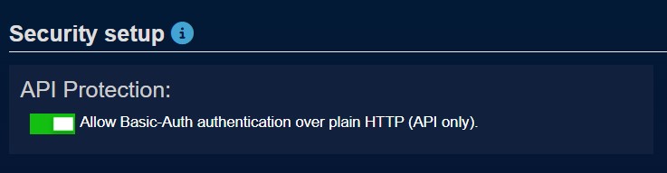

If you have a recent Domoticz version you have to use Dashticz v3.10.1 Beta (or higher), because of the new authentication mechanism in Domoticz.
To switch to the beta branch type:
git checkout beta
git pull
Further, in Domoticz you have to switch on 'Allow Basic Auth on plain HTTP' in the Domoticz settings->security tab
security tab.jpg (18.33 KiB) Viewed 707 times

I went to my Dashticz directory and executed "git checkout beta" and "git pull". I also switched on the API Protection. It still doesn't work, either with or without the user credentials. I also changed loginEnabled and the Domoticz IP to https://192.168.1.162:443. Nothing works. What's going wrong?
