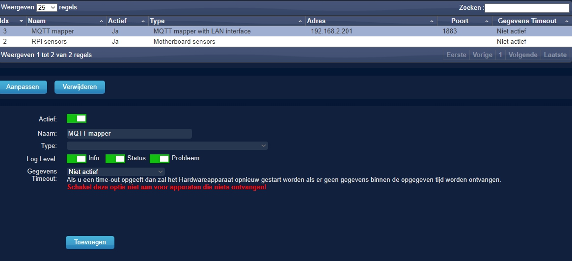

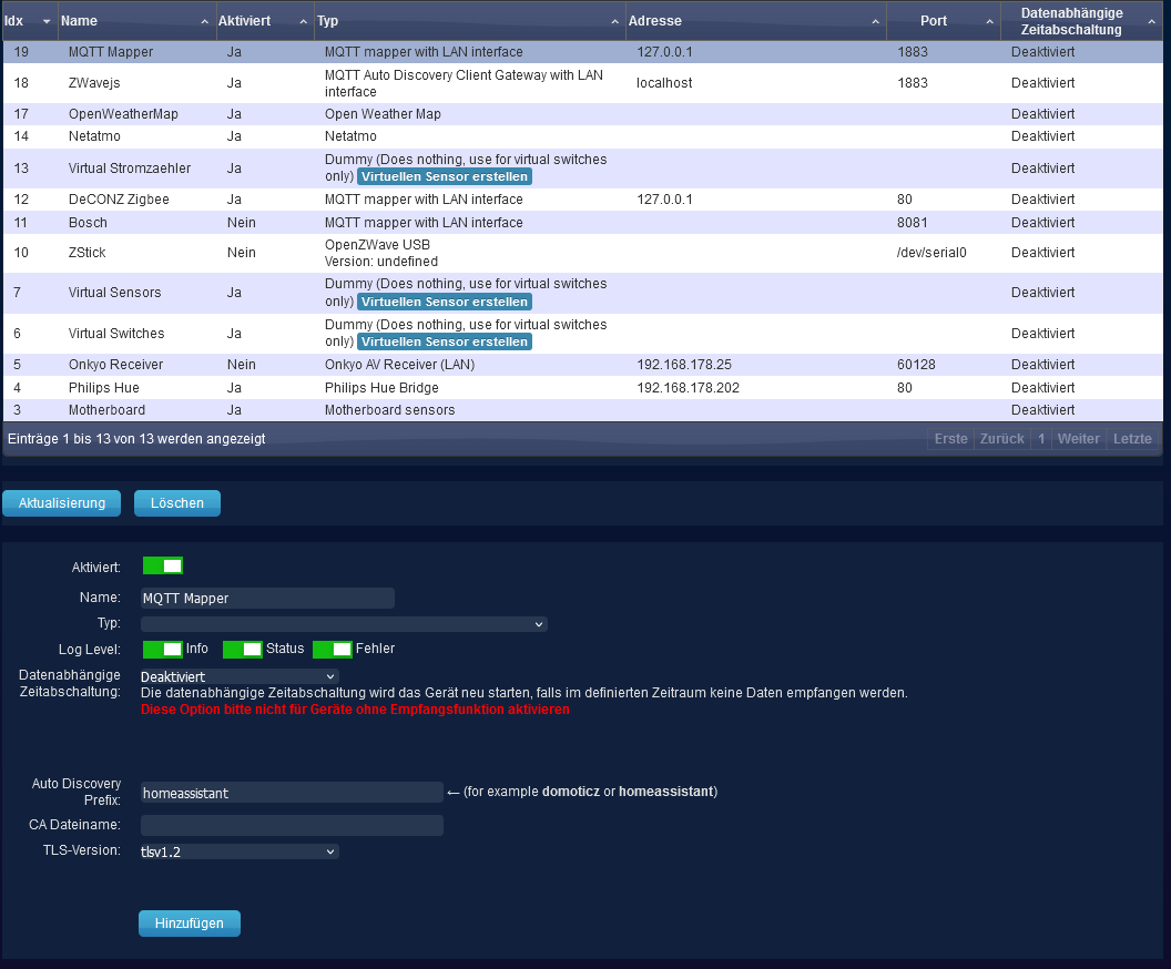

1. All my plugins now changed the type to MQTT Mapper as I tried to add the hardware...
See IDX 11 and 12.
For now they are working still as expected, but I cannot change any settings now. Also when I click on MQTT Mapper the Hardware type is not selected. I can only change setting when I'm deleting the hardware and add again.
There seems to be something completely gone wrong.

Concerning bad naming of plug-in that are not MqttMapper (lines 11 and 12), I gave all my knowledge with Domoticz restart. If this persists, this is probably a Domoticz bug... Could you try removing MqttMapper and see what happens to lines 11 & 12? Are they taking name of last plug-in?

I investigated a bit more. When I delete the MqttMapper plugin folder inside the domoticz/plugins directory the DeCONZ plugin (or the display) looks as it should. But even when I clone the folder from github again, without adding the MqttMapper hardware it changes.FlyingDomotic wrote: Monday 20 March 2023 23:32 Concerning bad naming of plug-in that are not MqttMapper (lines 11 and 12), I gave all my knowledge with Domoticz restart. If this persists, this is probably a Domoticz bug... Could you try removing MqttMapper and see what happens to lines 11 & 12? Are they taking name of last plug-in?
- I tried also to clone the folder with a different name - Mqtt_Mapper, but it changes also the DeCONZ hardware entry.
- I tried with a different plugin (PP-Manager). When I clone this folder nothing happens to the DeCONZ hardware entry.
I'm running the newest version 2023.1 - Python Version: 3.7.3
I will open a bug report in the forum section.

Hencor wrote: Tuesday 21 March 2023 15:08 I faced some issues when I played around with the MqttMapper plugin.
Domoticz version 2023.1 stable - Python Version: 3.7.3
Issue:
The typ of my other python plugins changed to MqttMapper and the settings aren't available. (DeCONZ - idx 12 and Home Connect - idx 11)
The settings from the Mqtt Mapper hardware itself are also not available. I can only change settings when I remove and add the hardware again.
Also activation or deactivation is not possible anymore.
Attempts to solve the problem:
1. Removed the Mqtt Mapper Hardware - no success
2. Did a full database restore - no success
3. 1. + removed the Mqtt Mapper plugin folder - success. The deconz plugin name and settings are available as expected
But after clone the Mqtt Mapper plugin from github the problem reappears.
I also tried to clone another plugin (PP-Manager) for testing but there the problem did not appear
My problem was also discussed in the plugin thread: viewtopic.php?t=39279&start=20

WBeulink
- Posts: 28
- Joined: Monday 21 December 2020 18:29
- Domoticz version: 2024.7
Re: Python Plugin: MqttMapper
Domoticz: Version: latest stable
RPi4, Bullseye
Plugin version from today: 29-06-2023
Very interested in plugin but can't get it working.
If I add the plugin in hardware in Domoticz and come back to check settings chosen hardware field (Type: ) is empty!
Part of config is lost.
See attachment.
Willem
RPi4, Bullseye
See attachment.
Willem
- screenshot.2.jpg (31.63 KiB) Viewed 4554 times
- screenshot.1.jpg (182.71 KiB) Viewed 4556 times
