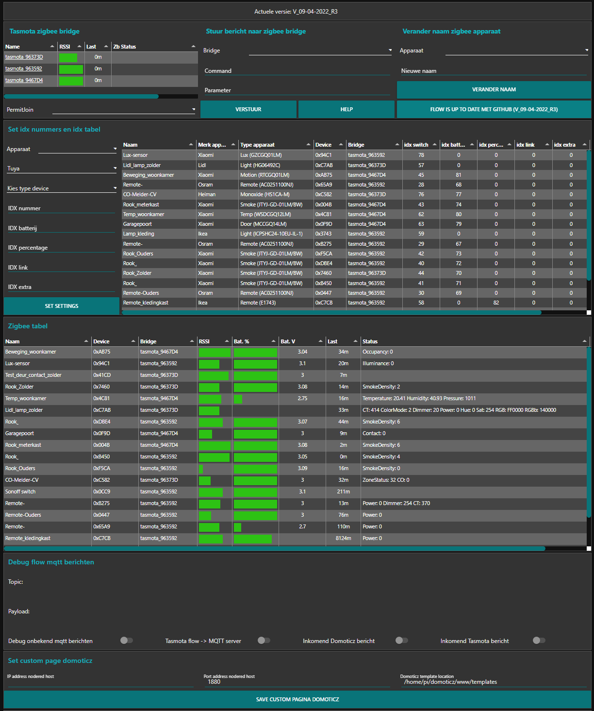

The main page.

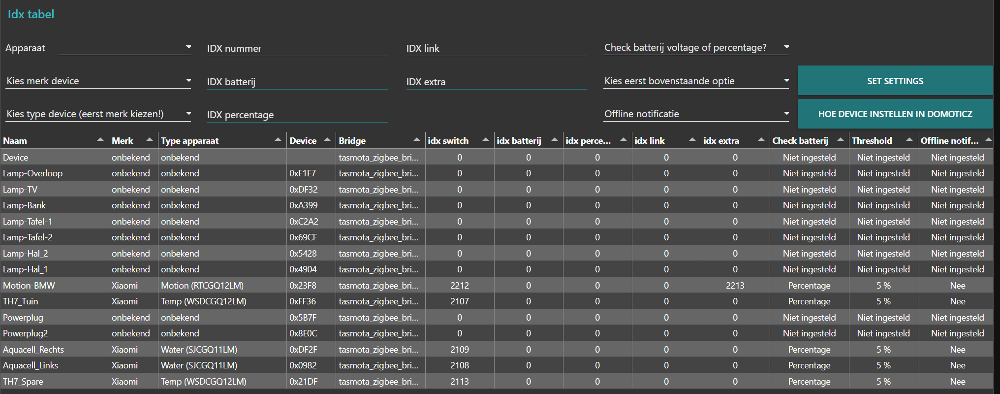

On left top, the tasmota devices (could also be other tasmota devices, i left this open, maybe fo future things)
On middle top, you could let the bridge send messages.
On right top, rename the devices
In the middle left, on the left you can set the idx numbers and the device type
in the middle right, the device table with the values which are setup by the user
On the bottom, The realtime status of your devices and some debug add-ons
Once every 24 hours there is a check to my github page, to see if there is an update.
Update could be new devices, bugs fixes or other features
In one of the latest versions i added the option, that you could add the nodered webpage to domoticz.

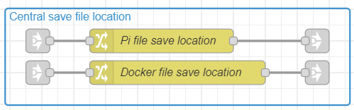

10-01-2023 R1:
- Change: Flow changed, save data folder can be changed in 1 node and not in multi nodes
25-12-2022 R1:
- Change: Flow changed, mqtt server credentials can be changed in 1 node and not in multi nodes

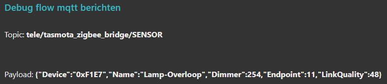

This is how the messages from the bridge have to look like (tasmota messages).
If they don't look like this, then the flow doesn't work.
tasmota message.png (15.11 KiB) Viewed 2791 times

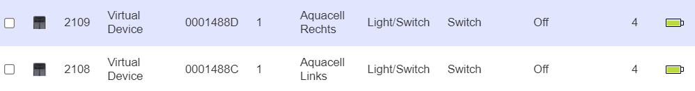

So for the documentation ;-) and the rest of the people that modified the TASMOTA ZIGBEE SETTINGS ;-) I mentioned it.
So it now created this

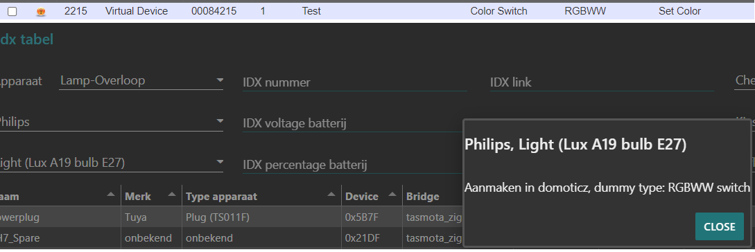

Would you be so kind to explain
- Do I really need a separate IDX for battery ?
- Can IDX Percentage and Switch be the same ? (A light can dim and do on/off)
I would like to add the Philips HUE lights ;-) and some NEO Tuya Powerplugs
Any Guidance in how to do that ?
https://www.zigbee2mqtt.io/devices/TS011F_plug_1.html
Is the on i want to help adding :)
AND similar lights.
https://www.zigbee2mqtt.io/devices/433714.html

sincze wrote: Sunday 12 March 2023 20:35 So for the documentation ;-) and the rest of the people that modified the TASMOTA ZIGBEE SETTINGS ;-) I mentioned it.
I added on top of the UI page, that those 2 settings also have to be set at 0, just like the SetOption83 which is written.
You can leave it at 0, then nothing will happen.
It is made, that it needs its own IDX
If it is possible to add battery to a dummy switch device, for example, please post a link how to do this.
Untill now i haven't found information, that this is possible with dummies
Documentation is not made for this. The percentage is also for the battery, not for a light.
Most battery devices give a voltage and a percentage value. You can choose which to use.
When you setup the dummy with the correct sensor type, then the ON/OFF and dim should work, with the same idx number

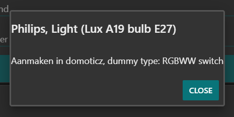

I never made a manual how to do this. This is because you need to modify 5 nodes which are all over the flow, to add just 1 device.
If you want a new brand, then there are more changes needed.
But i can help and you can test it.
Connect the device to you tasmota bridge.
Make all possible state changes and copy the data out of the tasmota console and post it here. Please add the brand/device name, for documentation. Then i will try to add these and you can test them. Maybe it is also a good start, to start with the manual how to add things
Just 1 example of the message from tasmota, which is needed
21:33:00.855 MQT: tele/tasmota_96373D/SENSOR = {"ZbReceived":{"0xC582":{"Device":"0xC582","Name":"CO-Melder-CV","ZoneStatus":32,"CO":0,"Endpoint":1,"LinkQuality":26}}}
Let me start collecting these values ;-)
PHILIPS LIGHTS
(https://www.zigbee2mqtt.io/devices/046677578138.html)
Example for On / Off / Dim
zbsend {"device":"Lamp-Overloop","send":{"power":true}}
{"ZbReceived":{"0xF1E7":{"Device":"0xF1E7","Name":"Lamp-Overloop","Power":1,"Endpoint":11,"LinkQuality":45}}}
zbsend {"device":"Lamp-Overloop","send":{"power":false}}
{"ZbReceived":{"0xF1E7":{"Device":"0xF1E7","Name":"Lamp-Overloop","Power":0,"Endpoint":11,"LinkQuality":58}}}
zbsend {"device":"Lamp-Overloop","send":{"dimmer":50}}
{"ZbReceived":{"0xF1E7":{"Device":"0xF1E7","Name":"Lamp-Overloop","Dimmer":50,"Power":1,"Endpoint":11,"LinkQuality":45}}}
{"ZbReceived":{"0xF1E7":{"Device":"0xF1E7","Name":"Lamp-Overloop","Dimmer":254,"Endpoint":11,"LinkQuality":50}}}

hyeronimo wrote: Tuesday 14 March 2023 7:44 However it seems unable to find the save directory (I created it by hand) . Any ideas on how to fix this?
Because you have written, that it is created by hand.
Is it the same as in the nodes from "Central save file location"?
If yes, does the folder have the correct writting/reading rights?
If no, change the location in the node to the correct location (choose the correct one, pi or docker)

Please find attached my Settings for Philips.
No response from this virtual Sensor.

The lights need work, first have to investigate what is going wrong.
