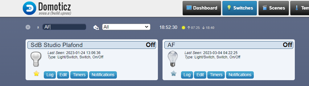

new test,
as it was working on my prod env with
Version: 2022.2 (build 15022)
Build Hash: af4316cb7
Compile Date: 2023-02-03 16:33:14
Screenshot 2023-03-05 185237.png (52.15 KiB) Viewed 1122 times

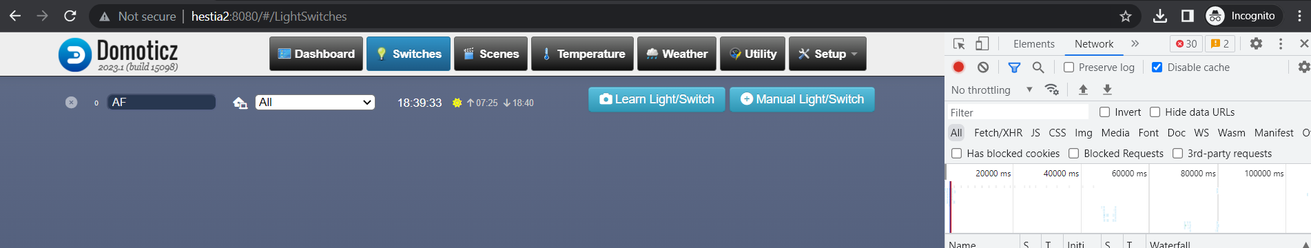

I've exported the DB and imported the DB to the test env with
Version: 2023.1 (build 15098)
Build Hash: 867c4e8fa
Compile Date: 2023-02-24 07:56:50
And it didn't work
Screenshot 2023-03-05 183939.png (92.53 KiB) Viewed 1122 times
The AF device is not visible
It seems there was a change between both versions...
