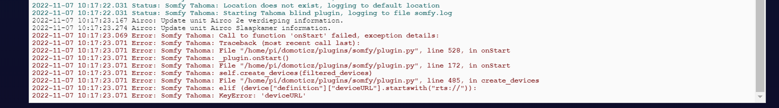

Local:
somfy plugin.png (106.91 KiB) Viewed 9849 times

Can you post the log picture as text (between Code brackets)
2022-11-07 20_24_08-Domoticz - Post a reply.png (5.82 KiB) Viewed 9808 times
The screenshots are unreadable

madpatrick wrote: Monday 07 November 2022 20:25 Can you post the log picture as text (between Code brackets)
The screenshots look just fine?
Have to re-add first before the log comes up again.

edit: this is the log with the web setting:
2022-11-08 10:53:47.058 Error: Somfy Tahoma: Call to function 'onStart' failed, exception details:
2022-11-08 10:53:47.060 Error: Somfy Tahoma: Traceback (most recent call last):
2022-11-08 10:53:47.060 Error: Somfy Tahoma: File "/home/pi/domoticz/plugins/somfy/plugin.py", line 528, in onStart
2022-11-08 10:53:47.060 Error: Somfy Tahoma: _plugin.onStart()
2022-11-08 10:53:47.060 Error: Somfy Tahoma: File "/home/pi/domoticz/plugins/somfy/plugin.py", line 172, in onStart
2022-11-08 10:53:47.060 Error: Somfy Tahoma: self.create_devices(filtered_devices)
2022-11-08 10:53:47.060 Error: Somfy Tahoma: File "/home/pi/domoticz/plugins/somfy/plugin.py", line 485, in create_devices
2022-11-08 10:53:47.060 Error: Somfy Tahoma: elif (device["definition"]["deviceURL"].startswith("rts://")):
2022-11-08 10:53:47.060 Error: Somfy Tahoma: KeyError: 'deviceURL'

2022-11-08 10:56:09,000 - DEBUG    - utils.py           - filter_devices: Device name: Slaapkamer Device class: MusicPlayer
2022-11-08 10:56:09,000 - DEBUG    - utils.py           - unsupported device found: {'creationTime': 1659469549000, 'lastUpdateTime': 1659469549000, 'label': 'Slaapkamer', 'deviceURL': 'ogp://2017-8871-5701/46E58D76', 'shortcut': False, 'controllableName': 'ogp:AudioPlayer', 'definition': {'commands': [{'commandName': 'mute', 'nparams': 0}, {'commandName': 'setVolume', 'nparams': 1}, {'commandName': 'unmute', 'nparams': 0}], 'states': [{'type': 'DiscreteState', 'values': ['available', 'unavailable'], 'qualifiedName': 'core:AvailabilityState'}, {'type': 'DataState', 'qualifiedName': 'core:MuteState'}, {'type': 'DataState', 'qualifiedName': 'core:NameState'}, {'type': 'DataState', 'qualifiedName': 'core:RemovableState'}, {'type': 'DataState', 'qualifiedName': 'core:VolumeLevelState'}], 'dataProperties': [], 'widgetName': 'DynamicAudioPlayer', 'uiProfiles': ['VolumeControl'], 'uiClass': 'MusicPlayer', 'qualifiedName': 'ogp:AudioPlayer', 'type': 'ACTUATOR'}, 'states': [{'name': 'core:NameState', 'type': 3, 'value': 'Slaapkamer'}, {'name': 'core:AvailabilityState', 'type': 3, 'value': 'available'}, {'name': 'core:RemovableState', 'type': 6, 'value': False}, {'name': 'core:VolumeLevelState', 'type': 1, 'value': 8}, {'name': 'core:MuteState', 'type': 6, 'value': False}], 'attributes': [{'name': 'core:SerialNumber', 'type': 3, 'value': '54-2A-1B-84-84-4A:8'}, {'name': 'core:ManufacturerReference', 'type': 3, 'value': 'S14'}, {'name': 'core:Manufacturer', 'type': 3, 'value': 'Sonos'}, {'name': 'ogp:Features', 'type': 10, 'value': [{'name': 'identification', 'commandLess': True}, {'name': 'volumeControl'}]}, {'name': 'core:Technology', 'type': 3, 'value': 'Sonos'}], 'available': True, 'enabled': True, 'placeOID': '5e6ed1c9-72cd-4c4f-9e4e-20c837f68475', 'widget': 'DynamicAudioPlayer', 'type': 1, 'oid': 'f1120332-645e-4c03-9e63-1f2400ce4a78', 'uiClass': 'MusicPlayer'}
2022-11-08 10:56:09,001 - DEBUG    - utils.py           - filter_devices: Device name: Slaapkamer Device class: MusicPlayer
2022-11-08 10:56:09,001 - DEBUG    - utils.py           - unsupported device found: {'creationTime': 1664606684000, 'lastUpdateTime': 1664606684000, 'label': 'Slaapkamer', 'deviceURL': 'ogp://2017-8871-5701/59717257', 'shortcut': False, 'controllableName': 'ogp:AudioPlayer', 'definition': {'commands': [{'commandName': 'activateOption', 'nparams': 1}, {'commandName': 'deactivateOption', 'nparams': 1}, {'commandName': 'fastBackward', 'nparams': 1}, {'commandName': 'fastForward', 'nparams': 1}, {'commandName': 'getMediaElements', 'nparams': 0}, {'commandName': 'mute', 'nparams': 0}, {'commandName': 'next', 'nparams': 0}, {'commandName': 'pause', 'nparams': 0}, {'commandName': 'previous', 'nparams': 0}, {'commandName': 'resume', 'nparams': 0}, {'commandName': 'setMediaElement', 'nparams': 1}, {'commandName': 'setTimelinePosition', 'nparams': 1}, {'commandName': 'setVolume', 'nparams': 1}, {'commandName': 'start', 'nparams': 0}, {'commandName': 'unmute', 'nparams': 0}], 'states': [{'type': 'DataState', 'qualifiedName': 'core:ActivatedOptionsState'}, {'type': 'DiscreteState', 'values': ['available', 'unavailable'], 'qualifiedName': 'core:AvailabilityState'}, {'type': 'DataState', 'qualifiedName': 'core:AvailableOptionsState'}, {'type': 'DataState', 'qualifiedName': 'core:GroupMembersState'}, {'type': 'DataState', 'qualifiedName': 'core:HasNextState'}, {'type': 'DataState', 'qualifiedName': 'core:HasPreviousState'}, {'type': 'DataState', 'qualifiedName': 'core:MediaElementState'}, {'type': 'DataState', 'qualifiedName': 'core:MuteState'}, {'type': 'DataState', 'qualifiedName': 'core:NameState'}, {'type': 'DataState', 'qualifiedName': 'core:PausedState'}, {'type': 'DataState', 'qualifiedName': 'core:RecommendedOptionsState'}, {'type': 'DataState', 'qualifiedName': 'core:RemovableState'}, {'type': 'DiscreteState', 'values': ['started', 'stopped'], 'qualifiedName': 'core:StartedStoppedState'}, {'type': 'DataState', 'qualifiedName': 'core:TimelineDurationState'}, {'type': 'DataState', 'qualifiedName': 'core:TimelinePositionState'}, {'type': 'DataState', 'qualifiedName': 'core:VolumeLevelState'}], 'dataProperties': [], 'widgetName': 'DynamicAudioPlayer', 'uiProfiles': ['VolumeControl', 'StatefulStartable', 'Startable'], 'uiClass': 'MusicPlayer', 'qualifiedName': 'ogp:AudioPlayer', 'type': 'ACTUATOR'}, 'states': [{'name': 'core:NameState', 'type': 3, 'value': 'Slaapkamer'}, {'name': 'core:AvailabilityState', 'type': 3, 'value': 'available'}, {'name': 'core:RemovableState', 'type': 6, 'value': False}, {'name': 'core:StartedStoppedState', 'type': 3, 'value': 'started'}, {'name': 'core:PausedState', 'type': 6, 'value': False}, {'name': 'core:VolumeLevelState', 'type': 1, 'value': 12}, {'name': 'core:MuteState', 'type': 6, 'value': False}, {'name': 'core:HasNextState', 'type': 6, 'value': False}, {'name': 'core:HasPreviousState', 'type': 6, 'value': False}, {'name': 'core:GroupMembersState', 'type': 10, 'value': ['ogp://2017-8871-5701/46E58D76']}, {'name': 'core:TimelinePositionState', 'type': 1, 'value': 1, 'lastUpdateTime': 1666506413000}, {'name': 'core:MediaElementState', 'type': 11, 'value': {'type': 'radio', 'metadata': {'explicit': False, 'service': 'Sonos Radio'}, 'name': 'Arrow Classic Rock'}}], 'attributes': [{'name': 'core:Technology', 'type': 3, 'value': 'Sonos'}, {'name': 'ogp:Features', 'type': 10, 'value': [{'name': 'identification', 'commandLess': True}, {'name': 'group', 'commandLess': True}, {'name': 'volumeControl'}, {'name': 'nextPrevious'}, {'name': 'pauseResume'}, {'name': 'start'}, {'name': 'optionControl'}, {'name': 'timelineControl'}, {'name': 'media'}]}, {'name': 'core:Manufacturer', 'type': 3, 'value': 'Sonos'}, {'name': 'core:SupportedOptions', 'type': 10, 'value': ['repeat', 'repeatOne', 'shuffle', 'crossfade']}, {'name': 'core:ManufacturerReference', 'type': 3, 'value': 'Sonos Group'}], 'available': True, 'enabled': True, 'placeOID': '5e6ed1c9-72cd-4c4f-9e4e-20c837f68475', 'widget': 'DynamicAudioPlayer', 'type': 1, 'oid': 'decd2336-8f1c-40e1-a496-4405a03796b4', 'uiClass': 'MusicPlayer'}
2022-11-08 10:56:09,002 - DEBUG    - utils.py           - filter_devices: Device name: Badkamer Device class: MusicPlayer
2022-11-08 10:56:09,002 - DEBUG    - utils.py           - unsupported device found: {'creationTime': 1666186662000, 'lastUpdateTime': 1666186662000, 'label': 'Badkamer', 'deviceURL': 'ogp://2017-8871-5701/76F0061A', 'shortcut': False, 'controllableName': 'ogp:AudioPlayer', 'definition': {'commands': [{'commandName': 'activateOption', 'nparams': 1}, {'commandName': 'deactivateOption', 'nparams': 1}, {'commandName': 'fastBackward', 'nparams': 1}, {'commandName': 'fastForward', 'nparams': 1}, {'commandName': 'getMediaElements', 'nparams': 0}, {'commandName': 'mute', 'nparams': 0}, {'commandName': 'next', 'nparams': 0}, {'commandName': 'pause', 'nparams': 0}, {'commandName': 'previous', 'nparams': 0}, {'commandName': 'resume', 'nparams': 0}, {'commandName': 'setMediaElement', 'nparams': 1}, {'commandName': 'setTimelinePosition', 'nparams': 1}, {'commandName': 'setVolume', 'nparams': 1}, {'commandName': 'start', 'nparams': 0}, {'commandName': 'unmute', 'nparams': 0}], 'states': [{'type': 'DataState', 'qualifiedName': 'core:ActivatedOptionsState'}, {'type': 'DiscreteState', 'values': ['available', 'unavailable'], 'qualifiedName': 'core:AvailabilityState'}, {'type': 'DataState', 'qualifiedName': 'core:AvailableOptionsState'}, {'type': 'DataState', 'qualifiedName': 'core:GroupMembersState'}, {'type': 'DataState', 'qualifiedName': 'core:HasNextState'}, {'type': 'DataState', 'qualifiedName': 'core:HasPreviousState'}, {'type': 'DataState', 'qualifiedName': 'core:MediaElementState'}, {'type': 'DataState', 'qualifiedName': 'core:MuteState'}, {'type': 'DataState', 'qualifiedName': 'core:NameState'}, {'type': 'DataState', 'qualifiedName': 'core:PausedState'}, {'type': 'DataState', 'qualifiedName': 'core:RecommendedOptionsState'}, {'type': 'DataState', 'qualifiedName': 'core:RemovableState'}, {'type': 'DiscreteState', 'values': ['started', 'stopped'], 'qualifiedName': 'core:StartedStoppedState'}, {'type': 'DataState', 'qualifiedName': 'core:TimelineDurationState'}, {'type': 'DataState', 'qualifiedName': 'core:TimelinePositionState'}, {'type': 'DataState', 'qualifiedName': 'core:VolumeLevelState'}], 'dataProperties': [], 'widgetName': 'DynamicAudioPlayer', 'uiProfiles': ['VolumeControl', 'StatefulStartable', 'Startable'], 'uiClass': 'MusicPlayer', 'qualifiedName': 'ogp:AudioPlayer', 'type': 'ACTUATOR'}, 'states': [{'name': 'core:NameState', 'type': 3, 'value': 'Badkamer'}, {'name': 'core:AvailabilityState', 'type': 3, 'value': 'unavailable'}, {'name': 'core:RemovableState', 'type': 6, 'value': True}, {'name': 'core:GroupMembersState', 'type': 10, 'value': ['ogp://2017-8871-5701/893321BC']}], 'attributes': [{'name': 'core:Technology', 'type': 3, 'value': 'Sonos'}, {'name': 'core:SupportedOptions', 'type': 10, 'value': ['repeat', 'repeatOne', 'shuffle', 'crossfade']}, {'name': 'core:Manufacturer', 'type': 3, 'value': 'Sonos'}, {'name': 'ogp:Features', 'type': 10, 'value': [{'name': 'identification', 'commandLess': True}, {'name': 'group', 'commandLess': True}, {'name': 'volumeControl'}, {'name': 'nextPrevious'}, {'name': 'pauseResume'}, {'name': 'start'}, {'name': 'optionControl'}, {'name': 'timelineControl'}, {'name': 'media'}]}, {'name': 'core:ManufacturerReference', 'type': 3, 'value': 'Sonos Group'}], 'available': False, 'enabled': True, 'placeOID': '5e6ed1c9-72cd-4c4f-9e4e-20c837f68475', 'widget': 'DynamicAudioPlayer', 'type': 1, 'oid': '7c7f6214-f3a8-48fc-ac66-94289697199b', 'uiClass': 'MusicPlayer'}
2022-11-08 10:56:09,003 - DEBUG    - utils.py           - filter_devices: Device name: Garage Device class: MusicPlayer
2022-11-08 10:56:09,003 - DEBUG    - utils.py           - unsupported device found: {'creationTime': 1659469549000, 'lastUpdateTime': 1659469549000, 'label': 'Garage', 'deviceURL': 'ogp://2017-8871-5701/7F676617', 'shortcut': False, 'controllableName': 'ogp:AudioPlayer', 'definition': {'commands': [{'commandName': 'mute', 'nparams': 0}, {'commandName': 'setVolume', 'nparams': 1}, {'commandName': 'unmute', 'nparams': 0}], 'states': [{'type': 'DiscreteState', 'values': ['available', 'unavailable'], 'qualifiedName': 'core:AvailabilityState'}, {'type': 'DataState', 'qualifiedName': 'core:MuteState'}, {'type': 'DataState', 'qualifiedName': 'core:NameState'}, {'type': 'DataState', 'qualifiedName': 'core:RemovableState'}, {'type': 'DataState', 'qualifiedName': 'core:VolumeLevelState'}], 'dataProperties': [], 'widgetName': 'DynamicAudioPlayer', 'uiProfiles': ['VolumeControl'], 'uiClass': 'MusicPlayer', 'qualifiedName': 'ogp:AudioPlayer', 'type': 'ACTUATOR'}, 'states': [{'name': 'core:NameState', 'type': 3, 'value': 'Garage'}, {'name': 'core:AvailabilityState', 'type': 3, 'value': 'unavailable'}, {'name': 'core:RemovableState', 'type': 6, 'value': True}, {'name': 'core:VolumeLevelState', 'type': 1, 'value': 18}, {'name': 'core:MuteState', 'type': 6, 'value': False}], 'attributes': [{'name': 'core:Manufacturer', 'type': 3, 'value': 'Sonos'}, {'name': 'core:SerialNumber', 'type': 3, 'value': 'B8-E9-37-30-A1-86:7'}, {'name': 'core:Technology', 'type': 3, 'value': 'Sonos'}, {'name': 'core:ManufacturerReference', 'type': 3, 'value': 'S3'}, {'name': 'ogp:Features', 'type': 10, 'value': [{'name': 'identification', 'commandLess': True}, {'name': 'volumeControl'}]}], 'available': False, 'enabled': True, 'placeOID': '5e6ed1c9-72cd-4c4f-9e4e-20c837f68475', 'widget': 'DynamicAudioPlayer', 'type': 1, 'oid': 'e3913fcf-dcce-4498-a061-4e1e09e7ced8', 'uiClass': 'MusicPlayer'}
2022-11-08 10:56:09,003 - DEBUG    - utils.py           - filter_devices: Device name: Keuken Device class: MusicPlayer
2022-11-08 10:56:09,004 - DEBUG    - utils.py           - unsupported device found: {'creationTime': 1659469549000, 'lastUpdateTime': 1659469549000, 'label': 'Keuken', 'deviceURL': 'ogp://2017-8871-5701/881483BA', 'shortcut': False, 'controllableName': 'ogp:AudioPlayer', 'definition': {'commands': [{'commandName': 'mute', 'nparams': 0}, {'commandName': 'setVolume', 'nparams': 1}, {'commandName': 'unmute', 'nparams': 0}], 'states': [{'type': 'DiscreteState', 'values': ['available', 'unavailable'], 'qualifiedName': 'core:AvailabilityState'}, {'type': 'DataState', 'qualifiedName': 'core:MuteState'}, {'type': 'DataState', 'qualifiedName': 'core:NameState'}, {'type': 'DataState', 'qualifiedName': 'core:RemovableState'}, {'type': 'DataState', 'qualifiedName': 'core:VolumeLevelState'}], 'dataProperties': [], 'widgetName': 'DynamicAudioPlayer', 'uiProfiles': ['VolumeControl'], 'uiClass': 'MusicPlayer', 'qualifiedName': 'ogp:AudioPlayer', 'type': 'ACTUATOR'}, 'states': [{'name': 'core:NameState', 'type': 3, 'value': 'Keuken'}, {'name': 'core:AvailabilityState', 'type': 3, 'value': 'available'}, {'name': 'core:RemovableState', 'type': 6, 'value': False}, {'name': 'core:VolumeLevelState', 'type': 1, 'value': 12}, {'name': 'core:MuteState', 'type': 6, 'value': False}], 'attributes': [{'name': 'ogp:Features', 'type': 10, 'value': [{'name': 'identification', 'commandLess': True}, {'name': 'volumeControl'}]}, {'name': 'core:SerialNumber', 'type': 3, 'value': 'B8-E9-37-32-BE-5C:D'}, {'name': 'core:Technology', 'type': 3, 'value': 'Sonos'}, {'name': 'core:ManufacturerReference', 'type': 3, 'value': 'S3'}, {'name': 'core:Manufacturer', 'type': 3, 'value': 'Sonos'}], 'available': True, 'enabled': True, 'placeOID': '5e6ed1c9-72cd-4c4f-9e4e-20c837f68475', 'widget': 'DynamicAudioPlayer', 'type': 1, 'oid': '89d72358-3fc2-4871-b024-083af5f61b56', 'uiClass': 'MusicPlayer'}
2022-11-08 10:56:09,004 - DEBUG    - utils.py           - filter_devices: Device name: Badkamer Device class: MusicPlayer
2022-11-08 10:56:09,005 - DEBUG    - utils.py           - unsupported device found: {'creationTime': 1659469548000, 'lastUpdateTime': 1659469548000, 'label': 'Badkamer', 'deviceURL': 'ogp://2017-8871-5701/893321BC', 'shortcut': False, 'controllableName': 'ogp:AudioPlayer', 'definition': {'commands': [{'commandName': 'mute', 'nparams': 0}, {'commandName': 'setVolume', 'nparams': 1}, {'commandName': 'unmute', 'nparams': 0}], 'states': [{'type': 'DiscreteState', 'values': ['available', 'unavailable'], 'qualifiedName': 'core:AvailabilityState'}, {'type': 'DataState', 'qualifiedName': 'core:MuteState'}, {'type': 'DataState', 'qualifiedName': 'core:NameState'}, {'type': 'DataState', 'qualifiedName': 'core:RemovableState'}, {'type': 'DataState', 'qualifiedName': 'core:VolumeLevelState'}], 'dataProperties': [], 'widgetName': 'DynamicAudioPlayer', 'uiProfiles': ['VolumeControl'], 'uiClass': 'MusicPlayer', 'qualifiedName': 'ogp:AudioPlayer', 'type': 'ACTUATOR'}, 'states': [{'name': 'core:NameState', 'type': 3, 'value': 'Badkamer'}, {'name': 'core:AvailabilityState', 'type': 3, 'value': 'unavailable'}, {'name': 'core:RemovableState', 'type': 6, 'value': True}, {'name': 'core:VolumeLevelState', 'type': 1, 'value': 22}, {'name': 'core:MuteState', 'type': 6, 'value': False}], 'attributes': [{'name': 'core:SerialNumber', 'type': 3, 'value': '78-28-CA-07-26-52:6'}, {'name': 'core:Manufacturer', 'type': 3, 'value': 'Sonos'}, {'name': 'core:Technology', 'type': 3, 'value': 'Sonos'}, {'name': 'ogp:Features', 'type': 10, 'value': [{'name': 'identification', 'commandLess': True}, {'name': 'volumeControl'}]}, {'name': 'core:ManufacturerReference', 'type': 3, 'value': 'S13'}], 'available': False, 'enabled': True, 'placeOID': '5e6ed1c9-72cd-4c4f-9e4e-20c837f68475', 'widget': 'DynamicAudioPlayer', 'type': 1, 'oid': 'ebdbcb0b-0216-4c33-9478-e9309f92268b', 'uiClass': 'MusicPlayer'}
2022-11-08 10:56:09,005 - DEBUG    - utils.py           - filter_devices: Device name: Keuken Device class: MusicPlayer
2022-11-08 10:56:09,006 - DEBUG    - utils.py           - unsupported device found: {'creationTime': 1666186662000, 'lastUpdateTime': 1666186662000, 'label': 'Keuken', 'deviceURL': 'ogp://2017-8871-5701/FE754ABE', 'shortcut': False, 'controllableName': 'ogp:AudioPlayer', 'definition': {'commands': [{'commandName': 'activateOption', 'nparams': 1}, {'commandName': 'deactivateOption', 'nparams': 1}, {'commandName': 'fastBackward', 'nparams': 1}, {'commandName': 'fastForward', 'nparams': 1}, {'commandName': 'getMediaElements', 'nparams': 0}, {'commandName': 'mute', 'nparams': 0}, {'commandName': 'next', 'nparams': 0}, {'commandName': 'pause', 'nparams': 0}, {'commandName': 'previous', 'nparams': 0}, {'commandName': 'resume', 'nparams': 0}, {'commandName': 'setMediaElement', 'nparams': 1}, {'commandName': 'setTimelinePosition', 'nparams': 1}, {'commandName': 'setVolume', 'nparams': 1}, {'commandName': 'start', 'nparams': 0}, {'commandName': 'unmute', 'nparams': 0}], 'states': [{'type': 'DataState', 'qualifiedName': 'core:ActivatedOptionsState'}, {'type': 'DiscreteState', 'values': ['available', 'unavailable'], 'qualifiedName': 'core:AvailabilityState'}, {'type': 'DataState', 'qualifiedName': 'core:AvailableOptionsState'}, {'type': 'DataState', 'qualifiedName': 'core:GroupMembersState'}, {'type': 'DataState', 'qualifiedName': 'core:HasNextState'}, {'type': 'DataState', 'qualifiedName': 'core:HasPreviousState'}, {'type': 'DataState', 'qualifiedName': 'core:MediaElementState'}, {'type': 'DataState', 'qualifiedName': 'core:MuteState'}, {'type': 'DataState', 'qualifiedName': 'core:NameState'}, {'type': 'DataState', 'qualifiedName': 'core:PausedState'}, {'type': 'DataState', 'qualifiedName': 'core:RecommendedOptionsState'}, {'type': 'DataState', 'qualifiedName': 'core:RemovableState'}, {'type': 'DiscreteState', 'values': ['started', 'stopped'], 'qualifiedName': 'core:StartedStoppedState'}, {'type': 'DataState', 'qualifiedName': 'core:TimelineDurationState'}, {'type': 'DataState', 'qualifiedName': 'core:TimelinePositionState'}, {'type': 'DataState', 'qualifiedName': 'core:VolumeLevelState'}], 'dataProperties': [], 'widgetName': 'DynamicAudioPlayer', 'uiProfiles': ['VolumeControl', 'StatefulStartable', 'Startable'], 'uiClass': 'MusicPlayer', 'qualifiedName': 'ogp:AudioPlayer', 'type': 'ACTUATOR'}, 'states': [{'name': 'core:NameState', 'type': 3, 'value': 'Keuken'}, {'name': 'core:AvailabilityState', 'type': 3, 'value': 'unavailable'}, {'name': 'core:RemovableState', 'type': 6, 'value': True}, {'name': 'core:GroupMembersState', 'type': 10, 'value': ['ogp://2017-8871-5701/881483BA']}], 'attributes': [{'name': 'core:Technology', 'type': 3, 'value': 'Sonos'}, {'name': 'ogp:Features', 'type': 10, 'value': [{'name': 'identification', 'commandLess': True}, {'name': 'group', 'commandLess': True}, {'name': 'volumeControl'}, {'name': 'nextPrevious'}, {'name': 'pauseResume'}, {'name': 'start'}, {'name': 'optionControl'}, {'name': 'timelineControl'}, {'name': 'media'}]}, {'name': 'core:ManufacturerReference', 'type': 3, 'value': 'Sonos Group'}, {'name': 'core:SupportedOptions', 'type': 10, 'value': ['repeat', 'repeatOne', 'shuffle', 'crossfade']}, {'name': 'core:Manufacturer', 'type': 3, 'value': 'Sonos'}], 'available': False, 'enabled': True, 'placeOID': '5e6ed1c9-72cd-4c4f-9e4e-20c837f68475', 'widget': 'DynamicAudioPlayer', 'type': 1, 'oid': 'd6b90d4c-6c85-45c0-af2e-1708539703aa', 'uiClass': 'MusicPlayer'}
2022-11-08 10:56:09,006 - DEBUG    - utils.py           - filter_devices: Device name: Zonwering Slaapkamer Device class: ExteriorScreen
2022-11-08 10:56:09,006 - DEBUG    - utils.py           - filter_devices: type of device = <class 'dict'>
2022-11-08 10:56:09,006 - INFO     - utils.py           - supported device found: {'creationTime': 1659460463000, 'lastUpdateTime': 1659460463000, 'label': 'Zonwering Slaapkamer', 'deviceURL': 'rts://2017-8871-5701/16722109', 'shortcut': False, 'controllableName': 'rts:ExteriorBlindRTSComponent', 'definition': {'commands': [{'commandName': 'close', 'nparams': 1}, {'commandName': 'down', 'nparams': 1}, {'commandName': 'identify', 'nparams': 0}, {'commandName': 'my', 'nparams': 1}, {'commandName': 'open', 'nparams': 1}, {'commandName': 'rest', 'nparams': 1}, {'commandName': 'stop', 'nparams': 1}, {'commandName': 'test', 'nparams': 0}, {'commandName': 'up', 'nparams': 1}, {'commandName': 'openConfiguration', 'nparams': 1}], 'states': [], 'dataProperties': [{'value': '0', 'qualifiedName': 'core:identifyInterval'}], 'widgetName': 'UpDownExteriorScreen', 'uiProfiles': ['OpenCloseBlind', 'OpenClose'], 'uiClass': 'ExteriorScreen', 'qualifiedName': 'rts:ExteriorBlindRTSComponent', 'type': 'ACTUATOR'}, 'attributes': [{'name': 'rts:diy', 'type': 6, 'value': False}], 'available': True, 'enabled': True, 'placeOID': '2d1cd28c-381a-45d4-a0a1-a2aee50574bf', 'widget': 'UpDownExteriorScreen', 'type': 1, 'oid': '453faeb3-37b0-47c0-81f3-3783bca84818', 'uiClass': 'ExteriorScreen'}
2022-11-08 10:56:09,007 - DEBUG    - utils.py           - filter_devices: Device name: Zonwering woonkamer Device class: ExteriorScreen
2022-11-08 10:56:09,007 - DEBUG    - utils.py           - filter_devices: type of device = <class 'dict'>
2022-11-08 10:56:09,007 - INFO     - utils.py           - supported device found: {'creationTime': 1660132825000, 'lastUpdateTime': 1660132825000, 'label': 'Zonwering woonkamer', 'deviceURL': 'rts://2017-8871-5701/16736992', 'shortcut': False, 'controllableName': 'rts:ExteriorBlindRTSComponent', 'definition': {'commands': [{'commandName': 'close', 'nparams': 1}, {'commandName': 'down', 'nparams': 1}, {'commandName': 'identify', 'nparams': 0}, {'commandName': 'my', 'nparams': 1}, {'commandName': 'open', 'nparams': 1}, {'commandName': 'rest', 'nparams': 1}, {'commandName': 'stop', 'nparams': 1}, {'commandName': 'test', 'nparams': 0}, {'commandName': 'up', 'nparams': 1}, {'commandName': 'openConfiguration', 'nparams': 1}], 'states': [], 'dataProperties': [{'value': '0', 'qualifiedName': 'core:identifyInterval'}], 'widgetName': 'UpDownExteriorScreen', 'uiProfiles': ['OpenCloseBlind', 'OpenClose'], 'uiClass': 'ExteriorScreen', 'qualifiedName': 'rts:ExteriorBlindRTSComponent', 'type': 'ACTUATOR'}, 'attributes': [{'name': 'rts:diy', 'type': 6, 'value': False}], 'available': True, 'enabled': True, 'placeOID': '188662e2-3027-48ee-b1fc-e0cc32ee4171', 'widget': 'UpDownExteriorScreen', 'type': 1, 'oid': '67236cb9-032b-429b-85ab-beeebb645778', 'uiClass': 'ExteriorScreen'}
2022-11-08 10:56:09,008 - DEBUG    - utils.py           - filter_devices: Device name: Zonwering keuken Device class: ExteriorScreen
2022-11-08 10:56:09,008 - DEBUG    - utils.py           - filter_devices: type of device = <class 'dict'>
2022-11-08 10:56:09,008 - INFO     - utils.py           - supported device found: {'creationTime': 1660132747000, 'lastUpdateTime': 1660132747000, 'label': 'Zonwering keuken', 'deviceURL': 'rts://2017-8871-5701/16740764', 'shortcut': False, 'controllableName': 'rts:ExteriorBlindRTSComponent', 'definition': {'commands': [{'commandName': 'close', 'nparams': 1}, {'commandName': 'down', 'nparams': 1}, {'commandName': 'identify', 'nparams': 0}, {'commandName': 'my', 'nparams': 1}, {'commandName': 'open', 'nparams': 1}, {'commandName': 'rest', 'nparams': 1}, {'commandName': 'stop', 'nparams': 1}, {'commandName': 'test', 'nparams': 0}, {'commandName': 'up', 'nparams': 1}, {'commandName': 'openConfiguration', 'nparams': 1}], 'states': [], 'dataProperties': [{'value': '0', 'qualifiedName': 'core:identifyInterval'}], 'widgetName': 'UpDownExteriorScreen', 'uiProfiles': ['OpenCloseBlind', 'OpenClose'], 'uiClass': 'ExteriorScreen', 'qualifiedName': 'rts:ExteriorBlindRTSComponent', 'type': 'ACTUATOR'}, 'attributes': [{'name': 'rts:diy', 'type': 6, 'value': False}], 'available': True, 'enabled': True, 'placeOID': '6996fcc0-5bc4-456a-bddf-fd536da2fd32', 'widget': 'UpDownExteriorScreen', 'type': 1, 'oid': '51825687-4045-46a4-beb9-e1be9f43db9f', 'uiClass': 'ExteriorScreen'}
2022-11-08 10:56:09,008 - DEBUG    - utils.py           - filter_devices: Device name: Zonwering Gym Device class: ExteriorScreen
2022-11-08 10:56:09,009 - DEBUG    - utils.py           - filter_devices: type of device = <class 'dict'>
2022-11-08 10:56:09,009 - INFO     - utils.py           - supported device found: {'creationTime': 1659460529000, 'lastUpdateTime': 1659460529000, 'label': 'Zonwering Gym', 'deviceURL': 'rts://2017-8871-5701/16745695', 'shortcut': False, 'controllableName': 'rts:ExteriorBlindRTSComponent', 'definition': {'commands': [{'commandName': 'close', 'nparams': 1}, {'commandName': 'down', 'nparams': 1}, {'commandName': 'identify', 'nparams': 0}, {'commandName': 'my', 'nparams': 1}, {'commandName': 'open', 'nparams': 1}, {'commandName': 'rest', 'nparams': 1}, {'commandName': 'stop', 'nparams': 1}, {'commandName': 'test', 'nparams': 0}, {'commandName': 'up', 'nparams': 1}, {'commandName': 'openConfiguration', 'nparams': 1}], 'states': [], 'dataProperties': [{'value': '0', 'qualifiedName': 'core:identifyInterval'}], 'widgetName': 'UpDownExteriorScreen', 'uiProfiles': ['OpenCloseBlind', 'OpenClose'], 'uiClass': 'ExteriorScreen', 'qualifiedName': 'rts:ExteriorBlindRTSComponent', 'type': 'ACTUATOR'}, 'attributes': [{'name': 'rts:diy', 'type': 6, 'value': False}], 'available': True, 'enabled': True, 'placeOID': '8059f877-5104-4b02-b2fb-34370e7d71e2', 'widget': 'UpDownExteriorScreen', 'type': 1, 'oid': 'e74b23dd-7a57-4fd3-a270-dab713783669', 'uiClass': 'ExteriorScreen'}
2022-11-08 10:56:09,009 - DEBUG    - utils.py           - filter_devices: Device name: ZIGBEE (0/0) Device class: NetworkComponent
2022-11-08 10:56:09,010 - DEBUG    - utils.py           - unsupported device found: {'creationTime': 1659383565000, 'lastUpdateTime': 1659383565000, 'label': 'ZIGBEE (0/0)', 'deviceURL': 'zigbee://2017-8871-5701/0/0', 'shortcut': False, 'controllableName': 'zigbee:ZigbeeNetworkNode', 'definition': {'commands': [{'commandName': 'leaveNetwork', 'nparams': 0}, {'commandName': 'refreshBindingTable', 'nparams': 0}, {'commandName': 'refreshNeighborTable', 'nparams': 0}, {'commandName': 'refreshRoutingTable', 'nparams': 0}], 'states': [{'type': 'DiscreteState', 'values': ['available', 'unavailable'], 'qualifiedName': 'core:StatusState'}, {'type': 'DataState', 'qualifiedName': 'zigbee:BindingTableState'}, {'type': 'DataState', 'qualifiedName': 'zigbee:NeighborTableState'}, {'type': 'DataState', 'qualifiedName': 'zigbee:RoutingTableState'}], 'dataProperties': [], 'widgetName': 'ZigbeeNetwork', 'uiProfiles': ['Specific'], 'uiClass': 'NetworkComponent', 'qualifiedName': 'zigbee:ZigbeeNetworkNode', 'type': 'INFRASTRUCTURE_COMPONENT'}, 'states': [{'name': 'core:StatusState', 'type': 3, 'value': 'available'}], 'attributes': [{'name': 'core:MacAddress', 'type': 3, 'value': '6DEO/v8+ehg='}], 'available': True, 'enabled': True, 'placeOID': '5e6ed1c9-72cd-4c4f-9e4e-20c837f68475', 'widget': 'ZigbeeNetwork', 'type': 6, 'oid': '6aba2a2a-2e41-4eac-86b1-d58c1c10e5bf', 'uiClass': 'NetworkComponent'}
2022-11-08 10:56:09,010 - DEBUG    - utils.py           - filter_devices: Device name: ZIGBEE (0/1) Device class: ProtocolGateway
2022-11-08 10:56:09,010 - DEBUG    - utils.py           - unsupported device found: {'creationTime': 1659383565000, 'lastUpdateTime': 1659383565000, 'label': 'ZIGBEE (0/1)', 'deviceURL': 'zigbee://2017-8871-5701/0/1', 'shortcut': False, 'controllableName': 'zigbee:StackV3Component', 'definition': {'commands': [{'commandName': 'bindingNetwork', 'nparams': 0}, {'commandName': 'closeNetwork', 'nparams': 0}, {'commandName': 'openNetwork', 'nparams': 1}, {'commandName': 'refreshNetwork', 'nparams': 0}, {'commandName': 'bind', 'nparams': 2}, {'commandName': 'closeNetworkManagement', 'nparams': 0}, {'commandName': 'openNetworkManagement', 'nparams': 0}, {'commandName': 'openNetworkWithCommissioningManagement', 'nparams': 0}, {'commandName': 'unbind', 'nparams': 2}], 'states': [{'type': 'DiscreteState', 'values': ['good', 'low', 'normal', 'verylow'], 'qualifiedName': 'core:DiscreteRSSILevelState'}, {'type': 'DataState', 'qualifiedName': 'core:ManufacturerNameState'}, {'type': 'DataState', 'qualifiedName': 'core:ProductModelNameState'}, {'type': 'ContinuousState', 'qualifiedName': 'core:RSSILevelState'}, {'type': 'ContinuousState', 'qualifiedName': 'zigbee:LinkQualityIndicatorState'}], 'dataProperties': [], 'widgetName': 'ZigbeeStack', 'uiProfiles': ['Specific'], 'uiClass': 'ProtocolGateway', 'qualifiedName': 'zigbee:StackV3Component', 'type': 'PROTOCOL_GATEWAY'}, 'attributes': [{'name': 'core:MacAddress', 'type': 3, 'value': '6DEO/v8+ehg='}, {'name': 'zigbee:RadioChannel', 'type': 3, 'value': '20'}, {'name': 'zigbee:Role', 'type': 3, 'value': 'coordinator'}], 'available': True, 'enabled': True, 'placeOID': '5e6ed1c9-72cd-4c4f-9e4e-20c837f68475', 'widget': 'ZigbeeStack', 'type': 5, 'oid': 'fad462e5-10a0-4bc6-8630-f74a995b0243', 'uiClass': 'ProtocolGateway'}
2022-11-08 10:56:09,011 - DEBUG    - utils.py           - filter_devices: Device name: ZIGBEE (0/242) Device class: ProtocolGateway
2022-11-08 10:56:09,011 - DEBUG    - utils.py           - unsupported device found: {'creationTime': 1659383566000, 'lastUpdateTime': 1659383566000, 'label': 'ZIGBEE (0/242)', 'deviceURL': 'zigbee://2017-8871-5701/0/242', 'shortcut': False, 'controllableName': 'zigbee:StackV3Component', 'definition': {'commands': [{'commandName': 'bindingNetwork', 'nparams': 0}, {'commandName': 'closeNetwork', 'nparams': 0}, {'commandName': 'openNetwork', 'nparams': 1}, {'commandName': 'refreshNetwork', 'nparams': 0}, {'commandName': 'bind', 'nparams': 2}, {'commandName': 'closeNetworkManagement', 'nparams': 0}, {'commandName': 'openNetworkManagement', 'nparams': 0}, {'commandName': 'openNetworkWithCommissioningManagement', 'nparams': 0}, {'commandName': 'unbind', 'nparams': 2}], 'states': [{'type': 'DiscreteState', 'values': ['good', 'low', 'normal', 'verylow'], 'qualifiedName': 'core:DiscreteRSSILevelState'}, {'type': 'DataState', 'qualifiedName': 'core:ManufacturerNameState'}, {'type': 'DataState', 'qualifiedName': 'core:ProductModelNameState'}, {'type': 'ContinuousState', 'qualifiedName': 'core:RSSILevelState'}, {'type': 'ContinuousState', 'qualifiedName': 'zigbee:LinkQualityIndicatorState'}], 'dataProperties': [], 'widgetName': 'ZigbeeStack', 'uiProfiles': ['Specific'], 'uiClass': 'ProtocolGateway', 'qualifiedName': 'zigbee:StackV3Component', 'type': 'PROTOCOL_GATEWAY'}, 'attributes': [{'name': 'zigbee:RadioChannel', 'type': 3, 'value': '20'}, {'name': 'zigbee:Role', 'type': 3, 'value': 'coordinator'}, {'name': 'core:MacAddress', 'type': 3, 'value': '6DEO/v8+ehg='}], 'available': True, 'enabled': True, 'placeOID': '5e6ed1c9-72cd-4c4f-9e4e-20c837f68475', 'widget': 'ZigbeeStack', 'type': 5, 'oid': '368b4511-25a0-489d-8ea0-aa0c814439f1', 'uiClass': 'ProtocolGateway'}
2022-11-08 10:56:09,011 - DEBUG    - utils.py           - filter_devices: Device name: ZIGBEE (65535) Device class: ProtocolGateway
2022-11-08 10:56:09,012 - DEBUG    - utils.py           - unsupported device found: {'creationTime': 1659382575000, 'lastUpdateTime': 1659382575000, 'label': 'ZIGBEE (65535)', 'deviceURL': 'zigbee://2017-8871-5701/65535', 'shortcut': False, 'controllableName': 'zigbee:TransceiverV3_0Component', 'definition': {'commands': [], 'states': [], 'dataProperties': [], 'widgetName': 'ZigbeeStack', 'uiProfiles': ['Specific'], 'uiClass': 'ProtocolGateway', 'qualifiedName': 'zigbee:TransceiverV3_0Component', 'type': 'PROTOCOL_GATEWAY'}, 'available': True, 'enabled': True, 'placeOID': '5e6ed1c9-72cd-4c4f-9e4e-20c837f68475', 'widget': 'ZigbeeStack', 'type': 5, 'oid': '30ddad7c-bcf9-4efe-8bf4-528725e16aae', 'uiClass': 'ProtocolGateway'}
2022-11-08 10:56:09,012 - DEBUG    - utils.py           - finished filter devices
2022-11-08 10:56:09,013 - DEBUG    - plugin.py          - create_devices: devices found, domoticz: 3 API: 7
2022-11-08 10:56:09,013 - DEBUG    - plugin.py          - New device(s) detected
2022-11-08 10:56:09,013 - DEBUG    - plugin.py          - create_devices: check if need to create device: Verlichtingssensor achterkant
2022-11-08 10:56:09,014 - DEBUG    - plugin.py          - create_devices: step 2, do not create new device: Verlichtingssensor achterkant, device already exists
2022-11-08 10:56:09,014 - DEBUG    - plugin.py          - create_devices: check if need to create device: Zonwering Balkonraam
2022-11-08 10:56:09,014 - DEBUG    - plugin.py          - create_devices: step 2, do not create new device: Zonwering Balkonraam, device already exists
2022-11-08 10:56:09,014 - DEBUG    - plugin.py          - create_devices: check if need to create device: Zonwering Balkondeur
2022-11-08 10:56:09,014 - DEBUG    - plugin.py          - create_devices: step 2, do not create new device: Zonwering Balkondeur, device already exists
2022-11-08 10:56:09,015 - DEBUG    - plugin.py          - create_devices: check if need to create device: Zonwering Slaapkamer
2022-11-08 10:56:09,015 - DEBUG    - plugin.py          - create_devices: Must create new device: Zonwering Slaapkamer
See some unsupported devices that should be supported. For instance 'keuken'
