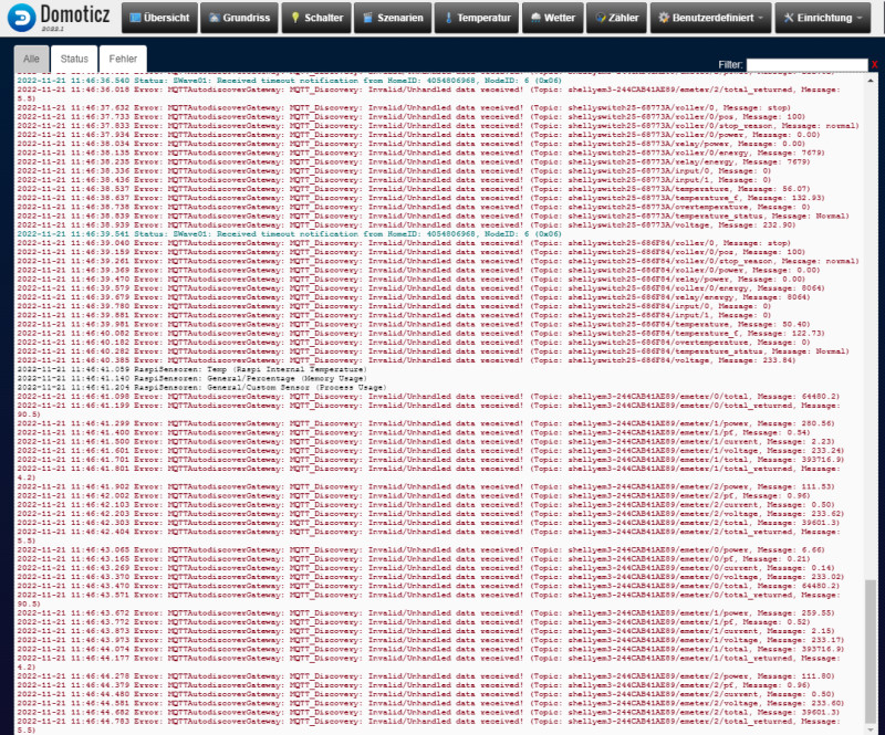

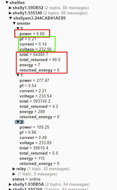

I try to use the mqtt auto detection Plugin also, but there I got very much Error Messages.mastadook wrote: ↑Wednesday 02 November 2022 14:16 Hi All,
one Question regarding this Plugin and Shelly3EM:
Will there a Power Device created automatically?
In my Setup it creates 3 Devices per Phase:
1 Current in A
2 Voltage in V
3 Powerfactor
But no Device for Power but via mqtt Explorer I can see that the Shelly send all needed data.
What I am doing wrong?
The Plugin is the newest one and Domoticz is Version 2022.1 Stable
No one with Idea here?

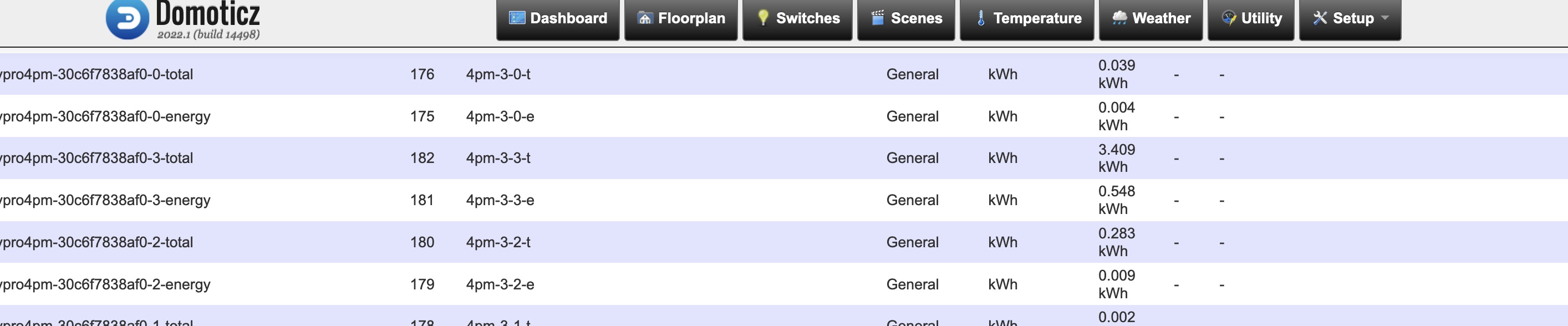

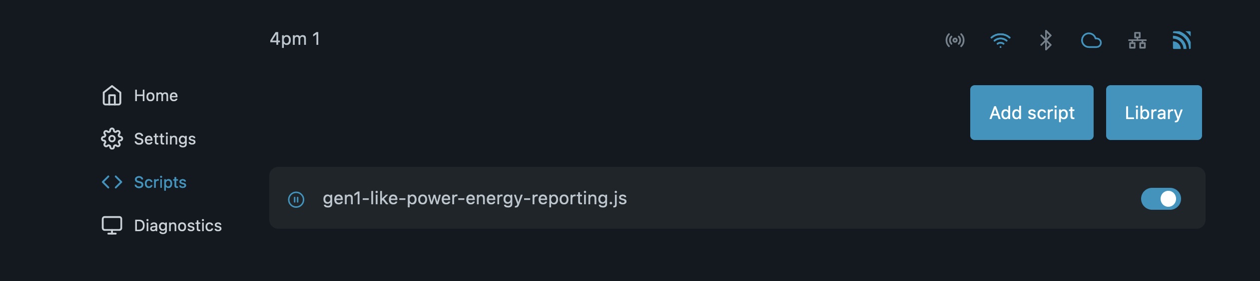

two days ago I deployed bunch of Pro 4PM to my place. I'm using Shelly-MQTT since --- basically since I deployed Domoticz and with some smallish fixes to deal properly with power&energy on Gen1 devices, it served me ever since (zero maintenance most importantly),
after spending few minutes with the physical installation, I then spent MANY hours looking for optiions here, which none of them seem to provide a way moving ahead without some struggles. and as I like things which just work (specially if already deployed), I finally approached the problem from the other side.
it seems those Gen2 boxes took the term "open system" to completely different level with the JS-like scriptings and in few minutes I made the boxes understand how to speak Gen1 language (relay providing power/energy/total data). I won't be controlling them - so now just the power/energy (and total) sensor is exposed. Anyhow, as the code-pluggable architecture is SO EASY to write and use, I will add the switching control too. Voltage & current sensors are also no brainer ... and that's it for the 4PM box.
If anyone still looking for a way to integrate Gen2 device with PM with no other changes into existing setup like I was, here goes the extention. Installation is easy, just use browser, go to your device, on the left "<> scripts", click add script, add the code, click save, enable the script (for auto-start on device boot - or just click the "play" icon for runtime testing it) and thats it. It uses the MQTT configuration from the device itself - specifically mqtt server address + user/pass. topic/prefix is just so it works automatically with Shelly-MQTT (using device-id as name of the device).
the announce and data msgs are managed within the script extension.
After the script is enabled and device rebooted (or script started manually) in maximum 60s seconds you will see the new devices being created (if auto-creation enabled).
As already being said, I use it with mine Pro4PM boxes, but it should work exactly the same on any Gen2 device with PM function.
script available at
https :// github com /mk01/shelly-2to1-mqtt
mk

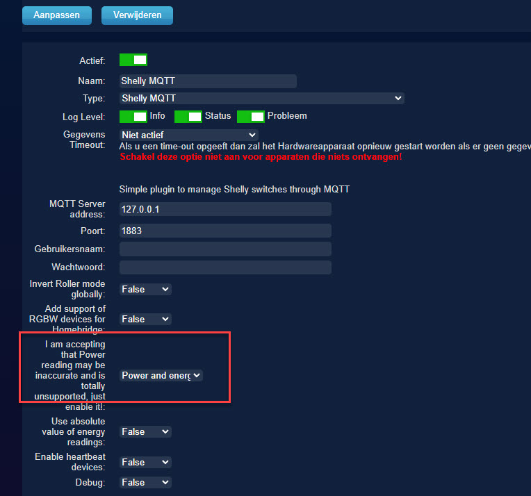

Thanks for this. I have a Shelly Plus1PM which also seems to have the gen:2 version.
I've used your code and now see a switch in Domoticz but no power readings.
In Domoticz all I see is a switch Is there info missing in the announce part?
Any help appreciated
EDIT: Oh, my....just found it....just enable Power and Energy....on the Shelly MQTT Plugin...
