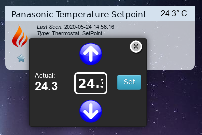

1. All sensors, received from the pcomfortcloud.py script are working correctly.
Temperature sensors under the "Temperature" tab and temperature coming in.
Thermostat setpoint under the Utility tab and setpoint temperature is coming in.
Power and Selector switches under the Switches tab and show the correct setpoint.
2. Setpoint is able to sent a set point and the action is carried out.

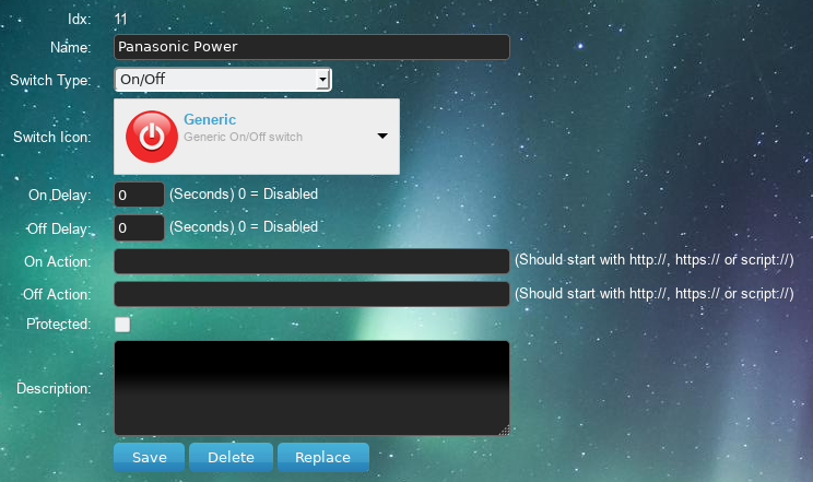

1. Power switch/button
2. Selector switches.
Ad 1.
Insert in the "On Action"the following line:
script:///usr/bin/python3 /home/gianni/panasonic/pcomfortcloud.py login pasword set 1 -p On
and
Insert in the "Off Action" the following line:
script:///usr/bin/python3 /home/gianni/panasonic/pcomfortcloud.py login pasword set 1 -p Off
Check if this functions.

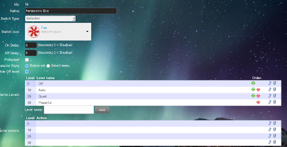

Ad 2.
This is different for every Selector Switch
Insert in the "Selector Actions" the following line:
script:///usr/bin/python3 /home/gianni/panasonic/pcomfortcloud.py login pasword set 1 -e Auto
And test all the actions.
