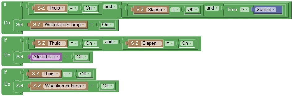

I am still playing around with the possibilities but what I have so far is the following blocky example.
There are 3 blocky events in the same example.
The first one is used to turn the living room light on if I’m home and not asleep and it is past sunset.
The second one turns all the lights off (I created a group with all the lights) if I’m home and when I go to sleep. This way the light will only turn on when it is dark and turn off when I swipe my phone over the NFC tag.
The third one simply switches off the living room light when I leave the house.
In the winter when I wake up before sunrise this way the living room light turns on when I am awake but turns off when I leave the house.
Even if you do not want any lights turned on or off you can still use the Wi-Fi / Dummy switch method to let your Domoticz know when you are home.
