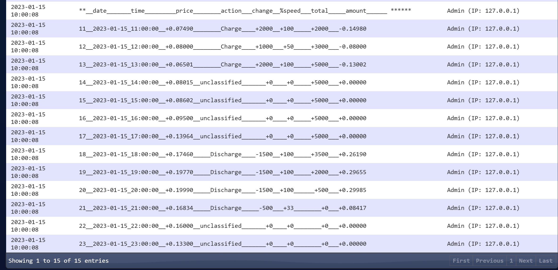

Is it possible to switch font in Domoticz?
I want to display a table with values and words in the logfile of a text sensor, but since the current font is proportional (i.e. not every letter the same width) this is impossible to get perfect.

What I did now is replace the "Arial, Helvetica, sans-serif" font lines in style.css in the www/css folder by "monospace". This works but seems to be a bit drastic since it changes the fonts everywhere.
And I needed to replace all spaces by underscores since the json update of the text sensor apparently removes any duplicates spaces.

Example below in monospace font and with spaces replaced by underscore. This is the output of my battery planning program posted earlier.
