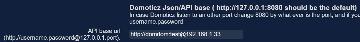

I restored the Beta and updated it to the latest one (build 14958), but it made things even worse! If the Zigate auth data is inserted like always:
Screenshot - 1_13_2023 , 9_36_49 PM.png (26.64 KiB) Viewed 2614 times
Errors appear to the logs:
Error: Zigate: Urlopen to http://192.168.1.33/json.htm?username=domdom&password=test&type=devices&rid=1176 rejected. Error: HTTP Error 401: Unauthorized
So, without Local Network, Domoticz doesn't allow the Zigate module to authenticate! And do you notice: in the logs "user:pwd" have been passed after the json.htm? ! It must be a new bug in the Domoticz code. Of course, the switches too don't work like they didn't before.
The problem is that I need users with limits to access Domoticz, thats why I can't assign the Local Network.
Any other thoughts?

[mention]glory50 [/mention] , you need to set ‘Allow basic-auth over HTTP’ as [mention]waltervl [/mention] already mentioned. Otherwise basic-auth is only accepted over HTTPS.
Domoticz does NOT accept User/Pass as URL parameters anymore. It only accepts a proper Basic Auth Authorization header.
Testing with a regular browser can be misleading as most browser remove the ‘username:password@‘ part before sending the request as it is considered insecure. You can use a tool like Postman or commandline like curl for testing.
Is it the Zigate module that generates these requests? It looks like it does not generate a good Basic-Auth request.

I think it is better you make a GitHub issue on the zigbeeforDomoticz/zigate repository. It seems that the plugin makes a domoticz api call with user/pwd that is not supported anymore by latest beta.
Posts: 6683
Domoticz version: 2025.1
Re: API/JSON auth doesn't work without Local Networks
It seems that the ZigbeeforDomoticz plugin in Dev has been updated to use the new API way of working https://github.com/zigbeefordomoticz/Do ... /pull/1429
So perhaps change to the dev branch of the plugin.
