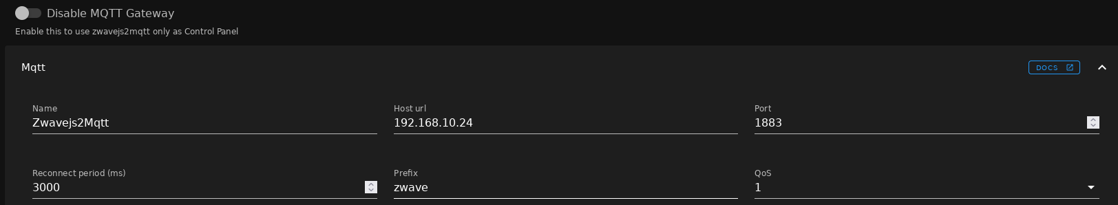

See the screenshot:
Is your Host URL correct? Is the port correct?
If so you should see the topic name, that you inserted under prefix.
And you did not disable MQTT Gateway?
Check this first.

Next check is to check the ZwaveJS2Mqtt settings.
See the screenshot:
Check this first.
